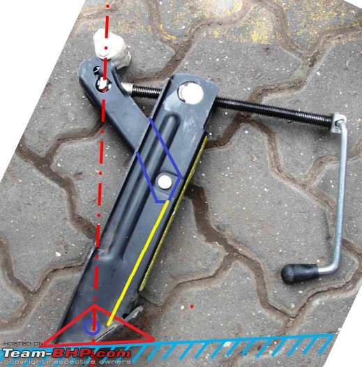

BTW, Jack base rounded? (or curved?)
I've seen a quite range of Cantilever jacks but none with this kind of curved base. Normally the base will be pivoted, refer the below picture
The yellow line is a link rod connecting the jack arm and the base to adjust the jack such that the load falls exactly on the base to what ever height the jack is lifted. But with a curved base there is a big question of stability.
PS: For some countries Jack is a safety critical item and should involve 8 bench tests ans 6 vehicle tests where the stability of jack is tested under all possible worst cases.

Originally Posted by Mr.Boss View Post
A costly mistake!!!
This jack stands on its toes as the vehicle is raised. I mean like we stand on toes to raise our height by a few inches. Its rather difficult for us to balance for a long time in that position. Cant comment about the stability of this jack.
The jack that you suggest or a conventional scissor jack will accomodate some imperfection in application. This jack though will never forgive you for an incorrect usage.

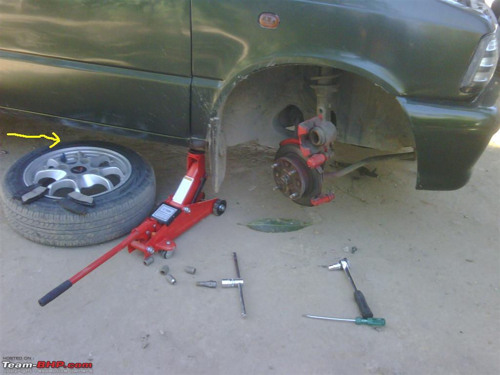

Jack like any mechanical device can fail. It also depends upon the usage. If handbrakes were used, a stone or brick is used on tyres as stopper. If the car was in low gear.
I have a habit of putting the spare tyre below just for safety reason, even if it comes crashing down, i can recover from it easily.
