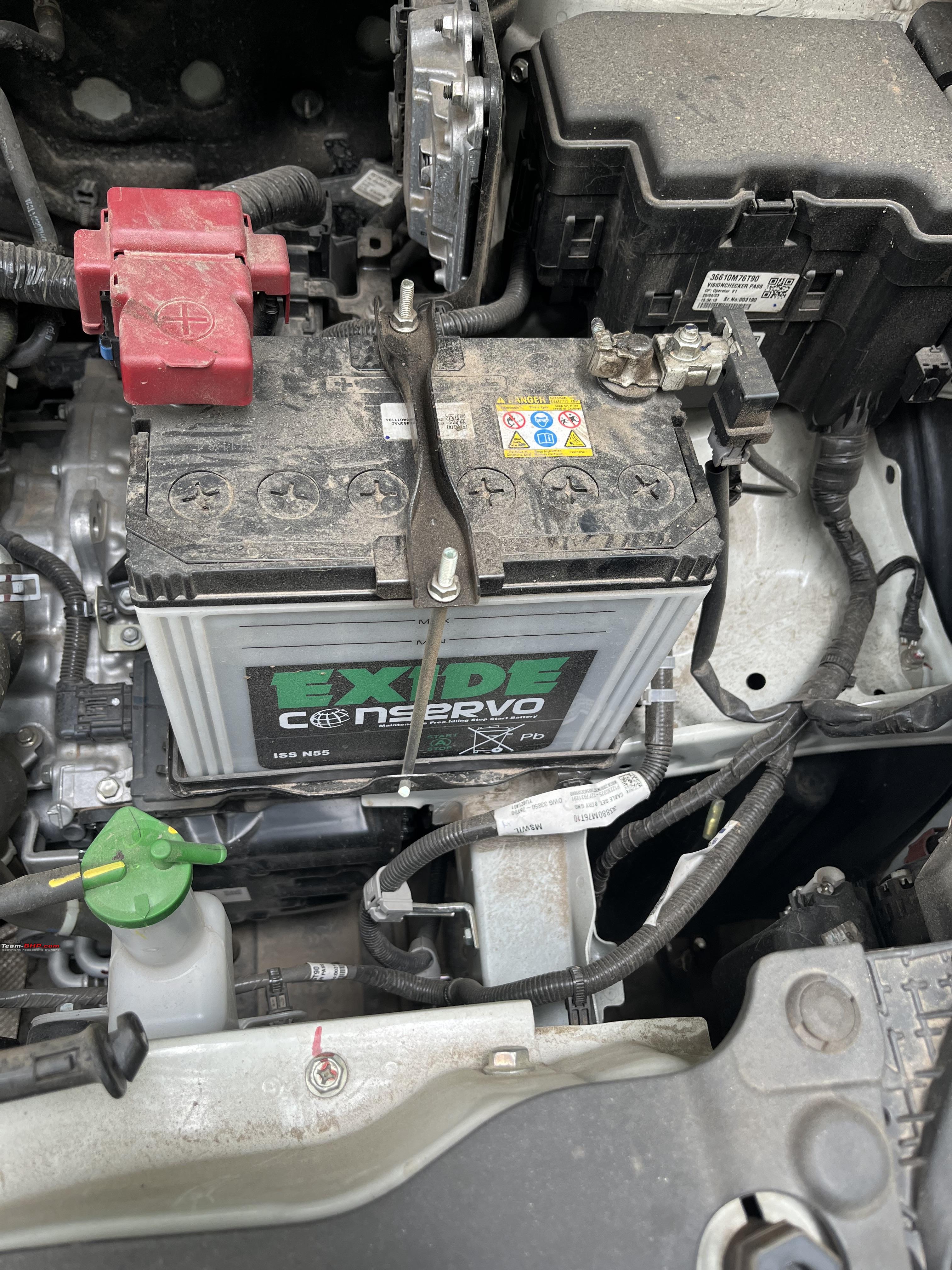

I have a 2023 grand Vitara and am facing the same issue of click reset. Took pictures of batterie area. Can someone advise if any thing is missing from the nut marked in blue. It was under the red cover. Thanks.
Considering there is full dust around that bolt (not a nut) I think there was nothing there to begin with. May be a high end/trim may have an additional wire from there or the manufacturer may have given it for adding accessories in the future.
Can you compare with a similar trim/car in a showroom?
