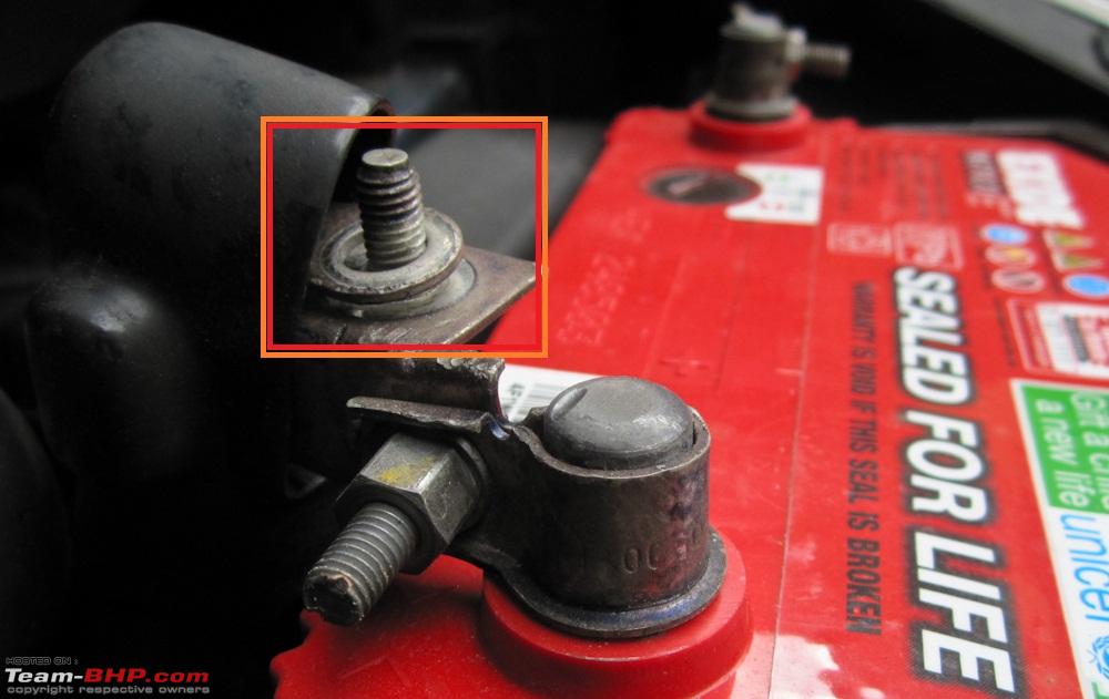

1) Sometimes, when I turn on the ignition, none of the lights appear on the dashboard or the stereo with complete electrical 'blackout'. I turn off the ignition and turn on again, everything seems to work fine. But the time on the stereo (OEM one) is reset and all radio settings are gone.
There is a similar issue (most probably related). The unlock / lock fails sometimes. The previous owner has installed Hyundai OEM central locks. If unlock fails, I have to manually unlock it. No alarming this time. I turn on and turn off the ignition couple of times and everything starts working. But stereo is reset. This evening, even lock didn't work. Same thing again. Turned on/off the ignition couple of times and everything works.
All of the above does not happen all the times. Lets say it happens around 10% of the times.

Check your battery leads, condition of the battery & earth connection from engine to body.

Central locking and radio settings being reset tend to point to the battery being disconnected. Do check this out.
Also, i hope the wiring has not been chewed upon by rats.
Actually they changed the battery before they gave the car to me. Looked like they messed up something. Will have them check it.

Hello All,
Issue resolved! Did not have to go to Hyundai. Just opened the bonnet myself and found out. I'm really furious at Advaith Hyundai. They are so irresponsible.
Attaching the pic:
Couldn't even imagine that a dealer so big could do such a blunder.

Good dude, a DIY always helps. Though this is mean of a Dealer to have missed this. Nice that you saved your time & petrol.

Yes, today I drove the car for quite a bit. Am not seeing the issue anymore.
