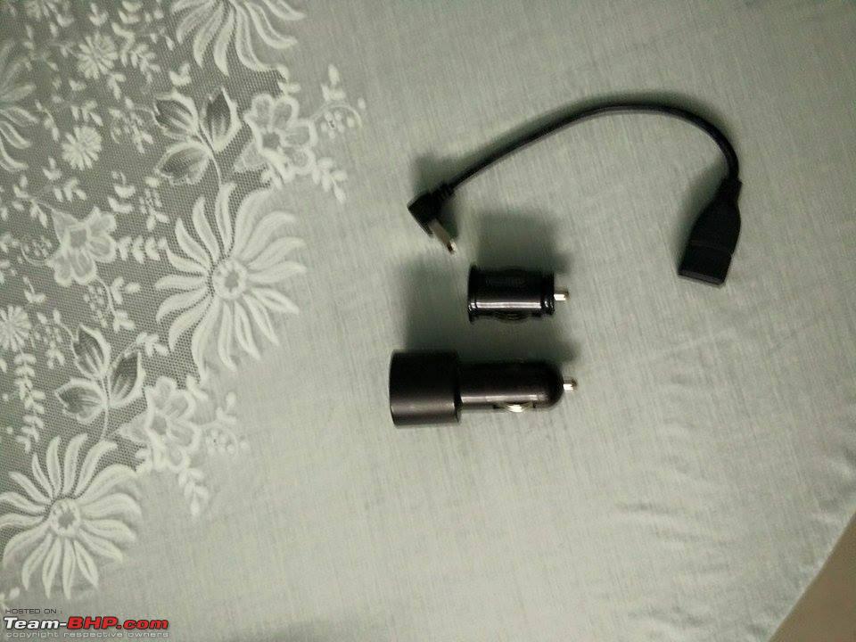

The USB slot on the XUV is badly designed and a big irritant. The flap that covers the slot for the USB and the adapter can\'t be shut when either of these ports are used. There have been many creative solutions. Here\'s one that\'s worked for me. I\'ll let the pictures do the talking.
Compared to the a regular sized adapter
An elbow cable with a bent male and female outlet
The basic adapter is just a stub. Less than half the size of a regular adapter
Adapter assembled with the elbow USB cable
The assembly in the plugged in condition. You can also see that another elbow cable is used to plug in a regular sized USB dongle.
The flap, finally closed, while the ports are in use.
The adapter is available on ebay.in. Search for Griffin 2 Amp Dual USB.
The elbow cables are available on aliexpress.com. Search for 90 degree elbow USB
