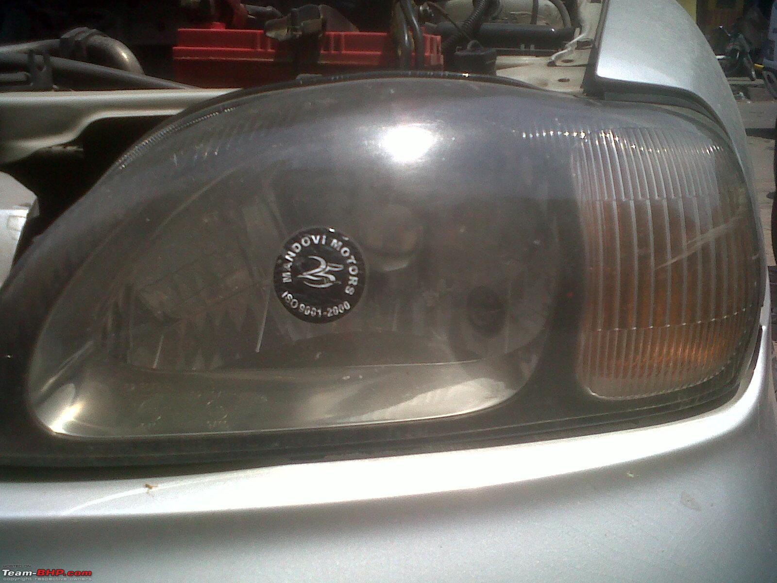

Hi All,
I had the same problem in my Baleno with a darkish black headlights and the performance was so pathetic with those headlights.
I went to the guy mentioned by the OP at JC Road, 3rd Cross and cleaned my headlamps. I must say that my headlamps are quite as good as new except for some hair-line cracks on the lens which he had informed in advance that it wont be removed with the treatment.
I have taken pics before being cleaned and am attaching them. I will post the cleaned headlights after taking some photos. Quality is low as it was taken in hurry using my BB vga camera.
not sure how to size them and hence uploaded as it is.
The shop is by the name of Western Motors, only problem i faced is that he took almost 4 hours to get the work completed.
Additionally, i had a winder problem on my RightHand RearWindow which was due to a cable being cut partially and the strands getting stuck in the cable system. The same guy arranged for two guys to come to his shop and get the cabling changed for me and he charged for 1200 for the window winder changes.
Prashant Divakaran
