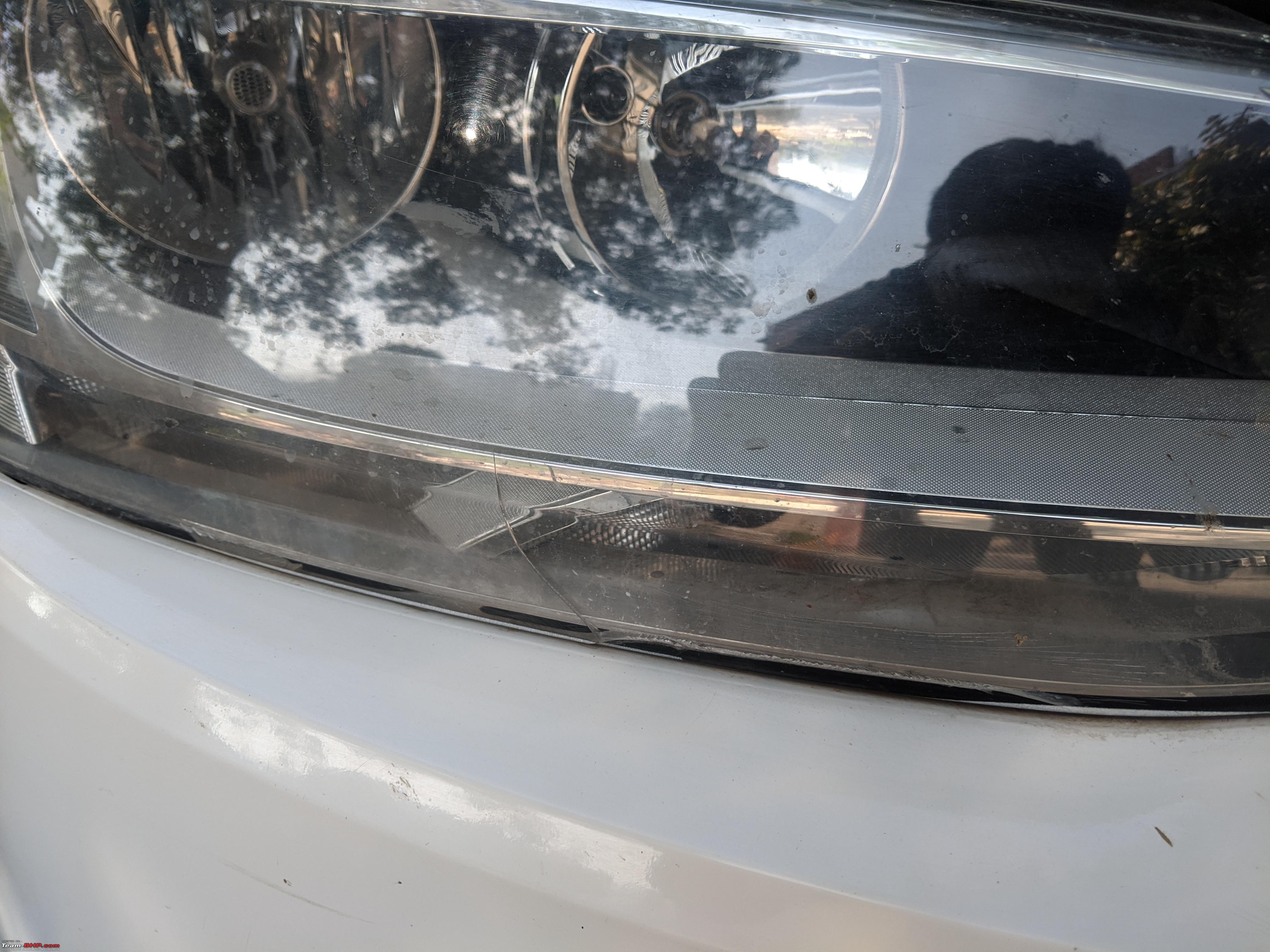

Guys I need some suggestions as well for the headlight cleaning/repairing
I have a Jetta whose right side headlight has a small crack via which dust and sand is getting inside. A new light costs 12k and I don't want to go for it and neither for the insurance as I will lose the NCB.
Could a crack be sealed? I know it can be cleaned but not sure whether the Araldite etc. would hold on the crack.
Any suggestions? Thank you.
