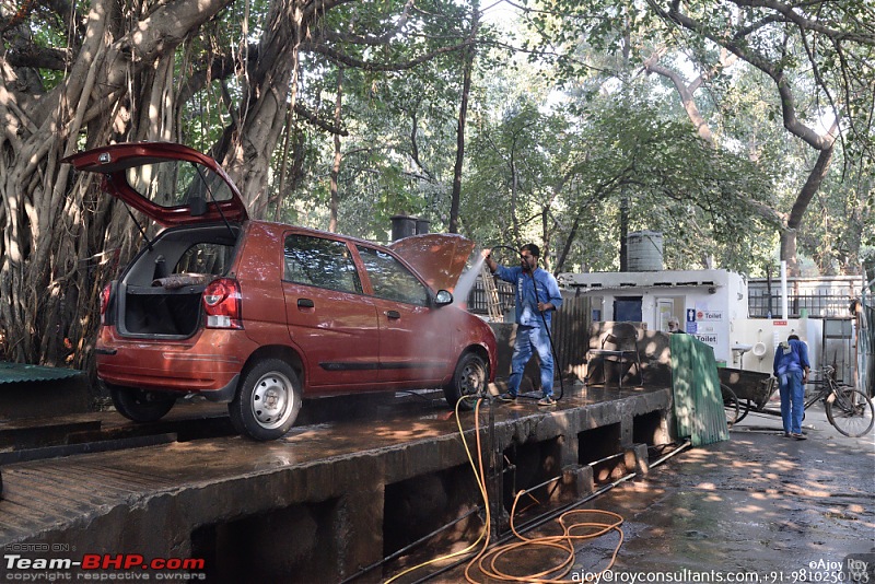

Well in my case the Maruti Service Station always pressure washes the engine bay
Coming to think about it, modern petrol car engine bays are pretty water resistant and water splashes are accounted for in the design. With Diesel cars it may be dangerous as any water intake will ruin the engine
Regarding Alternator, Battery and the Fuse Boxes, they are quite water resistant, else you will not be able to navigate through shallow floods.
