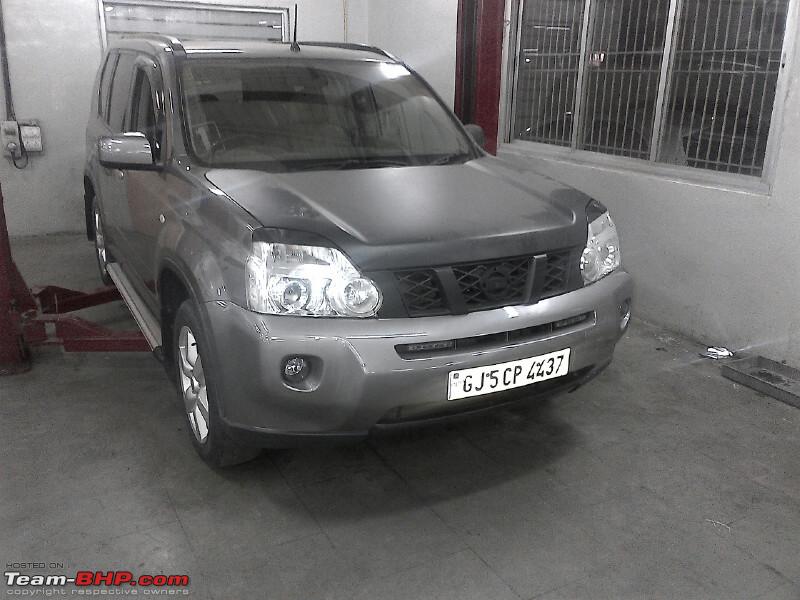

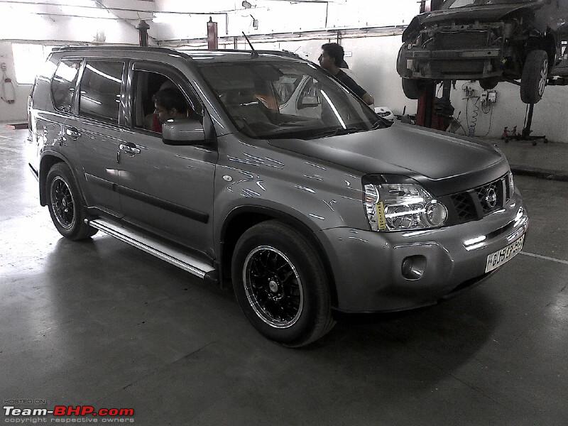

After DPF and CAT replacement I used car for a month but was not fully satisfied.
Dealership diagnosis was pointing towards some issues with some sensors.
As reported earlier it was same problem of vibrations at low rpm.
Now they have changed all wiring, sensors, also cleaned injectors and turbo.
As a goodwill gesture they are giving a colour coat, dent removal and interior cleaning etc.
I am about to get back my beloved car today Nissan Xtrail issues-img2013020700106.jpg

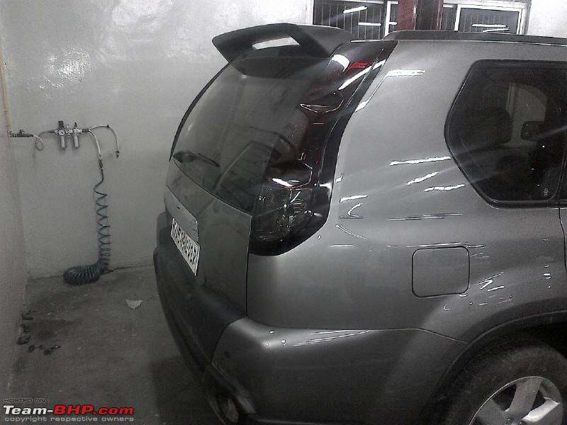

Why did you go for the matt black coating? IMO, the previous one was better, the OEM bonnet + Nissan sticker.
Looks like you have a very good dealer. Wish the rest of the dealers were like this too, that would have taken the brand to a whole new level!
How about this look ???
Its not dealer but Nissan paid these expenses...
