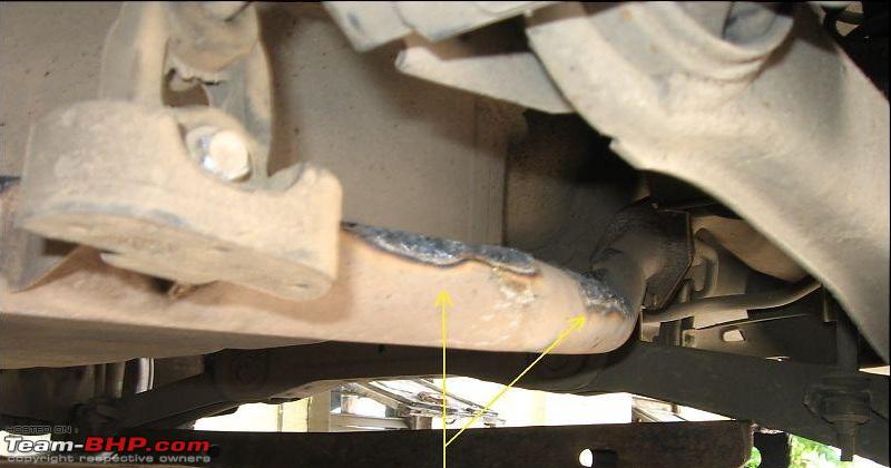

I have 2001 Lancer petrol model in stock form and superb condition. Recently, while reversing, a pile of stones hit the bottom and damaged the mid section of the exhaust pipe. Since then the car purrs like a race car and grabs attention (something to die for?? ... not me!)
The a.s.s inspected and suggested a replacement costing 8K. They pointed out that it was already welded earlier at two places and another weld job would not hold for long.
This is the full view of the mid-section (picture sourced from the web)
I was told that this part is OE Mitsubishi and out of stock; awaiting fresh supplies from HM and I am in queue since past 2 months with no conformed ETA.
Is it important that I replace it with OE part only? What if I replace it with some aftermarket compatible brand? and what are my best resources to find it outside the a.s.s? In Pune or Mumbai?

According to me its not mandate that you go with the OEM part from a.s.s for an exhaust pipe for lancer instead consider replacing it outside. More over you will in queue for ages as the parts for lancer is just so scarce for a.s.s.! For all we know they might also sourcing it from third party :)
I replaced my stock exhaust pipe for my lancer from a workshop in Bangalore and it costed me around 2k for the replacement (abt an year back) and its absolutely fine, i don't notice any difference in notice or in the setup.
