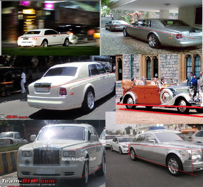

Why do Rolls Royces "lean back"?
I cannot tell if it is the design at the coach line.
The ride height definitely seems to be lower at the back. And I have seen Phantoms in motion so it's not just the picture effect or the angle of the camera .
I'm guessing the rear suspension must be very soft for comfort(obviously), therefore, perhaps when it's loaded the rear drops a bit?
Or is it a Rolls Royce thing that is part of their design philosophy? Or could it just be an illusion?

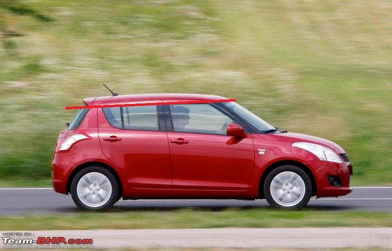

I'm not claiming that I know the reason but here's my assumption- it's to liberate more window area while still retaining aerodynamics. Take Swift for example-
1. Suzuki Swift

2. Roof slants towards rear to help in aerodynamics

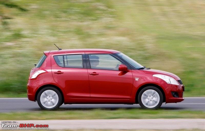

3. Door also slants upwards leading to poor window area resulting in claustrophobic feel in rear seats

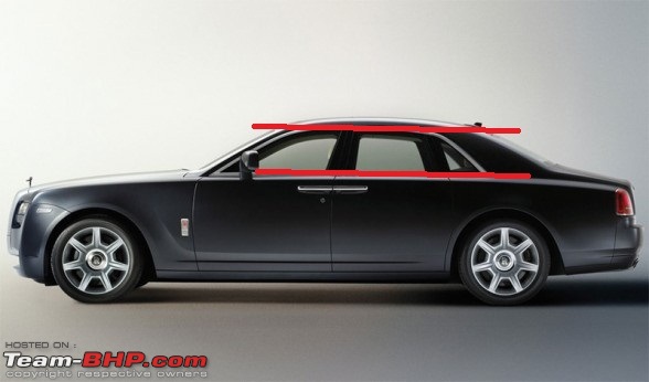

4. Rolls Royce Phantom has both roof and doors slanting to rear to help in aerodynamics and still avoid small windows

Rolls Royce cars do not lean towards the back. This is because all Rolls Royce cars have self-levelling rear suspension systems. This means that regardless of the load, the same level would be maintained.
They originally had self levelling at the front too, but that was discontinued.
The picture only appears to show that it is slanting towards the rear, but in actual fact it is level to the ground.
