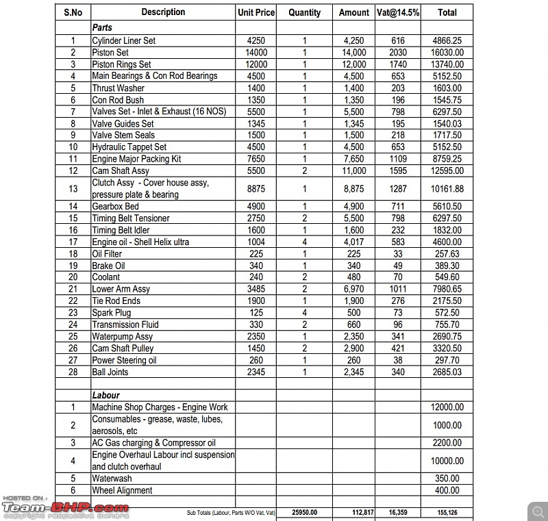

Just a few days ago I got the engine and front suspension overhaul done for my Optra.
Here's the bill amount quoted by the FNG. Does the price seem a bit too high?
I could really use your expert comments and suggestions on this.
Can someone take a look at this, and let me know if all the parts seem relevant, along with the pricing?
I am attaching a screenshot of the bill amount.
Any help and pointers in this regard will be greatly appreciated.
Thanks for looking into this request of mine, fellas.
Cheers!

IMHO, the overall cost looks okay but the question is, why did you need an engine overhaul? what was the ODO reading, and what were the symptoms/problems (power loss, etc.) which lead to this? is your Optra a petrol one or the diesel mill? knowing about the background of all this would make it easier to comment.
Since when did FNGs start charging VAT separately?
22k for engine lathe work (12k) plus engine assembly & suspension repair labour charges (10k)? And then another 1000 bucks for consumables? Wow! You're lucky he didn't add on service tax @12.5%.
Almost 30k for a set of pistons and rings? Wow again. More like ouch. What brand of pistons?
A thrust washer at 1600 bucks!
Transmission fluid? You have an automatic? Or is it gear oil?
Frankly, I have seen imports similarly repaired for less. If this was from your FNG, what would the authorized service centre charge?

You can always check against manufacturers list prices, and labour charges (which should be based on hourly rates).
The Optra is not a very common car, so a definitive comment might be long in coming.
On the face of it, seems OK for a major overhaul. Machine shop charges:- depends on what was done. Question then is why the overhaul? Were all parts actually changed? Why were the cams changed? (Is it recommended in the Service Manual?). Also con rods/ bolts not changed. (Once again you have to check the service manual)
In todays economics, it does not pay to do a major overhaul, esp in a car with low residual value. Exchange it for a new car.

Is this the Optra 1.8 petrol or the Optra 1.6 petrol ?
Here are prices of some parts for the Optra 1.6 petrol :
Clutch and pressure plate: Rs.4217/- (does not include the clutch release bearing)
Oil Filter: Rs.78/-
Spark Plug (entire set): Rs. 276/-
Suspension lower arm: Rs.3970/-
Assuming that these prices are before tax, it looks like you have a big difference except for the suspension lower arm.
VeyronSuperSprt is offline   (2) Thanks

There was a hydraulic tappet issue which made the engine too noisy during operation. Sounded almost like a diesel!
Plus, there was an engine bearing issue which resulted in the Engine Oil pressure light coming on at low RPM.
Plus, the car was 8 years old and had done a whole lotta miles.
The previous owner had put mostly spurious parts in it, which meant that the car was in a real bad shape.
What you report does not appear to require pistons + rings + liners replacement. 100k is NOT a 'whole lotta miles', contrary to your perception.

Sorry if I sound a little mean, but why on earth would one NOT bargain with an FNG? Especially when his prices seem to be very high?
And if the FNG has indeed procured spares from GM, VAT would have been included in the price ONLY IF a proper bill was taken - and they should be able to show it to you. The FNG cannot charge you VAT all over again.

2. Labor charges: Seems a bit too much. So shall I haggle? Does it make sense to haggle on it?
Do let me know your thoughts fellas. Thanks again. This community is just awesome!
Cheers!
First of all, do not go to a FNG if you do not have a friend who has been servicing his\her car there for years or vouch for it, when the work is complicated and costs a bomb.
Anyways you cannot undo that now, is he a trust able guy ? what does your instinct say ? The amount quoted has to be for sure haggled. Do not give in. Take a friend who knows a thing or two about cars to argue along with you or even if you dont have one, take a guy and make him pretend so.
Ask the mechanic for all the bills, original. say Chevy authorized service centre quotes a much lower price, negotiate saying how could you recommend your friends when the cost is so high when compared to the A$$.
Take this bill and compare the prices with A$$, if needed take along a mechanic with you and pay him a couple of hundreds to haggle along side.
In chennai, we could fix a totaled ACCENT CRDi from an accident within 70K. should not cost you anything more than 1 lac whatsoever.
I think i have given some heads up, be as creative as you can and break the mechanic's bill by close to -30% and then start bargaining, so that he would know that you wont budge for anything more than 1.2 lacs
All the Best,
Chaos

Machine shop charges & on top labour charges for engine overhaul ! I think 10K has been 'pocketed' by the FNG on this particular job. As always, haggle more on labour than the parts. Discount the VAT amount 16K also. So, start your initial bid at about 90K & don't go more than 120-125K.
Also, as others have pointed out, 90% of the times, one doesn't NEED an overhaul at 100K. It is just that we lose confidence in the machine & workshops are reluctant to trace the minor issues faced. Once they see its high mileage, they immediately settle for overhaul to set 'everything' right.
Overhauling is more of a Brute force approach to solving complicated engine problems.More often than not, the actual remedy costs only a fraction of the overhaul cost.
Did you have a word with Chevy A.S.S regarding this? Does chevy sell Half-engine assys.?

1 Lac is not time for a major engine overhaul. A hydraulic tappet can collapse, causing quite a racket. Normal remedy is to change just that, and check out the oil lines/ pressure.
What does that mean; engine work done earlier too?
Why separate charges for piston and Piston Rings. Usually pistons comes with rings.
Further all engine components are getting replaced and get proper justification for the same.

This bill amount could fetch you another optra and exchange spares with it. This is outrageous, why oh why would you want to buy a car like this and then get it repaired ? Even if it came for free. They did not spare you the water wash (Rs.350) either.
