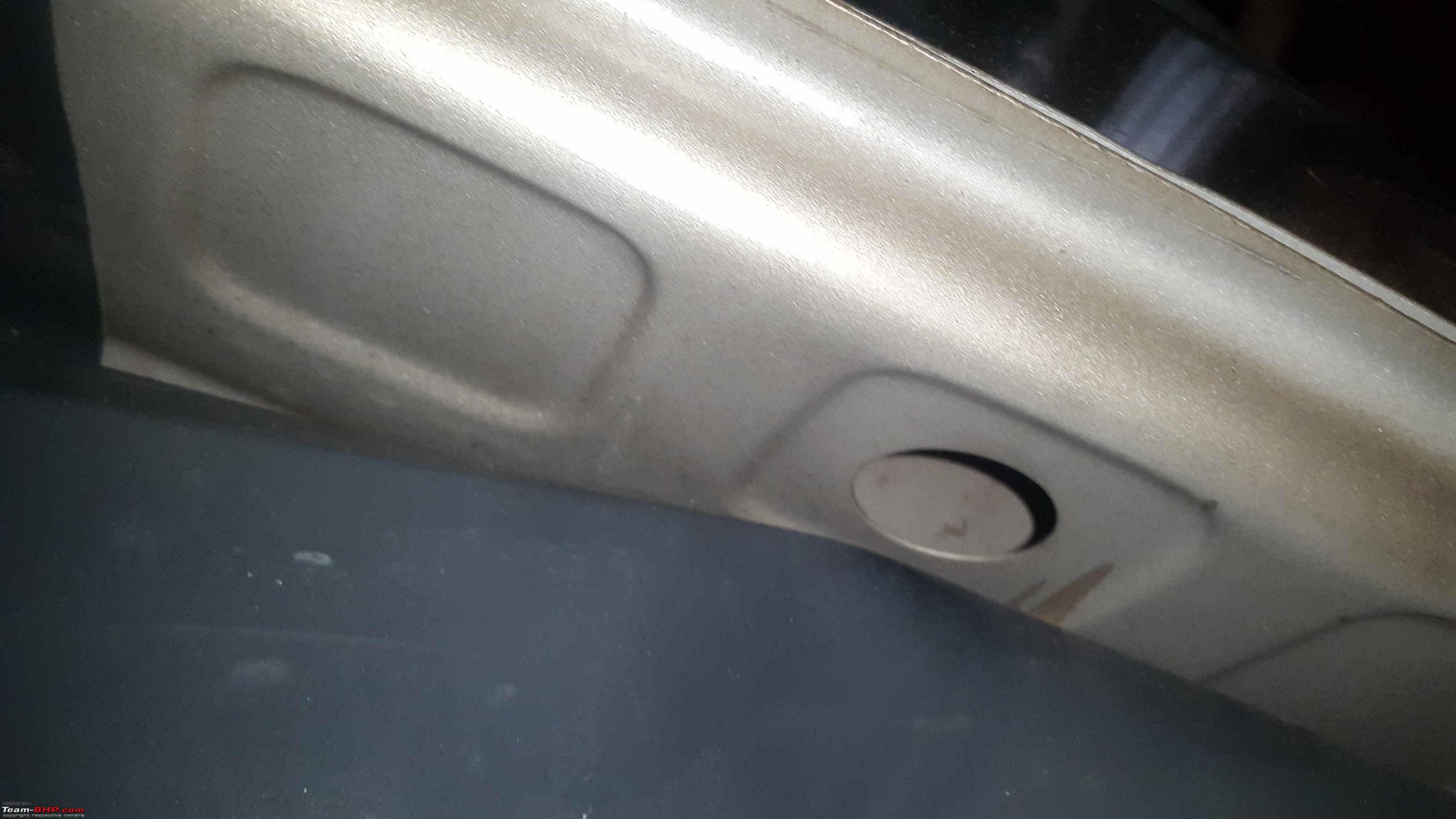

Need a few suggestions from fellow BHPians.
My objective-
Since my beloved 800 is now almost 16 years old, I am beginning to be a bit on the defensive side as far as rusting is concerned. Till date, there isn't any rusting and surface rust on places like crossmember etc, if any, is dealt severely with sanding, followed by primer, paint and antirust. I would like to be safe from rust, as it is a like a cancer once if affects metal.
In most cars, running board corrosion is one of the main cause of worries. I inspected my running board from small holes and found it to be intact, with a layer of dust only.
I initially planned to get access to that region from inside by removing the interior trims, and clean it, but the holes are too small to pass even a paint brush. So thought of pouring used engine oil so that moisture doesn't come in contact with metal. But one of my friends suggested me to spray Zorrik88 generously inside. I liked his idea, still thought of confirming once with you BHPians!!
My concern-
1. Will Zorrik88 cause any damage to the primer inside??
2. Will it stay long enough to serve my purpose, or is it volatile?? Even if it lasts a year, I'm fine.
Kindly point out any negatives to my idea, and/or better suggestions for the same.
The hole through which the insides of running board is accesible.

WD40/Zorrick are not for rust prevention. They are for cleaning surface rust etc., For protection use engine oil or any industrial oil

Adding on to what tsk1979 said:
1. I don't believe WD40/Zorrik88 will cause any paint/primer damage, as it is used on joints, etc. that are painted and greased.
2. However, it won't last at all - WD40/Zorrik88 all have very volatile compounds meant to dry up and lift off moisture. Same reason why they advise us not to use it near a flame.
3. 3M offer a cavity protection option called 'Internal Panel Protection'. They inject a foam-like substance into these sort of panels (rocker panel, door, etc.) which coats the metal and prevents moisture reaching the metal. Knowing 3M, it will be a quality product with a quality price tag - so please check. I don't know of anyone who's actually opted for performing this. When I enquired in 3M Bangalore, they said that they don't stock this as there's no demand (particularly as its not a coastal area).

The other option is to use Tufkote cavity wax and rust dissolving primers.
Good alternate option for all cavity related work and issues.
* Neither am I advertising or promoting this product. I have used these products and sharing my experience for benefits of others.
Agree. i think WD40 can be a bit hygroscopic so is definitely NOT for rust prevention. Use a light oil. I prefer sewing machine oil.
