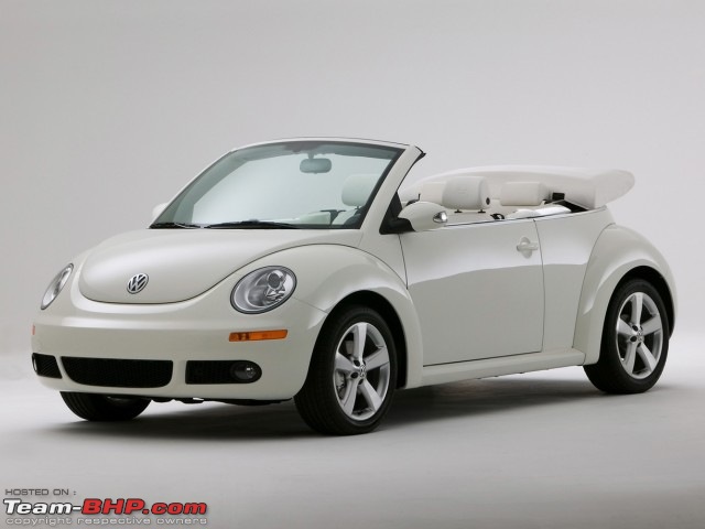

Which of the Convertible are you talking about ..?
The Original or the ???
VW Beetle Convertible : Window Regulator Issue-1974vwbeetleconvertible.jpg
VW Beetle Convertible : Window Regulator Issue-volkswagenbeetleconvertible02.jpg
The "or the" with black upholstery
I would take it to the mech, the VW shop here charges in multiples of 90$ for touching every single problem in the car.
EDIT: Here are the specs. https://www.team-bhp.com/forum/test-...nvertible.html (My Volkswagen Beetle - convertible)
