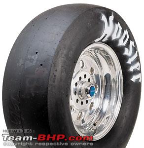

Racing slicks and bald tyres may look the same (i.e. treadless), but they are a whole world apart.
Bald road tyres have the *grippy* rubber completely worn out.
Of course, you can buy racing slicks for your road car, but they are meant to be used in bone-dry weather only (e.g. M3 CSL and its semi-slick tyres).
Example of a drag racing slick tyre (Pic Source)
