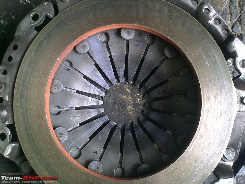

Originally Posted by A.G.The Rambler View Post
He says generally the pressure plates gets burnt, and in case of that it would not be under warranty and has to be paid by me. But then what are the friction plates? Can you please help me in understanding what components this clutch kit consists of and what all needs to changed and looked into while checking if the plates are burnt or not?
Is flywheel replacement a must, when getting a new clutch plate?-friction-plate.jpg
The picture above is that of a friction plate (aka the driven plate), and the one below is that of a pressure plate.
The diagram below shows how they fit in relation to each other.
The friction plate wears out. The fingers (radially arranged metal strips) you see on the pressure plate can harden, resulting in a hard pedal. Hard pedal is not a wear-related issue, and should be covered under warranty (if your warranty is valid).
