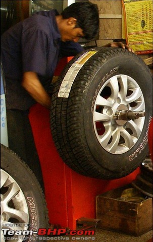

"My Car / Steering / Brake Vibrates While Driving" | What To Do-post2a_resized.jpg
1. Have the wheels balanced. Visit a bigger shop with a good dynamic wheel-balancing machine.
2. Are there any obvious lateral movements / bulges? Replace damaged tyres that have bulged. Check for "runouts" on your wheels and tyres, both radially and laterally.
