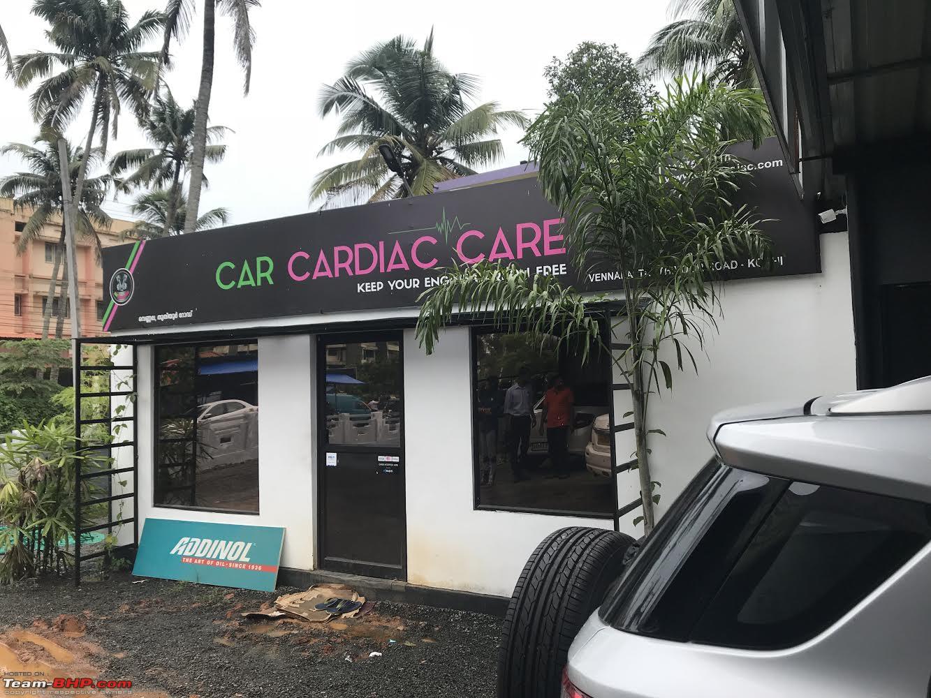

Next day morning 19th July, I drive down there drenched in rain, with my thoughts of low compression - i really started feeling my car is not breathing properly, which only made me get this decarbonation mandatory - despite the fact that my car might get an engine overhaul. I didnt have sufficient understanding or knowledge to judge when would be the right time to do it - is it before the overhaul or is it later. But I said lets get this done - probably this would be the right time to get this done.
Drove down to this "ok" place which was merely a neat garage with a couple of mechanics and two other cars around "Both belonged to the staff there", I had a warm welcome and they gave me an overview of what would happen during the next 30 mins.
