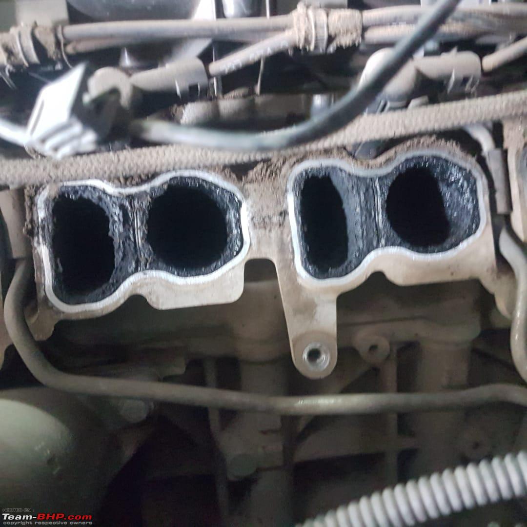

1) Been replacing oil at 9,500-10,000 kms as per conditions based servicing system of BMW.
2) As per BMW service team at infinity motors. This would be the condition of EVERY Diesel Engine in about 30,000 kms, but they don't do any carbon cleaning unless asked for or unless a problem is reported. I did report a sluggish engine performance and a faster move towards service due date.
3) In warranty under BSI no individual would carry out anything extra outside the service centre that is not standard practice. It would void the warranty. Too expensive.
4) Via my post I am conveying that Most Diesel Engines are possibly running with carbon build-up in these places and even under warranty and extended amc they are not getting attended to by any manufacturer. But should be.
5) No way to know if my hypothesis above is correct but by opening up a few.
I agree that the chemical methods described in this thread would not clean the EGR and Manifold carbon build-up. As per BMW, their fuel additives help reduce this.
Best I post the snaps here too for the convenience of readers.

Very clearly this engine needs a catch can.
I know this is an old thread but could not resist asking:
- Do you by any chance drive with a heavy foot?
- What reason has been given by the technician for such high build up of carbon?
You can put a catch can and whenever you take the car to the station you can remove the tubes unless the ECU is able to detect this pressure difference in the crank case.

Opening up the manifold and cylinder head appears to be the only option left, unless there's some other way to clean up the deposits effectively.
I would say the EGR is the reason for the extreme carbon soot buildup. One of the reason i did a remap was to close the EGR and also post that i removed the intake manifold and it was clogged by over 70percent at 88k kms.
My advise would be to get a soft remap done and close the egr and get the intake manifold and head cleaned once so that you will not face this issue again.
