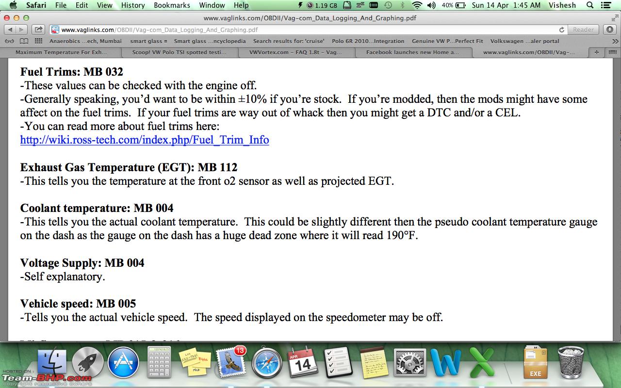

Buddy i'm a little confused here... how do you measure EGT using lambda sensor? I looked up on the G39 lambda probe, its a heated sensor how can it read EGT?
Screenshot source :- http://www.vaglinks.com/OBDII/Vag-co...d_Graphing.pdf
I referred this pdf file and assumed that the o2 sensor is used to measure the EGT. Please correct me if i am wrong. the measuring block that i use to measure the EGT in VCDS is Block 112. After referring the factory repair manual, i found out the location for the O2 sensor between turbo and cat-con.
The EGT reading in the log file is the projected EGT, its not the actual measured EGT. The EGT is calculated based on O2 sensor input and some other parameters. A further reading up on this topic i came across people in VW and Audi forums mentioning this projected EGT is not accurate for a chipped vehicle, and an EGT probe is recommended if true EGT is to be measured.
Since your car is a remapped vehicle this EGT readings may not be true at all and if your car had an EGT sensor (G235/G236) the readings will be from that sensor instead of the G39 lambda probe. I think you should get in touch with Rosstech/Tuner and ask them what they think of this reading and how its calculated and whether you should be concerned. This is the best you can do, or install an EGT probe if you are really worried about the EGT and engine health.

Projected, ie computed value. Not actually measured.
In a modified car, computed values can be totally off. Computation is done based on a mathematical model. Which is painstakingly refined and validated. Modifying the engine can throw the model wildly off.
