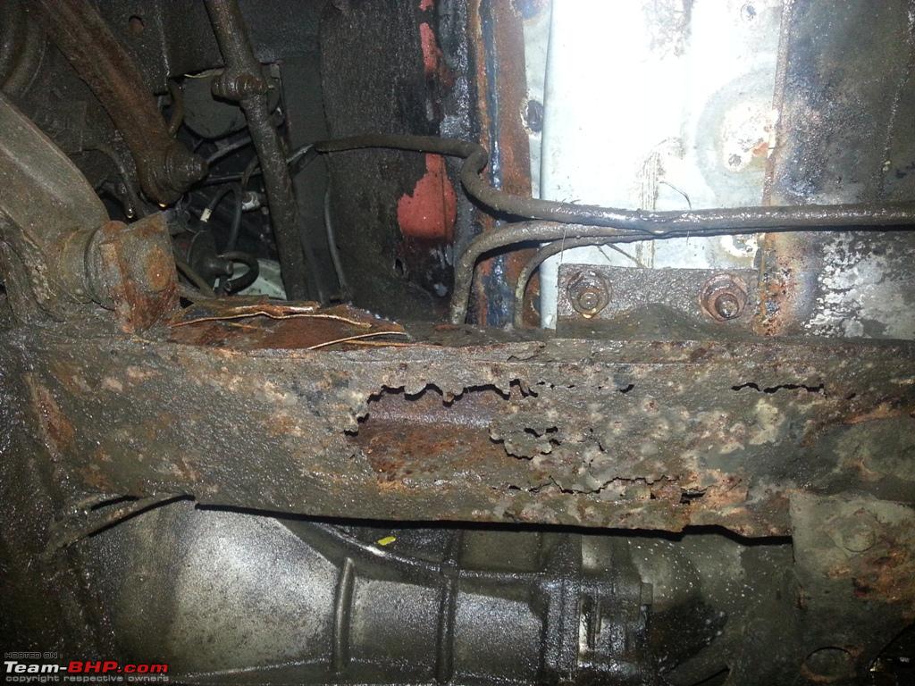

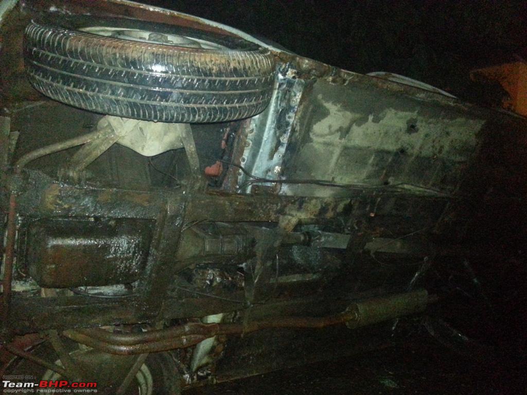

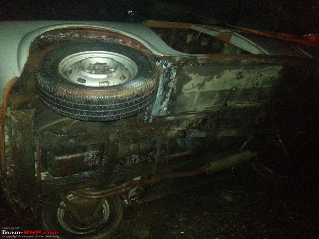

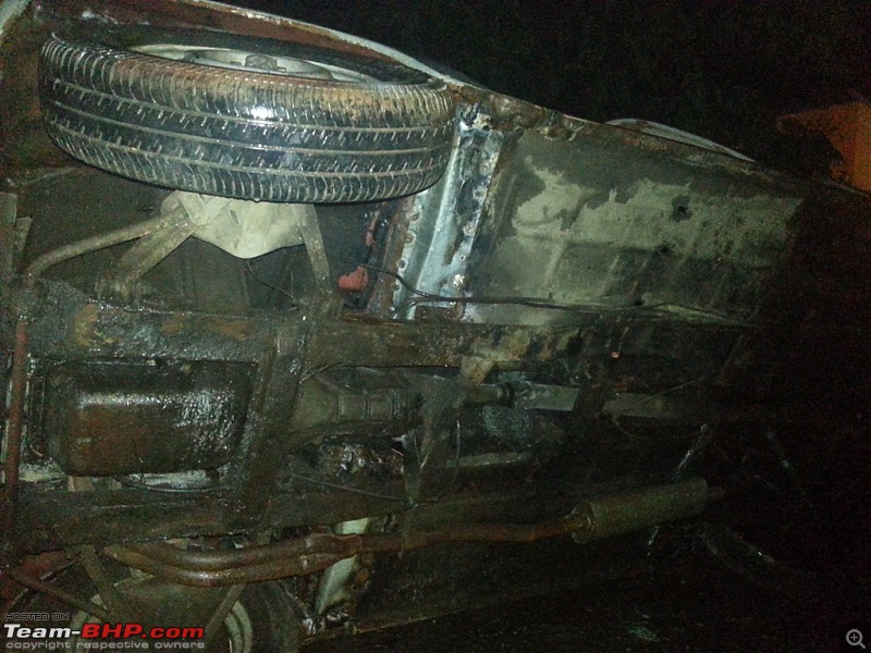

Hi
I just got back home. On the way back form work, i stopped at the garage. Obviously, no one was there.
i was greeted by my car, which had been toppled to one side.
There is some major rust on the chassis which will be repaired.
Here are the pictures,
Do pardon the quality of photographs, i had to make do with my phone flash.

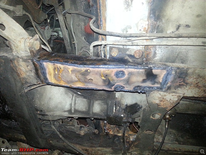

Hey!
the chassis has been repaired. My friend had a look at the weld joints and he said that it looks to be a very good weld.
Do give me your verdicts.

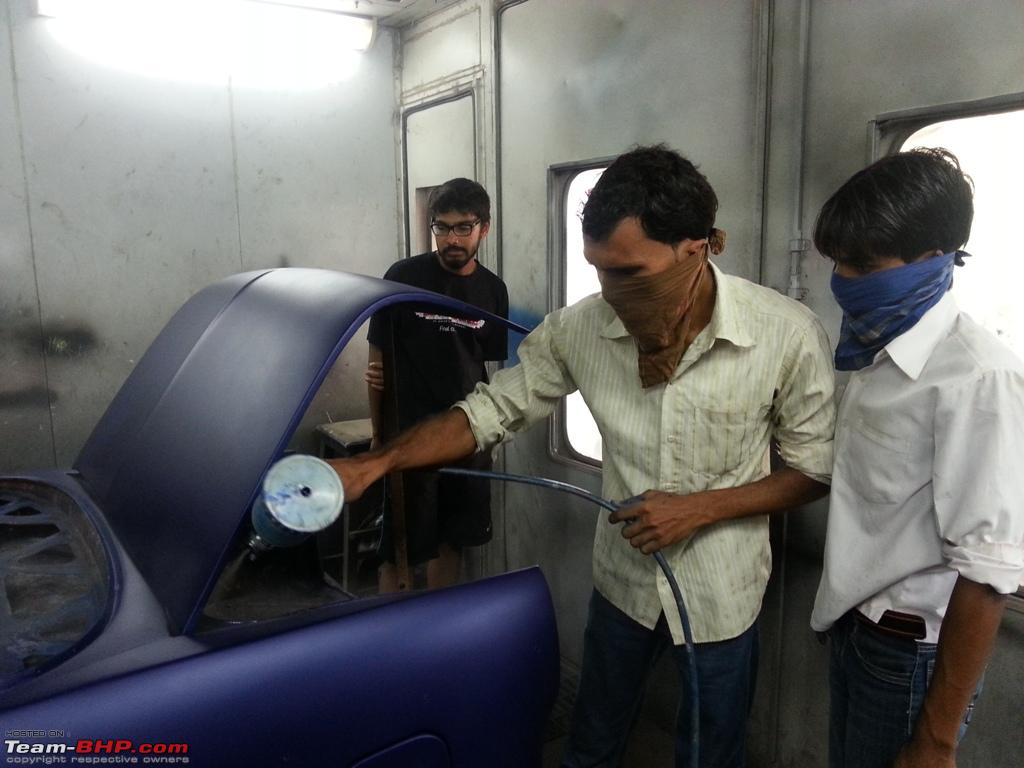

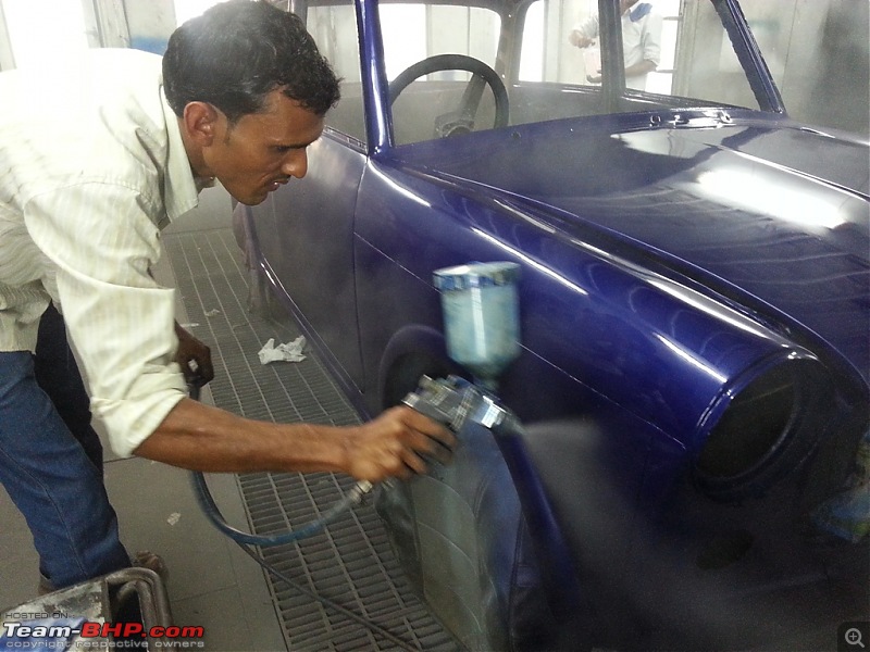

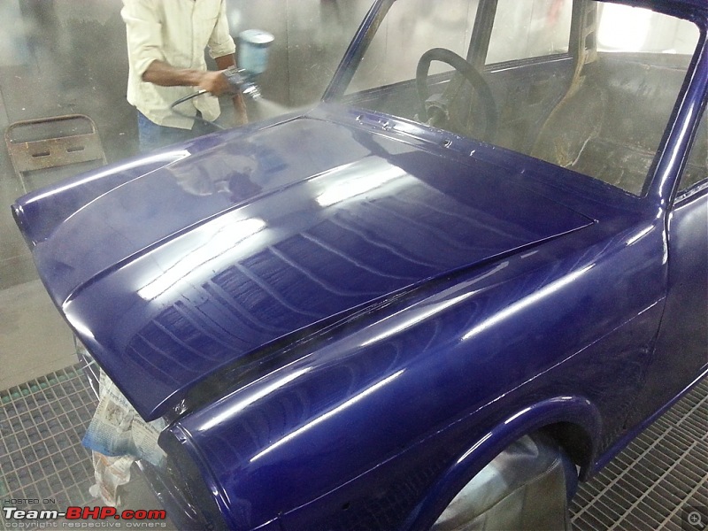

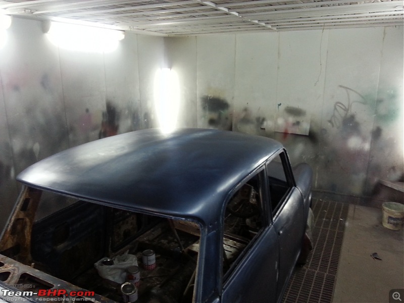

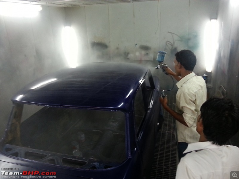

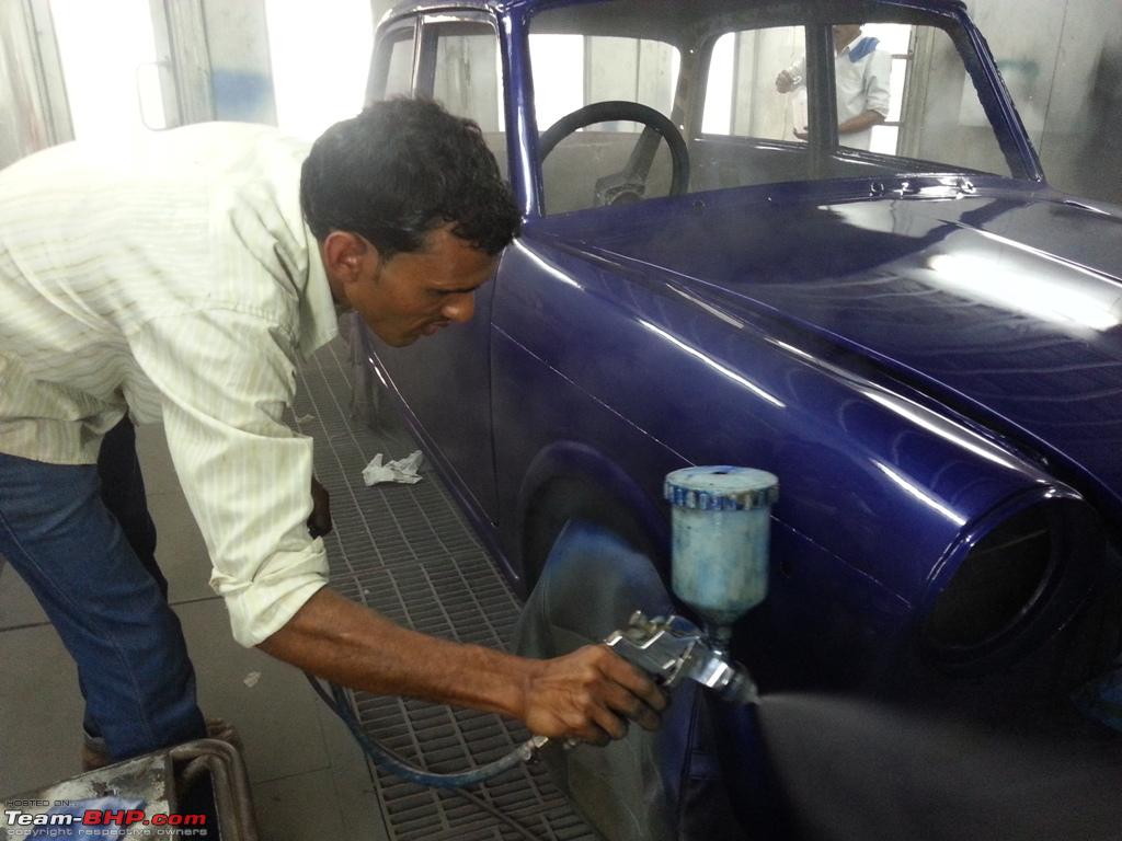

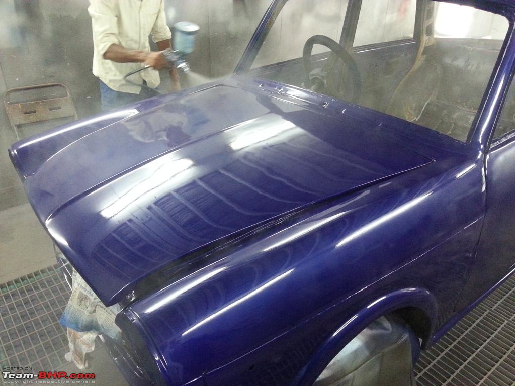

So the car was finally painted.
The weather here is horrible, so i rented out a paint booth.
I chose Estoril blue Crystal, OEM for Audi.
Paint Quality was Dupont Centari 600
Clear Coat was Mipa high solids clear.
Was painted in a sealed paint booth and baked at 65 degrees centigrade for 3 hours.
Here are the pictures.

Just my take on the color. The matte undercoat if used would have looked wicked on the car. what say guys?
Agree - Matte would have looked wicked! But, this is a classic car and IMO classic cars look great in gloss!! Just my view
