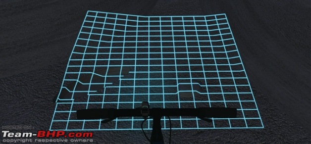

Hi,
Have a look at this really really good way of imaging road surfaces passively:
http://www.red-dot.sg/en/online-exhi...ode=732&y=2012
A great way to see potholes, unmarked road humps and much more ...
Simple Question:
Does anyone know if these lamps are available for CARS ?
It would be great to have it in our country where street lighting is mostly a non-existent affair, especially in suburbs and highways.
" Lumigrids can project a grid onto the ground. On a flat road surface, the grid will consist of standard squares. On a rough road surface, the grids will deform accordingly. By observing the motion and deformation of the grids, the rider can intuitively understand the landforms ahead. In addition, the luminous grids can make it easier for nearby pedestrians and vehicles to notice the bicycle, reducing the likelihood of collision. "
Pics below are self-explanatory.

Though the product is good, I seriously wonder how effective it would be.
Imagine the kind of concentration required to read the pattern and process is quickly to avoid hitting the pothole! Also, if the throw is going to be like what it is shown in the picture, I am sure it wouldn't be very useful. Maybe this is useful for a machine that reads these patterns and drive without any manual intervention!
I prefer a normal LED headlight any day(or night!!) that not only illuminates the road right ahead of you but also other things on the road.

Vinair, it doesn't take any amount of brain processing more than what we do using eyes to peer in the lighted up darkness (which we anyway do while driving with headlights at night and no street light).
The issue, I believe, will be that the grid is being illuminated by LED. Which means not much projection far ahead. Since car's speed is considerably higher than bicycle, you need to see the road much in advance.
This means that you will need laser illuminated grid. Perhaps that will be street illegal.
On the other hand, a normal illumination by headlights produce enough shadows, which help our brain form the height/depth of the road/objects on the road. Why would someone buy this instead?

From my layman point of view, I feel it would be of less effect in cars compared to bicycles because:
(It's just my quick opinion, even though I feel it's all correct )
1. Projection angle: In a bicycle the angle of projection of the light to the ground surface is very good. As seen in the pics, the grids are projected on to the surface from atop the handle. But in cars we can't achieve anything close to this angle even if we mount it on the roof.
2. Illumination : The illumination requirements for a bicycle is very low compared to a car. This device has to project the light grid on a comparatively dim surface. But in case of a car, the surface directly in front will be highly illuminated by the headlight, which I think, can't be avoided or replaced completely with lighting from the grids. The grids won't (normally) be visible on such a highly illuminated surface.
3. Distance of the grids being projected, from the front of the car: This could be good for assessing the surface if we are moving very slow, on a rough and unpredictable surface. But for moving any faster than 30-40 kph, I think this won't help much, because we won't get enough time to react based on the inputs. And if we try to do so, we'd end up driving in zig-zag.
4. The detailing seems too much for a four wheeler : For a bicycle, the tread is just nearly 3 inches. So if he sees a small hole on the surface or a stone or something alike, he can just avoid that with a flick of the handle. But for a four wheeler we have to consider a tread wider than 1.5m. So we can't avoid things in a flick of the steering.
5. We have a headlight : I feel a headlight can help us even more in assessing what's laying in our path than partially illuminated grid. The grid will need keen attention to find things on our way.
