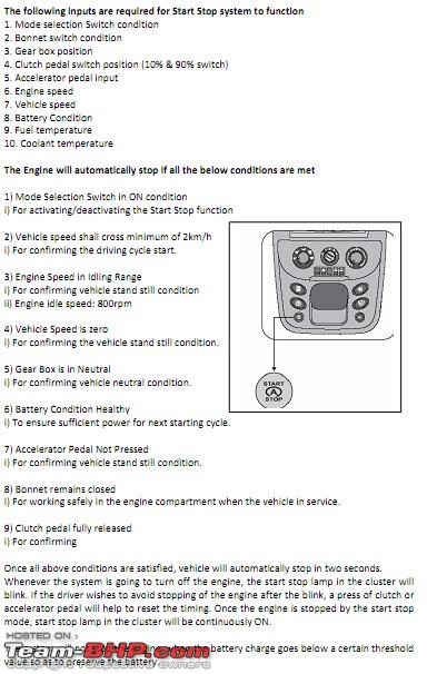

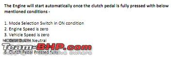

The Scorpio's Micro Hybrid system has no such motor/generator. It's also known simply as an ESS (engine start-stop) system.
Originally Posted by Sumeet_s View Post
...Micro Hybrid! I have changed the sensors and the switch plenty of times...
Koncept Motors now tells me that the Battery is not able to give the proper current to the Micro Hybrid system and hence, this is malfunctioning. Though, I have been reporting this issue in less than a years' time of purchasing this vehicle and now after 2.5+ years, they came back with this illogical story!
I am sure you've done right proper research about the MicroHybrid system in the last 2.5 years, given the frequent issues you've faced with the system. I am surprised that Koncept couldn't fix it (BTW, which workshop was this - Okhla or NOIDA?) and are now blaming battery voltage. Since you mention that all the external sensors/switches have been changed, I wonder if
  • they've checked the neutral position sensor (GNS) on the gear lever for proper adjustment / functioning;
  • there is any error code being displayed on scanning the ECM;
  • the ignition key is sticky after cranking (doesn't return to 'on' position);
  • you are using an additional floor mat, which prevents complete travel of the clutch pedal (make sure only the carpet is present between the clutch pedal and floor);
  • the alternator is charging the battery at the correct voltage.
Take a look at certain 'must-do' procedures for the Micro Hybrid system to work properly - I hope you're not missing out on anything.
