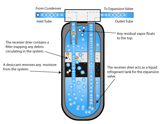

A receiver/drier is used in an Expansion Valve and Receiver/Drier type system and sits between the Condenser outlet and the Expansion valve inlet on the high pressure side.
It is a tubular shaped device that contains some desiccating (drying) agent that removes moisture from the refrigerant thus preventing the formation of hydrocholric and hydrofluoric acids - both are very corrosive. In addition it filters particles mixed in the refrigerant, and acts as a refrigerant container.
Below is a picture of a receiver-drier and a schematic of how it works:
(Picture Courtesy)
Understanding Car Air-Conditioners-receiverdrier.jpg--Name:  receiverdrier.gif

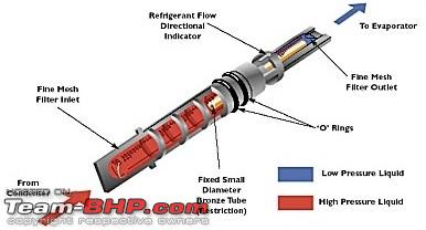

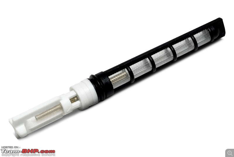

The orifice tube is used in the Orifice tube and Accumulator type system and sits between the Evaporator and Condenser. Its conical shape restricts the flow of a metred quantity of liquid refrigerant, thus reducing its pressure and it becomes a mist as it enters the Evaporator.
Also, as the orifice tube is of fixed shape and capacity, it cannot be used to control the amount of refrigerant that changed to gas inside the evaporator. Therefore in this type of system, the Accumulator is used to dry the gaseous refrigerant, and store the liquid refrigerant to prevent liquid lock or Black Death in the compressor.
Here is a picture of an orifice tube and it's schematic
Understanding Car Air-Conditioners-orificetube-photo.jpg--Understanding Car Air-Conditioners-orificetube.jpg

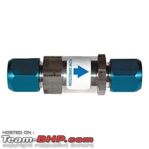

The AC inline filter is designed to trap debris circulating with the refrigerant and take it out from further circulation.
Example inline filter shown below, shapes/sizes may vary...

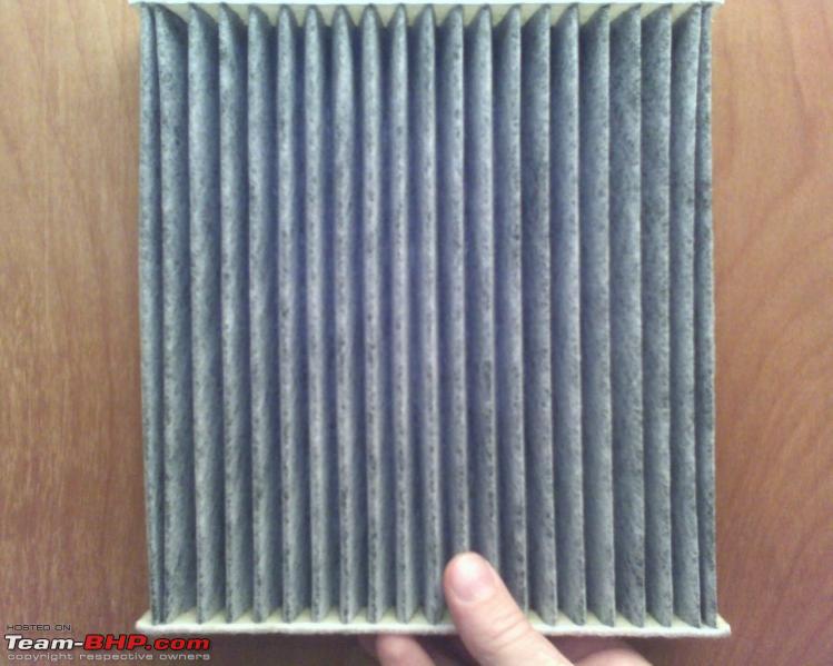

A cabin air filter is designed to trap foreign particles (and even pathogens) and prevent them from circulating within the cabin. Earlier model cars did not have this feature except in high end vehicles. Now it is almost ubiquitous.
Example of a cabin air filter.
