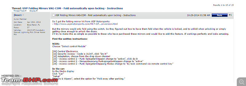

Read on one of the Russian forums that with v15.7, someone was able to get mirrors' auto folding on the Jetta and Tiguan which otherwise would require some EEPROM tinkering.
Source
Originally Posted by ajaypjayaraj (Post 3855360)
31347 works on the new Octavia CECM which is based on the MQB platform. But it is not easy to get the security access to the earlier one. Russian forum guys and the maker of cable, Ross tech guys themselves couldn't help with security access code to the earlier CECM. But I think that is because it does not really give you what you want. If that access solved a lot of problems with low level adjustments in the system, it must have been cracked already and available accross the online forums. Like MQB based CECM gives you a lot of options to play with. The earlier CECM is not based on such an architecture. It gives you much lesser control of its functions as compared to the MQB based one. Even the guys sounded like, why is that security access required, like, what good could it be of. I myself would like to get access and see what's behind it but it seems like there isn't much in there like we think.
31347 (MQB based CECM securtiy access code) is available everywhere despite of it being the latest. That is simply because, it lets you do so much. I think the earlier ones don't. And may be no one really cared to share that code even if they found out because it could be useless. I guess.
I was trying to do the following! Looks like I am desperate!! :D
VCDS (Vag-Com Diagnostic System) for VW & Skoda - Discussion Thread-folding-mirrors.png
Link: http://forums.vwvortex.com/showthrea...601&viewfull=1
Attachment 1443570
But do you have the same door controller in your car as indicated in that link? I had mentioned this some time back in the same thread:
Originally Posted by Gannu_1 (Post 3512364)
Jetta owners, mirrors auto-folding while locking/unlocking the car using the keyfob seems to be requiring advanced door controllers and not just VCDS tweaks.
Attachment 1443570
That one shown in the screenshot is MQB platform. That one is based on a whole new architecture. Completely different from the earlier version of control modules. Other makers like BMW had it earlier, I mean the MQB based control modules. VW introduced it later and in India, Octavia III came with it first (among VW & Skoda cars) IINM. MQB based control modules give you a deeper level of access and control over the induvidual component specific settings. Though the earlier CECMs do give you many options, it is nothing compared to what these new ones can do.
Logically, the door controller I have, does the same function - That is, it folds / unfolds by using the switch / knob. What I felt is, since the hardware and control for motorized mirror is in place, we just need to tell the ECU / BCM to do the rest.
Please correct me if I am wrong.

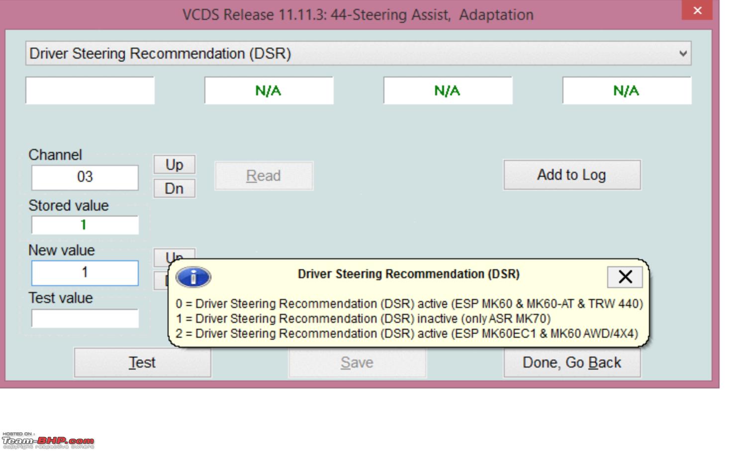

Also can someone shed some light on this:
Fault code : Address 03: ABS Brakes (J104) Labels: 1K0-907-379-60EC1F.clb
Part No SW: 1K0 907 379 BM HW: 1K0 907 379 BM
Component: ESP MK60EC1 H46 0164
Revision: 00H46001
Coding: A63B40F8092700FB650C02E990190082A1180022
Shop #: WSC 12345 678 90123
VCID: 7EF588A3E975A7EEE91-802B
1 Fault Found:
01309 - Power Steering Control Module (J500)
008 - Implausible Signal
Freeze Frame:
Fault Status: 01101000
Fault Priority: 3
Fault Frequency: 1
Reset counter: 236
Mileage: 21209 km
Time Indication: 0
Date: 2019.14.04
Time: 00:13:57
Freeze Frame:
Count: 11
Count: 2
Count: 12800
Count: 8212
Count: 49152
Count: 65280
Count: 513
Count: 0
Service center says nothing cameup in car scanning, But this fault code is permanently shown, Just want to be 100% sure there is nothing wrong with the car before i install the self parking, Since after that i doubt VW will honour me with any warranty.
Originally Posted by Tanveer_2558 (Post 3857219)
Thanks! Cannot trust the service where my car has visited a couple of times, So just wanted to be sure.....honour me with any warranty.
Fixed the issue, Finally after 3 hours! Anyone faces the same fault code do hit me up, Will surely help.
Share it here Tanveer. You'll help a lot of them, members and non-members alike. Some folks simply Google up 'the error code + the car' to find a solution for resolving the errors.
Was this a change in the long coding that resolved it?
Oh yes, Totally forgot about the non-members, Thanks!
So finally after weeks and weeks of trouble of the following fault code, Its gone and forever! So anyone facing the following fault code (Even if you clear it, It will reappear)
1 Fault Found:
This fault code actually comes in the ABS control module, But if you have Activated the Driver Steering Recommendation (DSR) In the ABS control module, You need to make sure, The correct ESP is selected in the Steering assist module.
Mine is ESP MK60EC1 (You can check yours in the ABS control module)
VCDS (Vag-Com Diagnostic System) for VW & Skoda - Discussion Thread-screen-shot-20151127-10.21.49-pm.png
Mine was set to 0, But it had to be "2".
That's all, One thing which i don't really get it is, How does my service centre screwup something in the VCD's everytime and send it back. To top it all, They always say, Car scanning was done, No fault code was found. :Frustrati
Hi Tanveer,
Your ABS module was coded wrong. Now that it is corrected, try activating indirect TPMS. It should work.
All the best! :)
