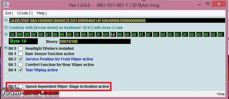

Thanks to the monsoons, I got a chance to test this feature which I had activated long time back:
Originally Posted by BigBrad (Post 3820249)
-Speed dependent wiping frequency of front wipers
It works like this:
The wiping speed reduces by one level when the car slows down to less than 5kmph and returns to the originally set speed when the speed is above 5kmph. If the wiper stalk is in the uppermost position (highest speed), the wiping speed reduces to the next lower level when the car slows down to 5kmph or less and returns to the original speed when the car goes above 5kmph. Similarly, if the wiper stalk is set to the 2nd position, the wiping speed changes to intermittent mode when the car is below 5kmph and is restored to the original speed on crossing 5kmph. However, please do note that it does not turn off the wiper completely when the car comes to a halt, no matter which position the stalk is set.:)
It is located in Central Electronics -> Coding -> Long Coding Helper -> Byte 14 -> Bit 7. Here's a screenshot posted by robimahanta from the first page of this thread for reference:
VCDS (Vag-Com Diagnostic System) for VW & Skoda - Discussion Thread-vcdswipers.jpg
