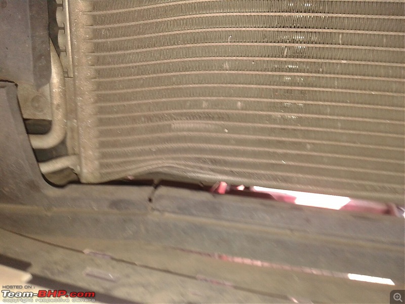

Hi guys, today I took my car to the service station where they found that the condenser was damaged. I took some photos. Can someone please assess the extent of the damage and let me know if I need to replace it?
I guess there is no major damage because AC still works and it wouldn't if the gas was leaking because of the damage. I think I hit a speed breaker or a rock or something. Please help :(

Absolutely don't worry about it, slight deformation in the condenser is normal. As long as the A/C in working fine, don't worry at all. Perhaps b/w the gap place some form.

Thanks Amit, that's what I thought too. My logic: In a home window AC, the fins get bent all the time and the AC still works perfectly. So I assumed the same to be true for a car. Anyway, the service station guys were trying make me pay for a new one saying AC will not work without it or that in future it may get spoiled.
And yes, I have AC problems but those were there even before this condenser got damaged so I don't think there is any connection between my existing AC problem and the condenser damage.

Drive through the night on highways infested by butterflies and other insects and you will realize the extent of damage to the condensor fins.
Last 40 days, I did 3 trips to Pune and back (1700 kms each) and mostly through the night for almost half the distance each way and as a practice when I open the Air filter element, I could find dead flies under the filter.
The condensor too had a lot of dead flies pasted flat with few fins bent. Used a typical kitchen spoon's end (Kids size) to straighten a few bent ones.

Only if you find ac not cooling properly, and thereafter you realize that the gas has leaked from the condenser, would you need to replace it.
VW grease monkeys are doing their usual trick: Trying to earning big money for their bosses (who will buy the next Audi from your money).
