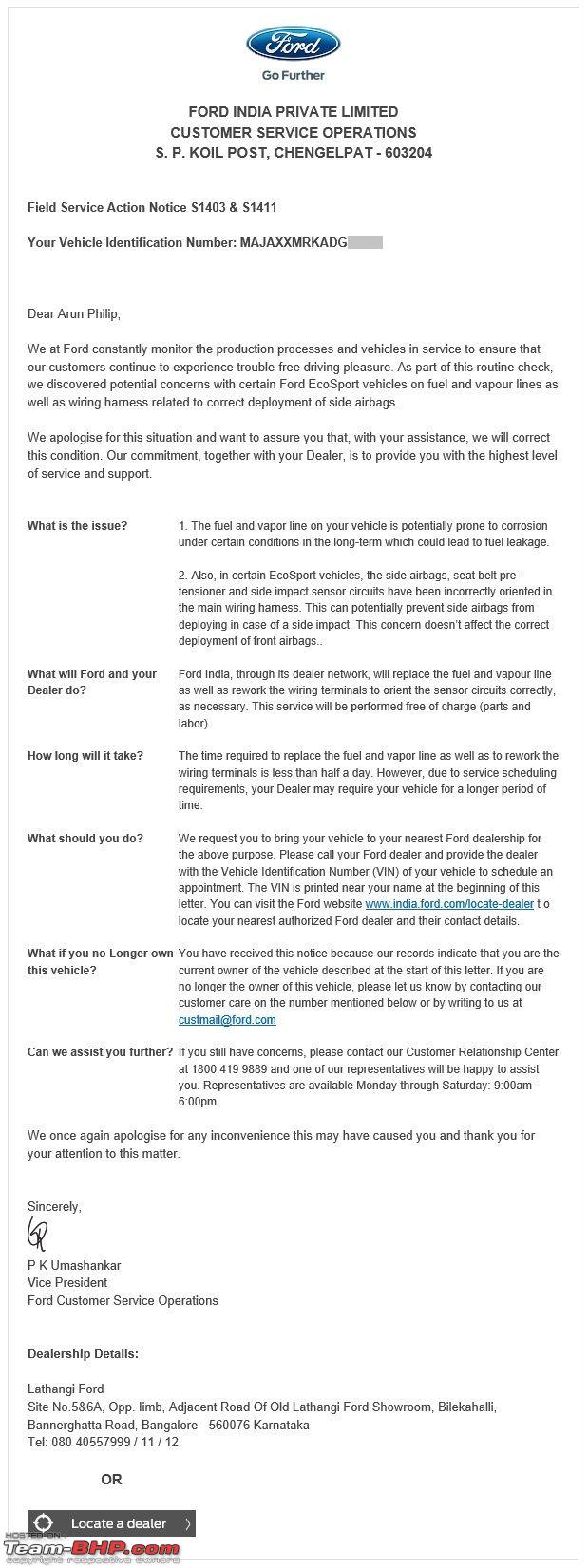

Here's the email I received on 29-Dec for my Titanium (O) EcoBoost manufactured in Aug 2013 - it covers both FSAs. I'm yet to schedule an appointment for this.
Ford India recalls 20,752 units of EcoSport-2014-12-ecosport-fsa-email-s1403-s1411.jpg

On 22-Jan, I went to Lathangi Ford, Bangalore to get both FSAs addressed.
The SA at Lathangi told me that they've not received a specific tool from Chennai to remove the fuel hose, so the FSA "S1403 FUEL TUBE AND VAPOUR TUBE REPLACEMENT" would have to wait for a few weeks, and they'll call me back. Given that this is a preventative action for long-term rusting, I'm ok to wait, thought I'd have preferred that I was informed about this when I made the appointment the previous day.
The work for FSA "S1411 RCM CONNECTOR WIRING" turned out to be far quicker than the 2 hours that were originally stated, it took only about 30 minutes (for the rewiring, and OBD-II diagnostics of the RCM). Speaking to the service technician, he said all Ford technicians in Bangalore were trained in a Metro Ford facility in Bangalore by someone who took the training from Chennai. He also mentioned that he's gotten used to the work which is why its so quick.
