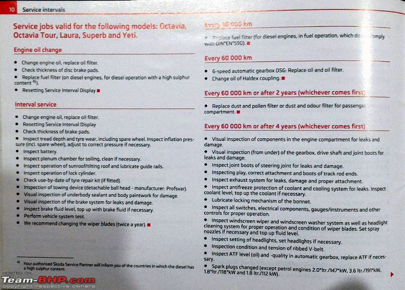

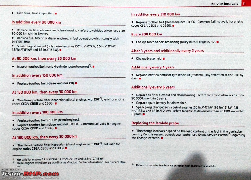

Is that a rubber belt or a chain? Any interval prescribed in your service manual?
It seems to be mentioned clearly in the Service Schedule booklet that I received with my 1.8 TSI.
VW / Skoda 1.8L TSI: When to replace the timing chain?-skoda-superb-service-interval1.jpg
VW / Skoda 1.8L TSI: When to replace the timing chain?-skoda-superb-service-interval2.jpg
It says to inspect the toothed belt @90k kms but it excludes the 1.8TSI engine for that. Then it says to replace the toothed belt @1.8Lkms but that is for the 2L petrol engine. So it is safe to assume to replace your belt at around the 1.8L km mark.
Also other points for consideration for the 1.8TSI engine is -
- Spark plugs life is 90k kms as they are long life titanium plugs. But they replace in India @30k, don't know why.
- Air Filter Life is also 90k kms but they replace here every 15k kms
- Dust and Pollen filter life is 60k kms but they replace that too @15k kms here.
- Fuel filter for petrol cars is also supposed to be for life but is replaced here every 15k kms.
Also as the vehicles sold in India are QG1 i.e. Variable Service Interval, they need to be serviced only once in 2 years if running is less than 15k and not every year, though I like to stick to 10k service interval. Brake fluid should be first changed at 3 year, then every 2 year.
Hope that helps.

Thanks for the detailed post. My concern was why the 1.8 TSI engine has been excluded for the replacement intervals and only the 2.0 TSI versions are mentioned. The chain and other hardware must be similar in both.
Been servicing my TSI at 10K intervals since last 2 services and maintaining oil above halfway mark at all times. I am at 82K kms with my TSI and absolutely no signs of fatigue from the engine. Still pulls like a freight train.
