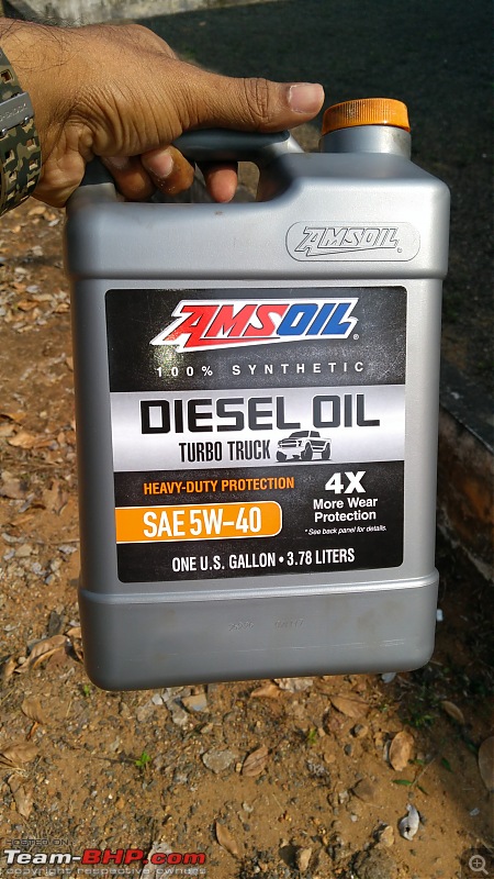

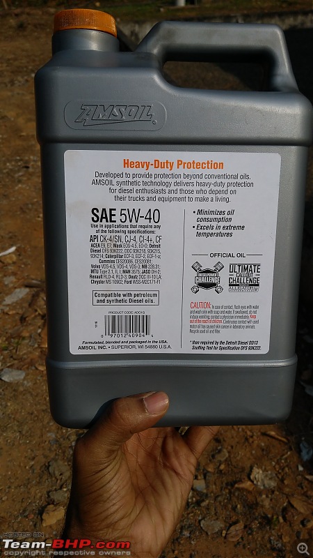

Completed 110000 kms. 40000 kms after the rebuild. There is an engine check light due to a glow plug failure. The technitian's couldn't remove it. So decided to leave it as such. Applying excesive force could damage the thread of the glow plug.Otherwise car is going fine. Did service and changed engine oil, oil filter, air filter, diesel filter, coolant , brake fluid, cabin ac filter. This time used Amsoil 5w40 engine oil. Appears to be as smooth as Mobil delvac 1. Bought it from Amazon India. Cost was 2700 Rs for 3.78 litre can.Measured the drained oil. Oil consumption was about 90 ml per 1000 kms.

My car is due for its service, its close to 96k and the last service was done at 90k wherein i replaced the timing chain, oil,oil filter etc.I believe they used castrol 5w40 and i dont want to wait till 10k service interval, i would prefer replacing a few thousand kilometers before hand.Now am wondering what oil should i buy for the upcoming oil change, should i replace with Mobil MGDO,or mobil delvac 1 or any other recommendations? My car does about 80 kilometer's a day and i like to keep it in top condition considering my sudden outstation plans that my work demands.
Would appreciate suggestions
scorpian is offline
Old 23rd January 2018, 16:06   #38
fireblade007's Avatar
Location: Thrissur
Posts: 168
Thanked: 105 Times
Re: Maruti SX4 ZDi: Experience with an engine rebuild at 70,000 kms
Scorpio, Mobil Delvac 1 is a good oil. It is full synthetic. Mobil MGDO is semi synthetic usually.Which ever oil you use, you should check the dipstick once in 500 kms atleast. I had to top up about 400 ml oil during the last 8000 kms. But while topping you should be careful to not overfill as overfilling can do damage in deisel engines. Maruti aftersales usually doesn't recommend topping up by customer because of the risk of overfilling. So never mention that you topped up the engine oil at Maruti service centres if you are in warranty period.

Scorpian, I am a fan of Mobil1 0w40 having used it from day one. But I guess switching-over to Mobil1 this late may not really help, you might as well use Mobil Delvac 1!
