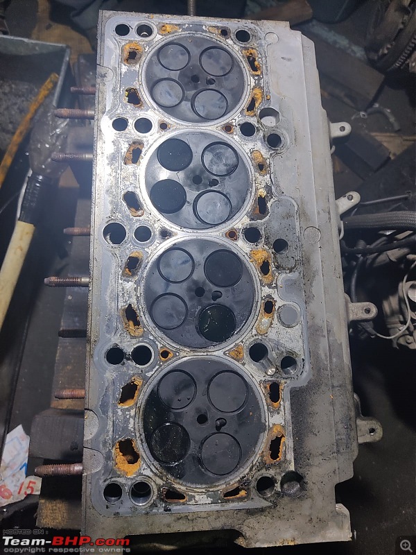

Engine head :
Heavy rust on water cavities with many of the cavity openings obstructed.

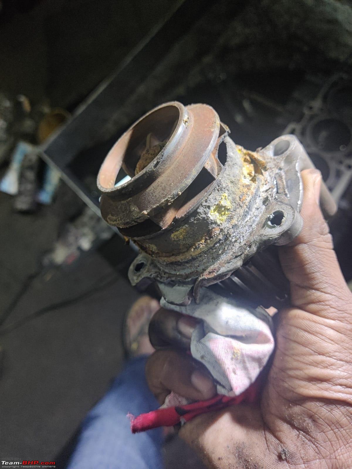

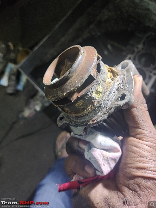

Water pump :
Too much rust and an edge of the propeller broken.

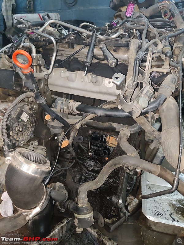

Engine block :
Almost all sides of block was having oil leak stains. No wonder it drank ~200 ml oil for 1000 kms.

Unfortunately, the workshop was closed for last few days due to Pongal holidays and yesterday workshop guy called me mentioning engine is opened up - asked me to come over and check on.
I totally understand the facts you suggested on economical sense on rebuilding the car by spending so much. But recently bought my home and dont think can fund for another car soon. I have to carry on with this rebuild i guess.
Here are few snaps from the engine which was ripped apart.
Engine head :
Attachment 2263422
Water pump :
Attachment 2263426

Attachment 2263423

On questioning will an engine suffer so much in less than 2L kms, following were probable causes mentioned :
1)Usage of plain water (which might have salt content) with coolant that might have caused the water pump rust and head water cavities to rust and create block.
2) The blockage of cavities created flow restriction for water causing damage to water pump propeller as well as slow flow of water reducing heat absorption from block and engine oil.
3) Reduced water flow and heat absorption to coolant water causes faster wearing of piston rings.
4) Due to clearance of piston rings, compression pressure within stroke length of piston is leaked to below oil sump and pressurizes oil to leak out through multiple locations such as camshaft seal, oil cooler seal, head to block joint, clutch housing etc.
Option mentioned is to go ahead with the rebuild. During rebuild - pistons, seals, reboring the sleeve/liner, changing all inlet/ outlet valves with guides and tappets, crankshaft bearing, water hose will be replaced.
Head rust and carbon deposits in multiple areas also would be cleaned.
Should I insist on anything else that needs to be done?
Also, the cost of overhaul excluding the clutch is quoted ~1.3 Lakhs. Is this a normal cost?
I intend to keep car for atleast a year post rebuild with an average running of 3000km a month.
Any additional points to check on will be helpful .
Unfortunately the engine was opened up earlier itself.
Yes, the oil leak was too intense across multiple location which would probably the reason of oil consumption
As the engine is already disassembled, you will have to proceed with the rebuild.
1.3 lakhs sounds ok to me considering its a German car. Please make sure the quality of parts they are using. If they are using genuine parts then you may proceed.
A brand new 1.2 TDi cost around 3.5 lakhs and just the assembled block cost 1.7 lakhs. You can check the same on Boodmo.
Personally I don't have any experience with engine rebuild cost but have seen Maruti and Tata ones getting complete overhaul at around 60k. So for VW a high cost maybe expected.
Apart from that, where did you get the coolant changed? Using tap water to dilute coolant sounds absolute negligence on the part of the mechanic. Needless to say it would kill the engine.
pta320 is offline

It's sad to see so much corrosion inside the engine. The culprit is obviously the use of tap water to dilute the coolant. Tough luck I would say.
Use original spares. Ensure that the engine block and head are cleaned thoroughly. Also check if the engine block or head is still usable after this corrosion. Check below video for guidance
