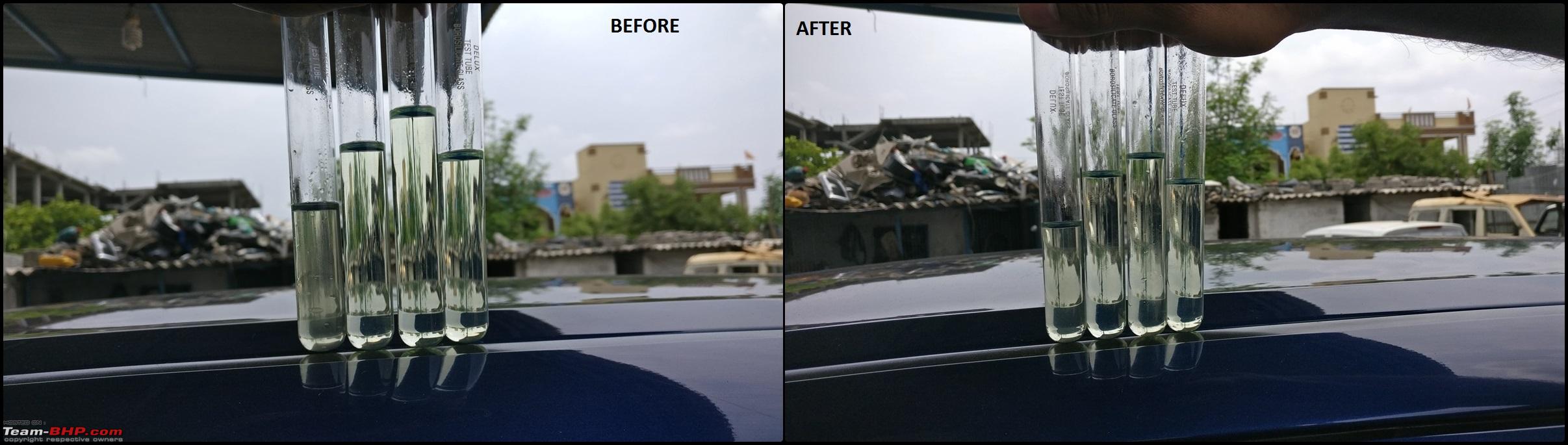

Before going into using the diesel purge we wanted to check how each injector is functioning and how blocked or clean it is. This test will also give us an approximate idea how well the Diesel Purge has worked. :)
So we did the Fuel Injector Return Flow Test

Quantity of diesel obtained in test tubes
Post measuring using the cylinder
Results and Observations:
Looking at the quantities it was concluded that Injector No. 3 is the clogged the most followed by No. 4, No. 2 and lastly No. 1.
The cleanest one being I think is No.1 and worst is No. 3.

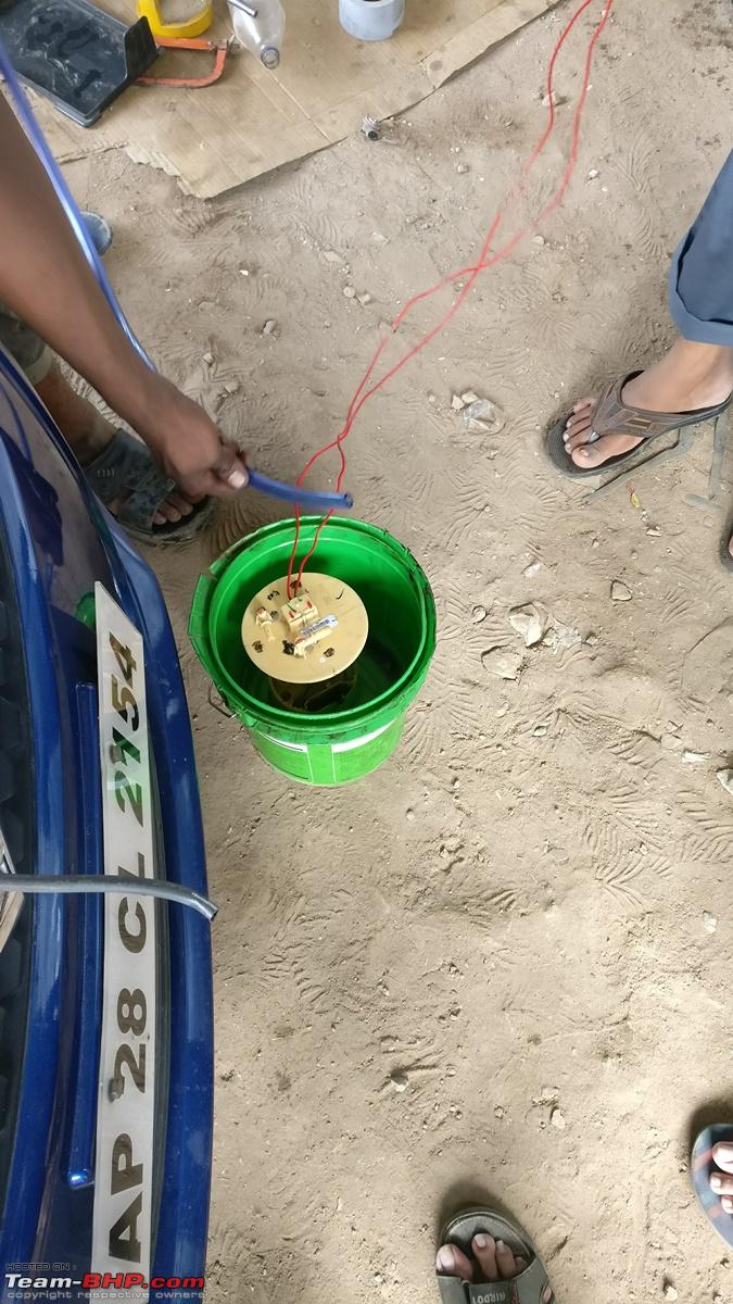

Initially we thought of disconnecting the inlet and return lines from the injection pump and putting it into the bottle of diesel purge but that will not work as the injection pump cannot generate enough pressure required for the Purge to work. The injection pump will function when there is a constant pressure feed into its inlet that will then amplify and send it to the rail pressure and injectors. Hence the need for a spare pump was necessary (please correct me if I am wrong, noob in these areas yet).
So the process we followed was:
Step - 1: Disconnect the battery and remove it from the car for easy working around the fuel filter area. Get a spare functioning fuel pump and place it in the bucket with 1-2 litres of diesel.
Step - 2: Make a temporary connection using wires and crimp connector so the fuel pump can be run using the battery while the purging is going on;
Step - 3: We found two salvaged fuel lines, cut it to required length, cleaned it thoroughly with Diesel and pressurized air before using (VERY IMPORTANT);
Step - 4: Disconnect the hoses coming the car's fuel tank to the fuel filter and connect the fuel lines that were prepared in Step - 3.
Step - 5: Change the fuel filter (IF older than 10,000 kms) before beginning the test.
Step - 6: Run the fuel pump circulating the diesel in it to check for any leaks and proper + continuous functioning.
Step - 7: Ascertained all good, make the final connections and secure the fuel lines properly with clamps and nylon zip ties for additional safety.

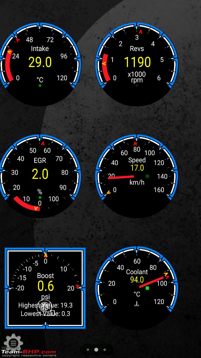

Step - 10: Simultaneously I connected the OBD-II reader to ascertain the approximate fuel flow to determine how long the test would run to avoid issues of pump running dry causing an air lock.
Step - 11: At idle it read 0.6 litres per minute. The stock in the bucket at the start of the test was 2 litres fresh diesel and 500ml of diesel purge. So it gets 2.5L quantity of mixture. We decided to use up around 2L to avoid any air lock issues.

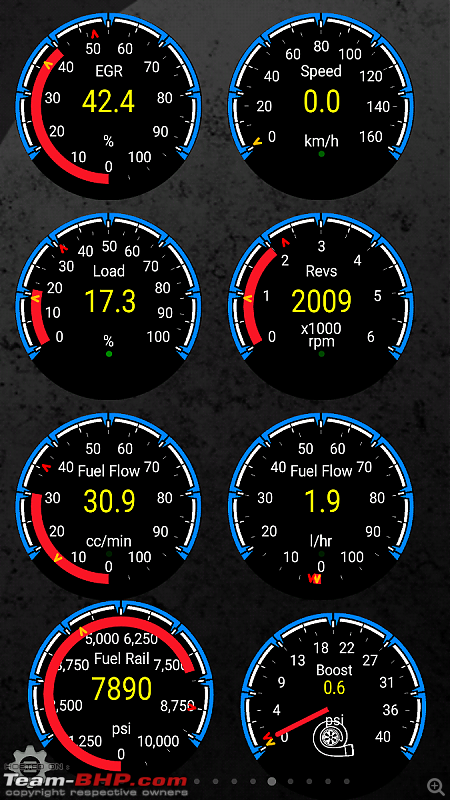

Step - 12: After letting the engine idle for 2 minutes, RPM was raised and maintained it at that as instructed in the video for the Diesel Purge to function correctly.
Following were the RPM's maintained during the test:
a) 1500
b) 1700
c) 1800
d) 2000
e) 2500
f) Short burst to 3000
g) Short burst to 3500
Step - 13: All the while during this test BHPian interc00led had the concentration set on the bucket and I was at the pedal ringing the engine :D

Spare fuel pump with temporary connection
Getting diesel from fuel tank prior to test start
Spare pump placed in bucket and run to check for functioning and removing any air locks
Injector Cleaning in my Swift-6.-spare-pump-placed-bucket-removing-air-lock-checking-proper-working.jpg

At idling RPM
At 2000 RPM
At 2200 RPM
At 3500 RPM
After Diesel Purge - Test tube return quantities
Measured the quantity in each test tube
