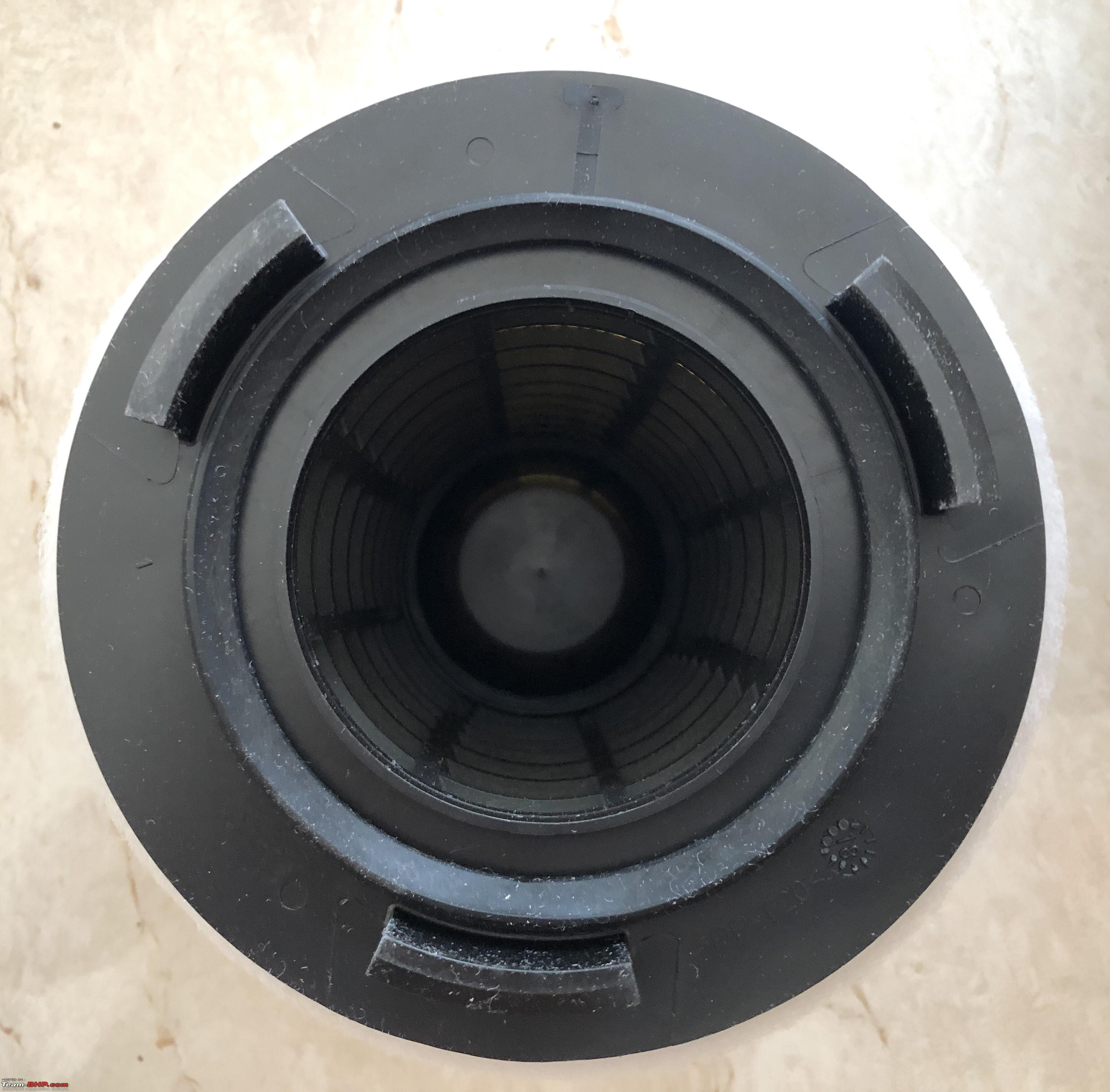

Made in Tunisia. The filter shipped from Barcelona, the amazon fulfilment centre.
Solved: VW Polo GT TSI power drop after service! It was the air filter-img_0464.jpg
Solved: VW Polo GT TSI power drop after service! It was the air filter-img_0465.jpg
Clean quality. Original. This will serve me for the next 30,000 kms. :D

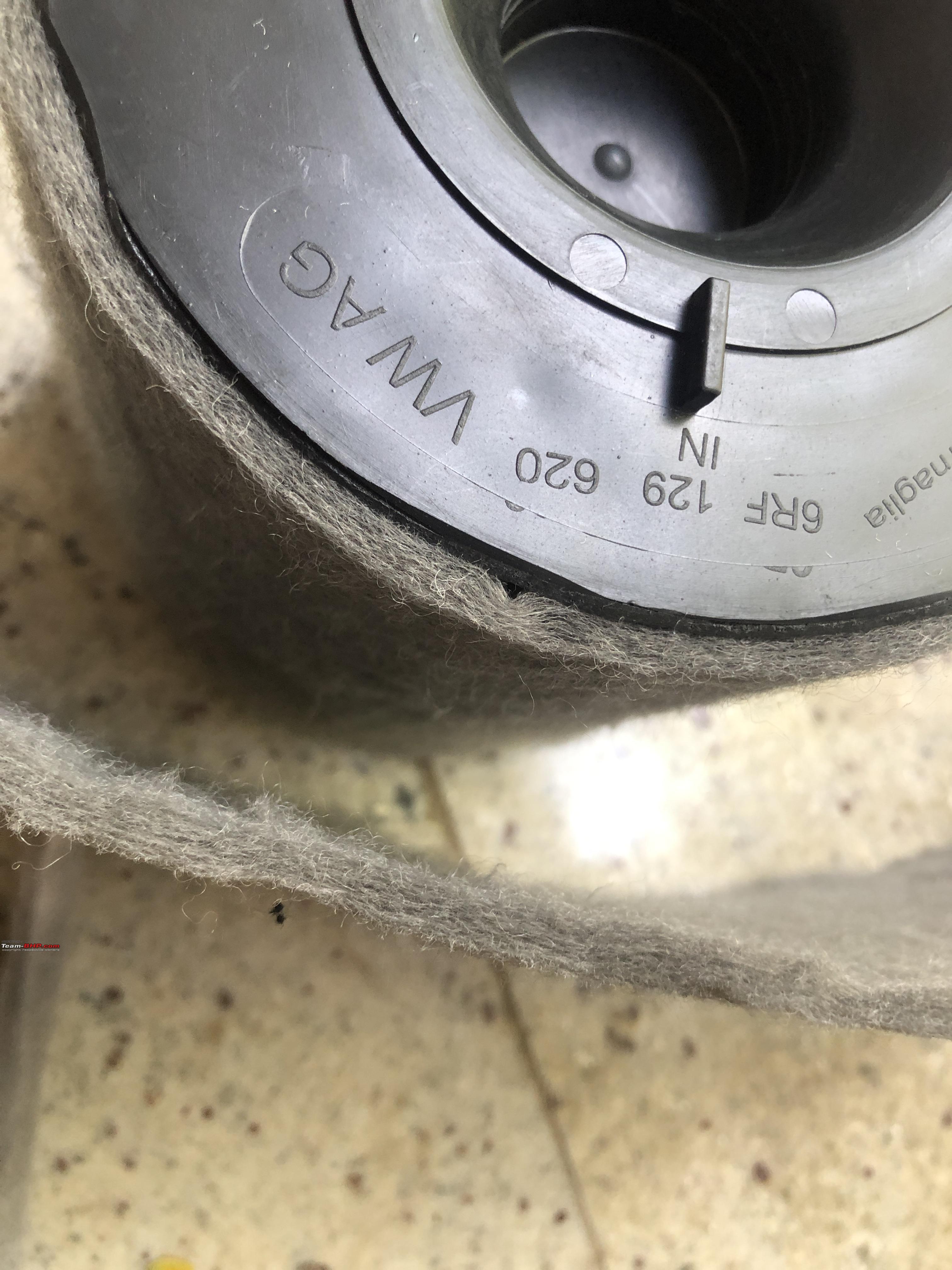

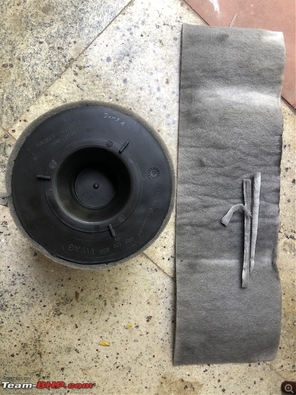

The same issue recurs after they replace the UFI with a OEM filter. So I tried out some different things:
Act 1:
The outer sheath of the airfilter is a kind of felt material. It is quite thick and resits the airflow quite a bit. So what I did was to peel the surface of it until its about 50% less in thickness. And this made quite a lot of difference in performance. With much better airflow, the stock filter performs almost as good as UFI filter.
