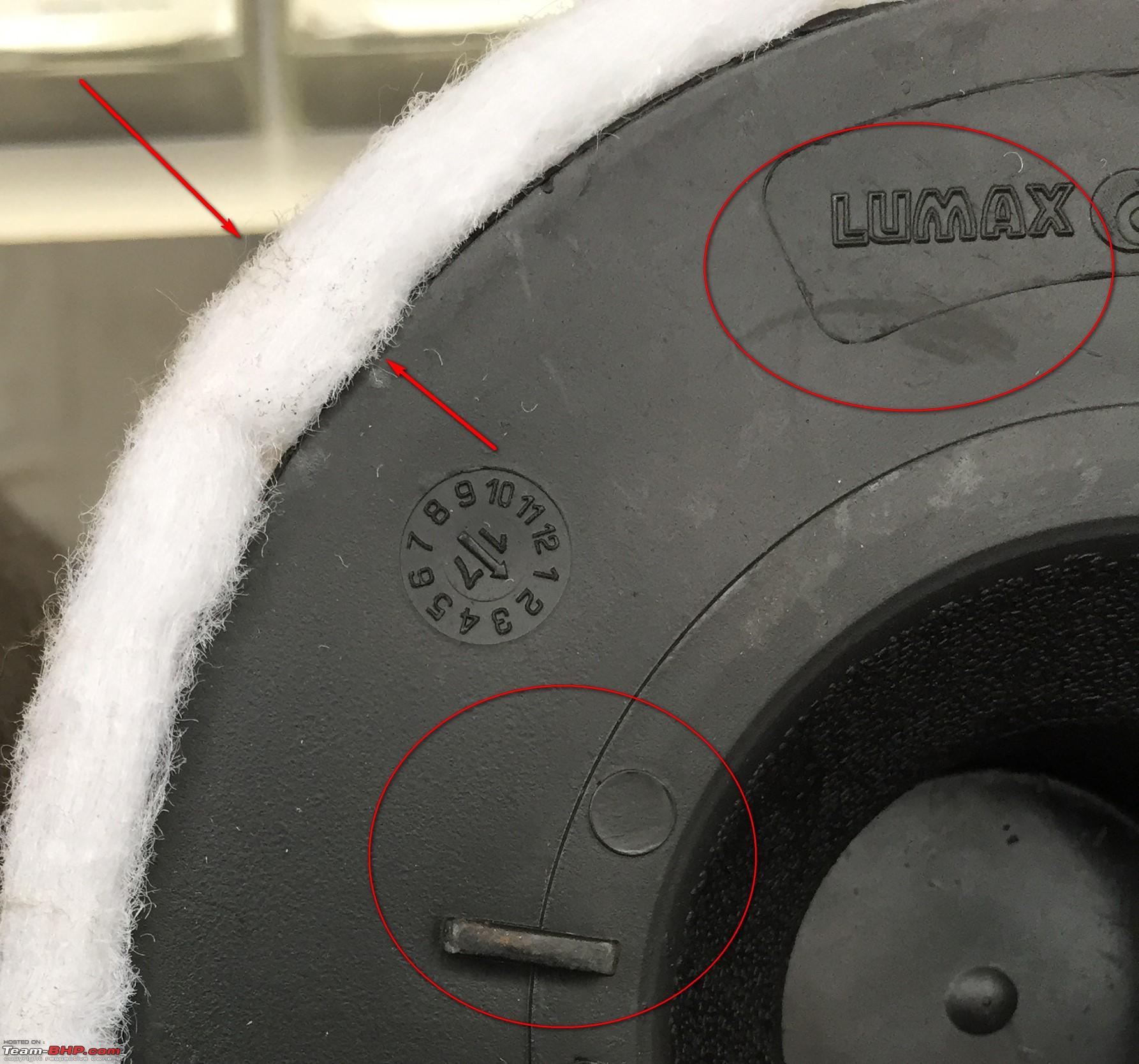

The one installed in the car was an air filter made by Lumax with part number 6RF129620 Made in India (Pune). Costs 396/- Pre GST inclusive of VAT. As on mid June 2017
Solved: VW Polo GT TSI power drop after service! It was the air filter-lumax1.jpg
More pictures of the Lumax air filter in this thread: http://www.team-bhp.com/forum/diy-do...-cleaning.html
Above are the pictures of both. The UFI and Lumax. What I observed is that the quality of the two air filters was very different. The UFI was of much better quality than the Lumax. The mould quality of the Lumax is crap. The injection moulding remnants, the overly thick outer fibre.
Solved: VW Polo GT TSI power drop after service! It was the air filter-lumax2.jpg
It looks much worse than a local air filter available in places in SP Road. I’ve seen Maruti Air filters. They are of far better quality than this one. This is just plain substandard.
Check out the thickness of the fibre layering on the outer surface. Its common sense, that the thicker the filter, the less the air that gets in. The design of air filter is a thin line of art. One has to get most particulate matter filtered without hampering the density of air. Its like a skirt design, shouldn't be too high nor too low which will mar the intent.
