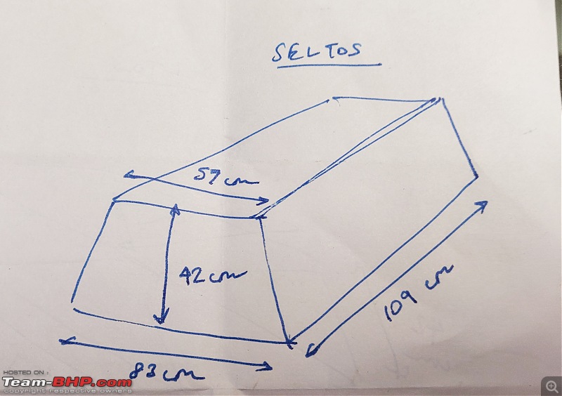

Recently I went to see the Kia Seltos and took the actual boot measurements as below.
As per the Boot measurements, the actual boot space is :
(109 cm x 42cm x (57+83)/2 )/1000 = 310L and if you include the small niche on the left, it is around 10L and the total comes to 320L. This is with the rear seat in the upright position (rear seat is adjustable in recline in two steps). If the seat is reclined to the relaxed position the boot space will be even lesser by 30-40L.
This is the actual measured boot space below the parcel shelf and above the spare tyre cover. The claimed boot space is 430L - again another example of manufacturer overstating the boot space.
Behemoth is offline   (12) Thanks

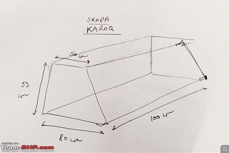

So yesterday I went to see the Karoq and as always, I took actual measurements of the boot space to find out the real boot capacity. The measurements are as below:
Measuring the actual boot capacity of your car-img_20200607_123538__01__01.jpg
The actual boot capacity below the parcel shelf comes out as
((50+80)/2 x 53 x 100 )/1000= 344.5 L. There are two niches on the sides of around 15 L each so total comes to around 375 L , which is drastically far from the claimed 520 L of the Karoq!
Very misleading numbers - Skoda sells the car in Europe without the spare wheel and is sharing the same numbers as boot space in India? Why can't manufacturers report the boot space properly. For the minimal boot space the Karoq is off my list now.
Two cars which actually have much bigger boot space than this and are reporting the boot size correctly are the Harrier and Nissan Kicks - both have a full 400L boot space area which is fully available and does not include the spare wheel.
Seriously these Csuv manufacturers need to take a lesson from Renault triber on Space management! Triber has a 620L boot in 5 seat mode in a car less than 4m length!
