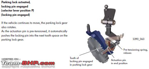

Here are few more self-explanatory diagrams to illustrate some specific scenarios of the parking lock mechanism.
Scenario 1: Parking lock not actuated
Name:  Parking lock not actuated.PNG
Scenario 2: Parking lock actuated BUT locking pin not engaged
Name:  Parking lock actuated.PNG
Scenario 3: Parking pin actuated AND locking pin also engaged
Name:  Parking lock actuated 2.PNG
And finally, here is a diagram showing how the parking lock gear mates with the output shaft:-
Name:  parking lock assembly with output shaft.PNG
