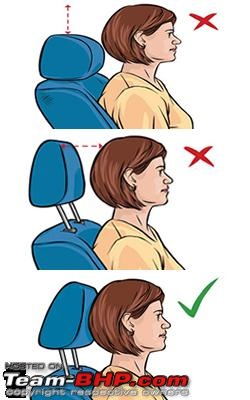

I apologize, my original post was unclear. I do not intentionally try to rest my head against the headrest, I've just observed that I've never been able to rest my head on them.
About the use of headrests, I too had the same idea until I came across the following image in a post in another thread:
boniver is online now   (4) Thanks

The term Head-Rest is indeed a misnomer. The purpose of the head rest is not to rest one's head while driving, but to prevent whiplash injuries to the neck.
Attachment 1861628
You're not doing it wrong - the head is supposed to be upright, not rested.
I didn't quite understand the last two images in the above post. As far as I know, the headrest only has vertical travel. How did the image lady bring it forward to touch her head??
