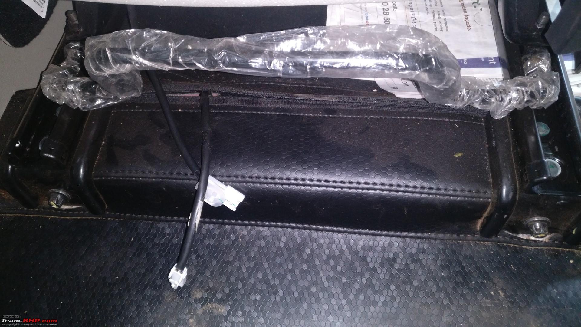

The seatbelt warning can be temporarily stopped by detaching the cable below the co-passenger's seat, as in the attached image. Interestingly, I got delivery of my M8 variant in this condition due to which I never faced any problem!! But this makes me wonder about its airbag operation.
Mahindra Marazzo's malfunctioning co-driver seatbelt warning alarm-img_20190613_090930.jpg

Is there anyone on this forum whose Marazzo DOES NOT have a passenger seat belt warning? I have a 2018 Marazzo M8 and I do not have this feature on my car!

Check your passenger seat, you may also have faced the unplugged wire issue like Sachin above.

Wow that is scary. Some serious issue this. And rightly pointed out, this might even affect the airbag deployment.
I will check this and will surely register my complaint with Mahindra if required.
