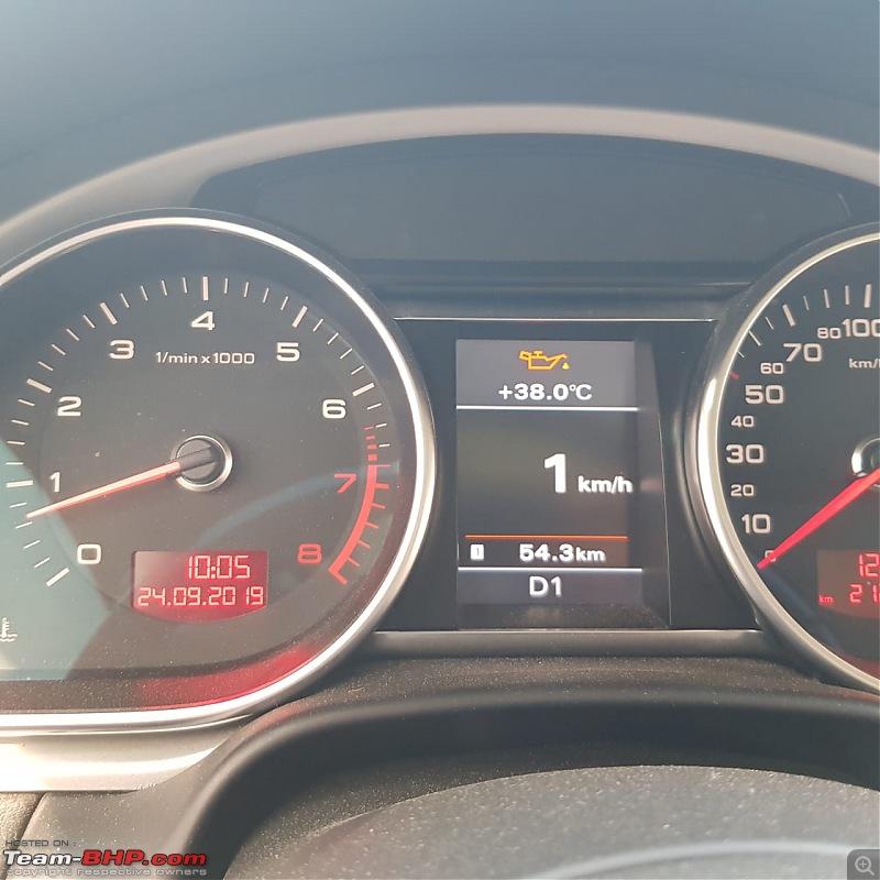

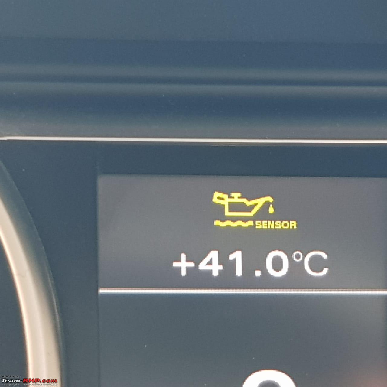

Audi Q7: Coolant has mixed with engine oil & triggered a plethora of issues
Hi All,
I have been Audi Q7 (2011 model) 3.0 V6. It was working fine till last week with almost no issues.
Last week, the coolant sensor lit up mid-drive. So I pulled over and checked the coolant level after letting the car cool down for about 20 minutes.
Audi Q7: Coolant has mixed with engine oil & triggered a plethora of issues-coolant-warning.jpeg
The coolant had turned completely brown. My coolant is generally green. So I knew something was wrong. Quick google suggested that the engine cylinder head gasket must have been damaged allowing coolant to mix with engine oil.
Audi Q7: Coolant has mixed with engine oil & triggered a plethora of issues-coolant_1.jpeg
Audi Q7: Coolant has mixed with engine oil & triggered a plethora of issues-coolant_2.jpeg
So I sent the car to garage on a flatbed and he confirmed the google knowledge. Over the period of next 6 days, he got the engine cleaned thoroughly, coolant box cleaned, pipes replaced, coolant and engine oil replaced.
After I received the car, I observed that engine temperature was unusually high. It is generally around 60 whereas, it was 90 now. I checked with Garage and he said that since all coolant is just added, it will take time to circulate and engine will cool down. I had my own doubts on this theory but proceeded nevertheless.
Next day, after driving approximately 45km at constant speed of 120, three indicators started beeping consistently all of a sudden.
Name:	Coolant Warning.jpeg
Audi Q7: Coolant has mixed with engine oil & triggered a plethora of issues-oil-sensor-warning.jpeg
Audi Q7: Coolant has mixed with engine oil & triggered a plethora of issues-oil-warning.jpeg
So I stopped the car and opened bonnet to cool the engine before I check coolant or engine oil. To my horror, the car engine was surrounded by white smoke and was making sounds (similar to Diwali crackers, patt, patt type). Here is the video of the car. If you observe closely, you can see the smoke. The sound (patt patt) is lost in the surrounding noises but was very prominent.
I again loaded in onto flatbed and took it to Garage. By the time I reached garage, the engine had cooled down. So no noise or smoke was present. Drove with garage folks again for 5 km and the sound+smoke was back prominently. The mechanic said this is due to faulty water pump and is investigating the same. Few other trusted mechanics are saying that either oil pump is gone or the whole engine is history now.
I am waiting for analysis from mechanic and estimates. Anybody faced a similar issue? What this could be?
Also, is is worth keeping this car now? Few mechanics are saying that since the head cylinder gasket was gone, it's only few months from engine seizure. Is there any truth to this claim? I got this car pretty cheap (around 4.6 lakh INR). So I don't mind selling it at first quote I get but my son and daughter have an emotional connect to car so would want to keep this if the car is going to survive this episode.
