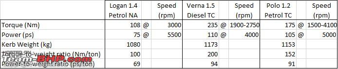

In my opinion, it depends more on where the vehicle will be driven the most.
If the vehicle owner is situated near relatively traffic free highways, I would say, an eager to rev NA vehicle would be enjoyable, but if he stays inside the city, I say a TC vehicle, which will eagerly show more performance from the word go.
If it is a free road, then an NA vehicle would be entertaining, by taking it to higher rpms easily, but if there is traffic, when the rpm drops frequently due to braking, then to maintain average speed, it becomes difficult, in which case, a TC vehicle can much more easily go to higher vehicle speeds (since it does not have to rev that high to reach higher vehicle speeds). In other words, thru gear acceleration might be comparable in both NA and TC vehicles, but in-gear acceleration is relatively better in TC vehicles.
NA engines are rev happy, but then it also need to rev to a higher rpm to produce the same power/torque, whereas TC engines start developing higher power/torque from lower rpm onwards (please refer the engine specs given below), which is why in-gear acceleration tends to be better in TC vehicles.
This was experienced on different long drives on our Logan (1.4 NA Petrol) and on my Verna (1.5 TC Diesel). The Logan whenever the speed dropped due to some traffic or speed breaker, I found it stressful (due to the low acceleration) to bring the vehicle again back to cruising speeds, but with the Verna, when similar happens, it is a delight (mainly due to the low end, which is enhanced by the VGT) to bring it back to highway speeds.
I realize the above two examples are on the extreme ends of the power/torque-to-weight spectrum. Logan 1.4 Petrol has one of the lowest power/torque-to-weight ratio and Verna 1.5 Diesel has one of the highest power/torque-to-weight ratios, so the effect what I felt is far more pronounced than in a regular TC Petrol. So, for better understanding, I have given below, the specs of the above two vehicles and a TC Petrol, Polo 1.2 (GT) for our easy comparison.
Petrol: Smaller turbo engine vs larger naturally-aspirated one-naortc1.jpg
