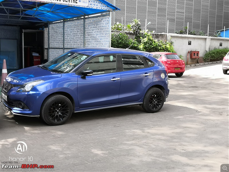

Here's an update on the 50K service of my Baleno CVT (Zeta). Also, I wanted to get the CVT Transmission oil checked and replaced during this service.
Though the service manual doesn't mention anything regarding the inspection and replacement of CVT oil, I wanted the service centre to go ahead and replace.
So, I requested them to place the order before hand and notify me when they're ready.
This post might be the first to be documented on Team-BHP regarding the CVT Transmission (Gear) Oil replacement for Baleno CVT.
During this service, MASS made a quick call to NEXA technicians on the oil replacement. After getting the required instruction and procedure, they began the replacement. So similar to engine oil replacement, the CVT oil was drained and in went fresh CVT Fluid Green 2.
Total quantity consumed was about 2.2 litres.
It looks like MASS procures a 4litre ECSTAR CVT fluid can only based on customer's request.
Apart from this, I got a pair of rubber mudflaps fixed on the RS rear bumper.
MASS followed strict guidelines by sanitizing the vehicle before and after service. Also, fresh plastic covers on seat, gear knob and steering were once again provided during delivery.

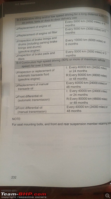

^^ Spot on.
CVT fluid needs to be replaced much more frequently than transmission fluid in torque converter ATs.
1. Honda recommends a CVT fluid change every 40k kms
CVT Transmission (Gear) Oil replacement for the Maruti Baleno CVT-brv_mtceschedule.jpg
2. As per your post, the Baleno CVT needs it every 60k kms
In contrast, Toyota 4 speed ATs do not require transmission fluid change for life under normal driving conditions.
This applies to the old Corolla, the 2008-11 Altis, the Fortuner AT. Not sure about the 2016 and later Crystas and Fortuners though
CVT Transmission (Gear) Oil replacement for the Maruti Baleno CVT-p_20200921_114341.jpg
CVT Transmission (Gear) Oil replacement for the Maruti Baleno CVT-p_20200921_115211.jpg
CVT Transmission (Gear) Oil replacement for the Maruti Baleno CVT-p_20200921_115231.jpg
CVT Transmission (Gear) Oil replacement for the Maruti Baleno CVT-p_20200921_115245.jpg
CVT Transmission (Gear) Oil replacement for the Maruti Baleno CVT-p_20200921_115301.jpg
Suzuki recommends transmission fluid change on their 4-speed torque converter ATs only every 11 years / 1,65,000kms.
Could someone add the maintenance schedule of the newer Toyotas here please?
