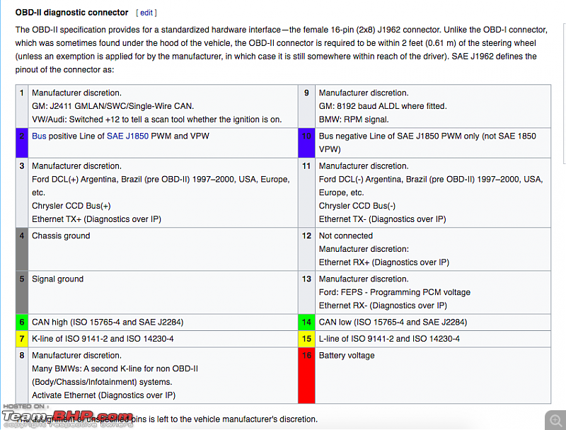

After sifting through the replies, I am seeing lot of useful nice to have features, as well as mention of some ridiculous (IMO) features like G force.
One of the nice to have features which I absolutely agree, is the battery health indicator. I started to wonder if this can be managed through an app, I googled around and stumbled upon an encouraging info item.
OBD II specs already have a provision for battery voltage across Pin 16 and Pin 4.
Connect phone with OBD sensor and you should be able to read current voltage. Convert to % health (dead battery need not necessarily be 0 volts, even say 11 volts will be useless to crank the engine) and display in a nice UI.
Any takers?
Or better yet, perhaps @GTO and TBHP team can develop this commercially?

I think that'll be hard to implement as car batteries are not 'smart' batteries(i.e. they don't have a mechanism to monitor SoC). The 'current voltage' idea won't come in too handy, and at worst may even be misleading, as quite often older batteries can show a surface level charge(i.e. good voltages) but be unable to provide the current required to crank the engine. In this situation, the voltage would read 13V or so when the car is switched off, and drop to 9-10ish volts when you try to crank it; in which case it's not useful as the car won't crank anyway and you'll know the battery is dead. I've experienced this with older batteries in the past.

What you say might very well be true. I am a noob when it comes to battery technology.
1) By "current voltage" I meant the voltage as of this moment (current not to be confused with electrical current). Clarifying this in case it makes any difference.
2) My thought was inspired by this mod by @ghpk
https://www.team-bhp.com/forum/diy-d...ml#post3715478 (D.I.Y. Weekend Project: Car Battery Voltage Monitor)
