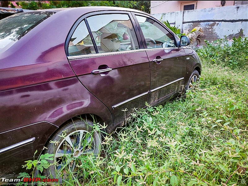

So, these two have been sitting away from our home, in what use to be a garden for around 5 months. Probably the perfect example of how not to leave your car parked for long durations.
Before you blame it on me, these cars are in my family but were not my responsibility and I wanted their owners to take care of them. Though eventually I'd to come to the rescue, cause I will be responsible for paying the maintenance bills anyways.
How to start a car that's been unused for a long time?-screenshot_20200912213737__01.jpg
TATA Manza Elan being a diesel was more of a concern
How to start a car that's been unused for a long time?-screenshot_20200912213754__01.jpg
than the erstwhile Maruti Suzuki Zen Automatic.
How to start a car that's been unused for a long time?-screenshot_20200912213743__01.jpg
Interiors of Manza were clean, no sign of any rodent intrusion or damages.
How to start a car that's been unused for a long time?-screenshot_20200912213759__01.jpg
Tyres had sunk in a couple of inches.

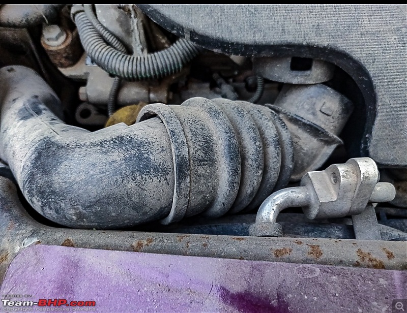

Opened the hood and as expected it was not a pretty sight.
How to start a car that's been unused for a long time?-screenshot_20200912213850__01.jpg
Must have been a busy place for insects but thankfully no sign of any rodent intrusion in the engine bay as well.
How to start a car that's been unused for a long time?-screenshot_20200912213821__01.jpg

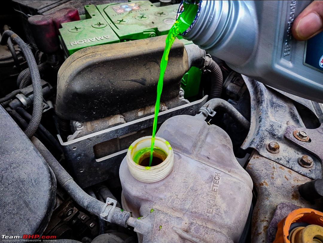

Went through the routine check and everything looked fine. Checked all the fluid levels too.
How to start a car that's been unused for a long time?-screenshot_20200912213901__01.jpg
And, only the coolant needed top-up.

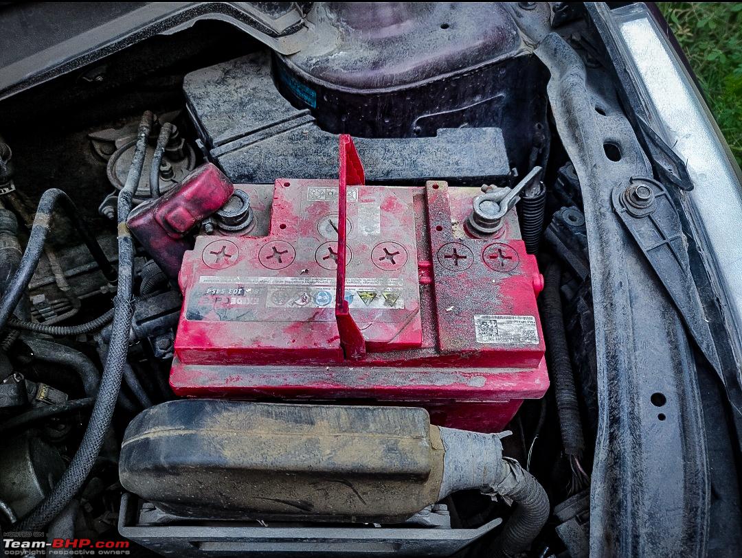

But, the battery was dead so had to use a donor battery from another car.
