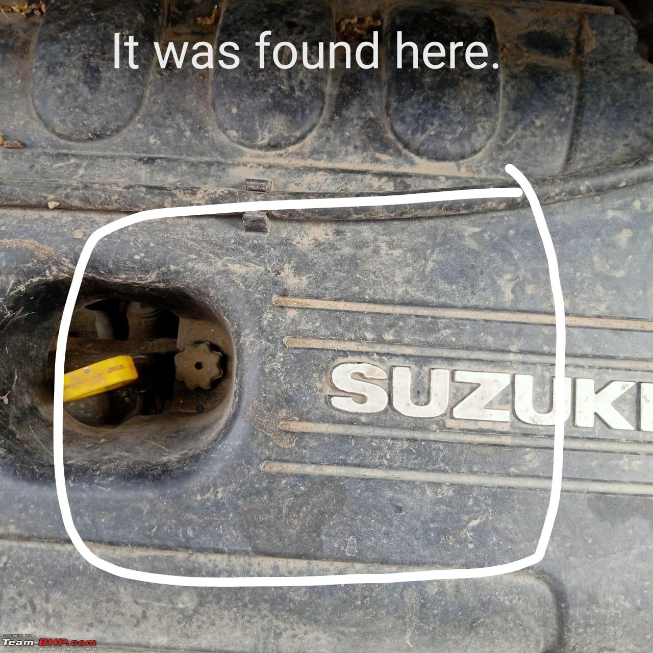

My suggestion would be to stick to the doorstep service offered by Maruti. Let them come in and do a thorough examination plus change oils etc. There wouldn't be any wear and tear parts to be changed I guess. The brakes may have got jammed, especially if handbrake was applied. They would also check the wiring for damage by rodents.
Another thing to check would be rodents and reptiles. Our Wagon R was not being used for a week. The AC was not working so a driver took it to mechanic to get it repaired. When the hood was popped open, a dead snake/shedded skin was found lying on the engine cover. We get yearly visitors to our house but this year, it has gone to double digits.
How to start a car that's been unused for a long time?-img20200909wa0000.jpg
How to start a car that's been unused for a long time?-img20200908wa0030.jpg
