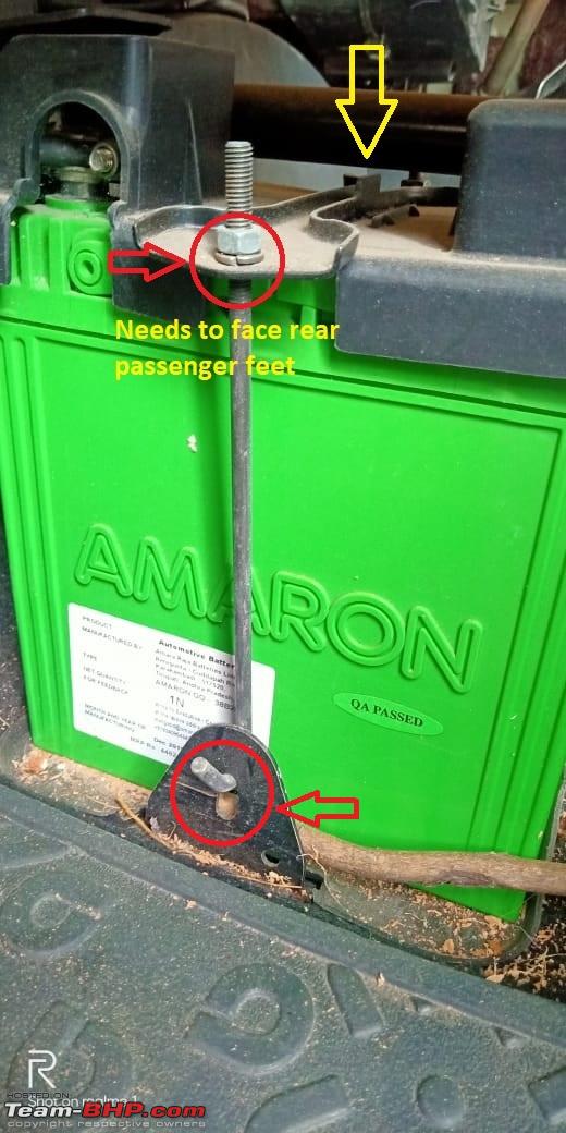

• Battery under the seat is not a good idea; the carpet and floor bear the brunt of acid leaks
The battery fitted in the Nano was an Exide 38B20R (35Ah) while the OE spec is 25Ah. The bigger battery is an extremely tight fit under the seat and results in the fixed clamp towards the front becoming useless. Note in the image how the front fixed clamp is fitted.
38B20R battery is a tight fit
Attachment 2088815
Well, I personally have no gross about the battery placement. I remember reading somewhere that battery was placed there as a part of weight balancing. Also, I am surprised that a sealed/maintenance free battery can leak so much of fluids in first place. Looks more like someone tried opening the seal while the battery was still inside the car and it would have tipped over. Anyways, about the battery's tight fit, I guess the mechanic didn't know how to remove/put back the battery. I say this because, I was able replace the battery in my Nano myself without much effort.
I can see in your picture that the top piece of metal that holds the batter in place, is not positioned in the correct way.
See the attached picture taken in my Nano, the metal plate has a small grove that allows for front/back movement while placing the plate in place and that needs to face the drivers legs. Similarly, the other end of the plate has just a hole and that will face the passenger side BUT the base plate has a elongated (vertically) slot that allows for up and down movement/adjustment.
I am sure, you will be able to fix the hold metal plate in place if you try to reposition the plate as seen in the picture.
Lastly, you say your battery is 35AH and the Amaron battery that you see in the picture is also 35AH (at least that is what was told to me while selling it), then how come the size difference? Not sure, if size will vary based on manufacturer!
Thank you for the pictures, @T-Bone. The older Nanos didn't have the groove on the holding plate, but just a hole both in the front and the rear. I created the groove like in your car by chopping off some metal using a hacksaw. Now the battery looks well secured.
Look at how tall the 35Ah Exide is; it looks marginally taller than your Amaron 35Ah battery.
