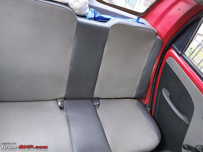

Acres of space in the front and rear
Experiences with a 2011 Tata Nano CX – The James Bond Car-nano_driverdoorview.jpg
Experiences with a 2011 Tata Nano CX – The James Bond Car-nano_frontpsngrseat.jpg

• Adequate seating for 3 average sized adults in the rear seat

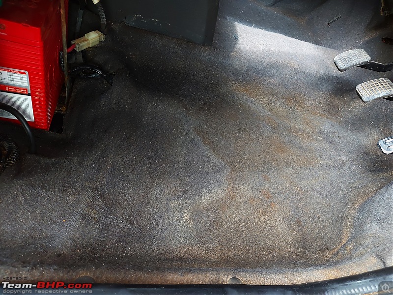

• Battery under the seat is not a good idea; the carpet and floor bear the brunt of acid leaks

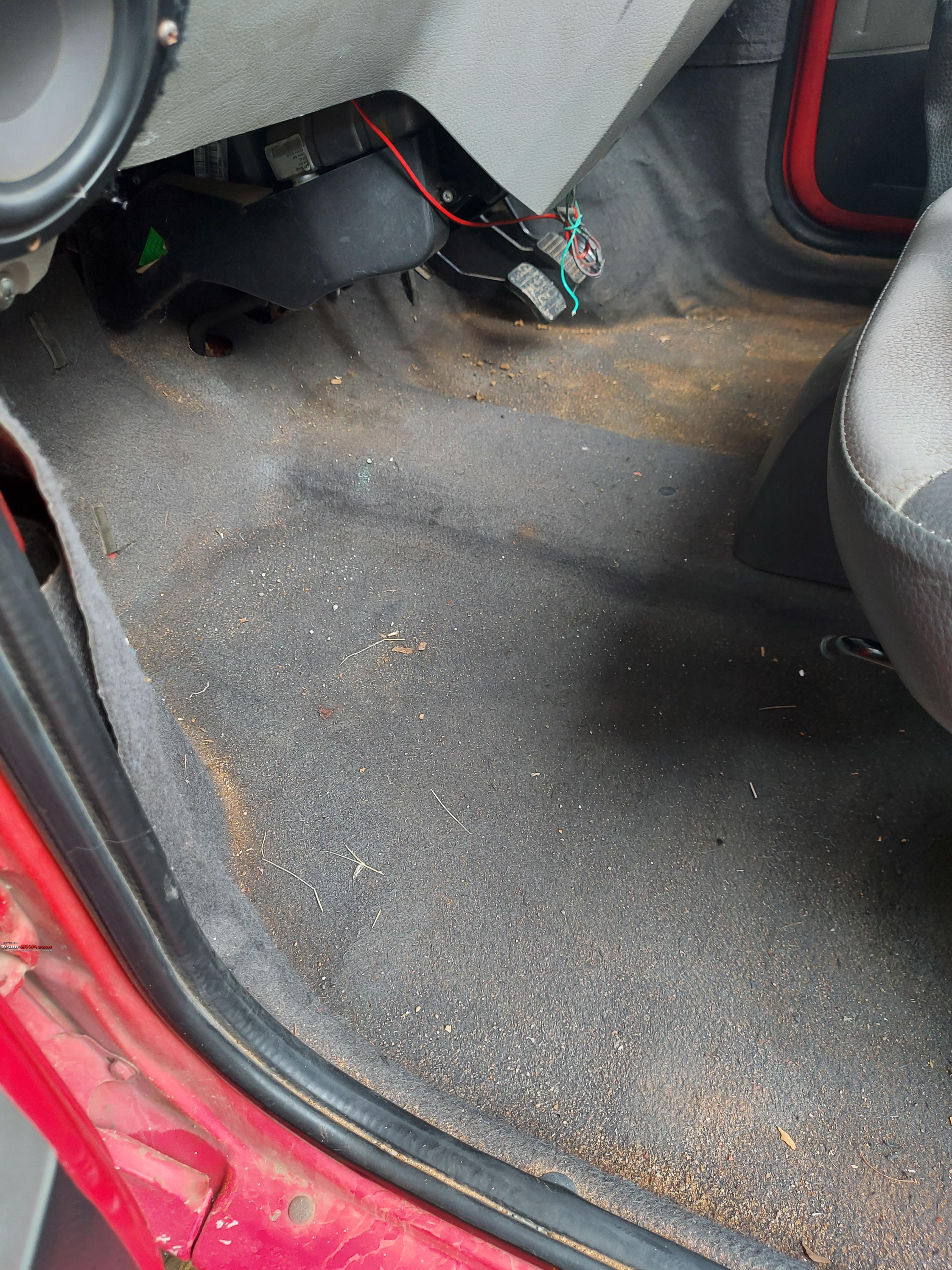

Floor Cleaning
It appears that the old battery had leaked big time and that had caused a lot of sulfation on the floor beneath. It took me 2 hours and a lot of concentrated detergent solution to clean the area up.
The dirty floor
Experiences with a 2011 Tata Nano CX – The James Bond Car-nano_batterysulphation.jpg
Experiences with a 2011 Tata Nano CX – The James Bond Car-nano_driverfootwellbefore.jpg
Experiences with a 2011 Tata Nano CX – The James Bond Car-nano_frontfootwellbefore.jpg

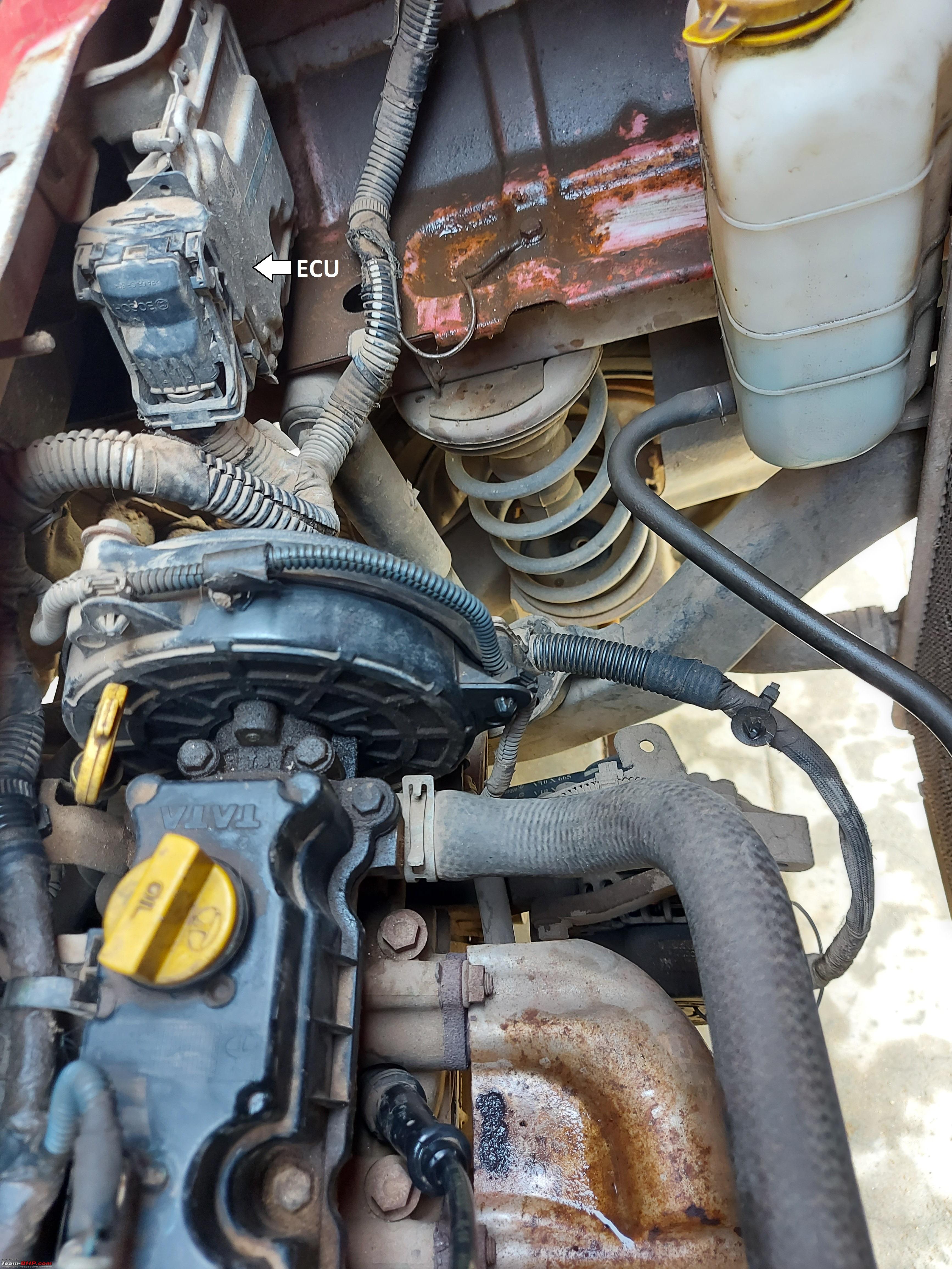

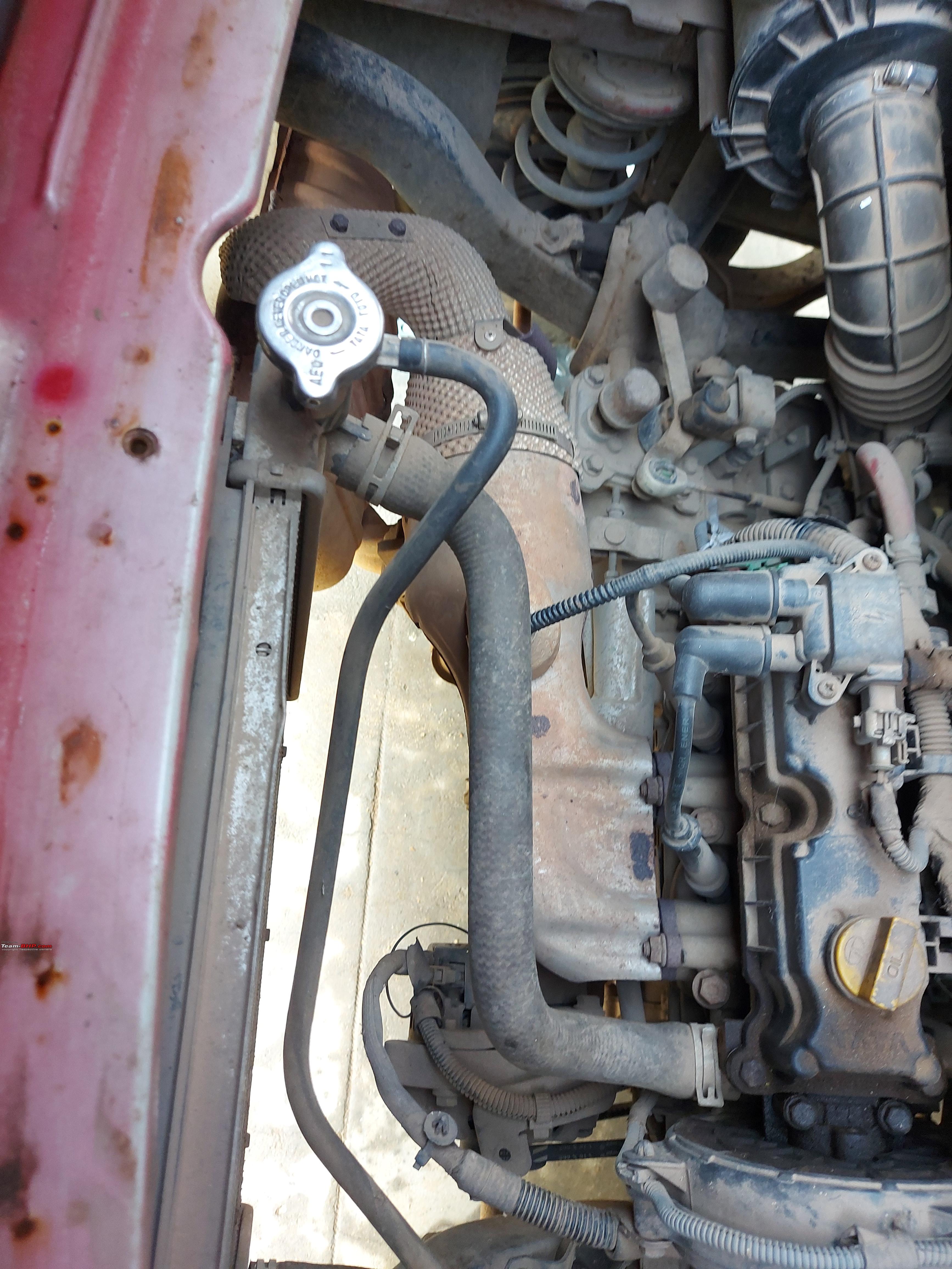

Engine Bay Inspection
The engine in the Nano is behind the rear seat. To access the engine, I had to pull two straps to unbuckle the rear seat from its strikers, pull the insulation off the top of the engine cover, and then open six wing nuts to remove the engine cover. This is the most painful part in the Nano – opening the bonnet in any other car would take just 10 seconds, while in the Nano it takes a cool 10 minutes and a lot of calories. Phew !!!
I did not want to get the engine bay washed at a service station and therefore just inspected the engine and did some basic cleaning with a damp cloth.
1. The alternator belt was a tad loose. Used a 12mm ring spanner, opened the belt adjustment bolt, moved the alternator a bit back and tightened the bolt back again. There is no belt tensioner on this car.
2. Coolant was good, and so was its level in the expansion tank.
3. Engine oil was clean.
4. Spark plug wires were in good shape.
5. Replaced the radiator cap as the rubber in the old one had expanded causing resistance to movement of the spring loaded mechanism.

Engine bay before cleaning
Engine bay after preliminary basic cleaning
Experiences with a 2011 Tata Nano CX – The James Bond Car-nano_enginebayaftercleaning.jpg
Experiences with a 2011 Tata Nano CX – The James Bond Car-nano_enigneaftercleaning1.jpg

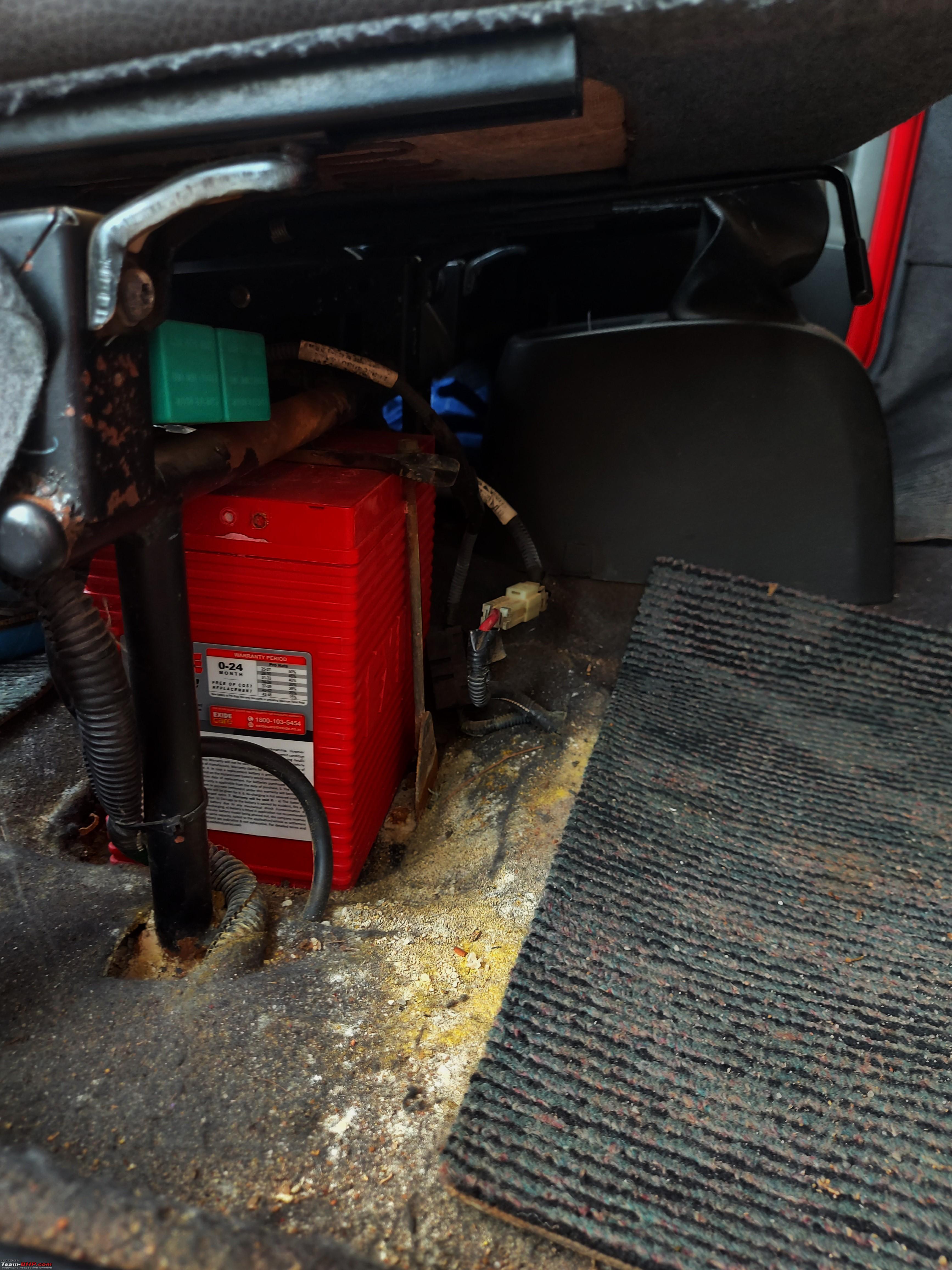

Missing a Heartbeat
I set off for Madurai from Trichy at approx. 6:45am one day, got a phone call some 10 minutes out on the highway and so pulled over to take the call. After completing the conversation, I switched on the ignition only to see lights on the dash flickering and relays chattering. I switched off the ignition and switched it on to see the same thing happening.
From past experience, I knew this was happening because the power supply wasn’t good, and all I did was check the battery cables and found the negative cable connection a little loose; just tightened it and the car fired up without fuss. This improper connection was thanks to the unprofessionalism of the battery guy who must have found installing the battery below the seat a harrowing experience, and therefore decided to just shove the negative cable in without tightening.
The battery fitted in the Nano was an Exide 38B20R (35Ah) while the OE spec is 25Ah. The bigger battery is an extremely tight fit under the seat and results in the fixed clamp towards the front becoming useless. Note in the image how the front fixed clamp is fitted.
38B20R battery is a tight fit

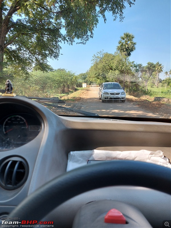

On the Trichy - Madurai sector, I decided to attempt bypassing the two toll plazas viz. Boothakudi (Viralimalai) and Kaththappatti (Melur) to see what it would mean w.r.t extra time and kms spent. The first toll bypass (Viralimalai) was a net 5.5km detour and 14 minutes extra while the second (Melur) toll bypass was just a net 3 km detour and 10 minutes, plus it gave me the opportunity to see some core countryside and also pass through the units of TVS Srichakra Tyres Limited. I bypassed the tolls again on the return leg (Madurai - Trichy).
Is a toll plaza bypass worth it? Yes, if the detour is no more than net 4 kms, if the route is free of thorny bushes on the sides and if it is not raining.
Bypassing Toll Plaza#1 - 14 minutes detour
Experiences with a 2011 Tata Nano CX – The James Bond Car-boothakuditoll_bypass1.jpg
Experiences with a 2011 Tata Nano CX – The James Bond Car-nano_countryside2.jpg
Experiences with a 2011 Tata Nano CX – The James Bond Car-boothakuditoll_bypass2.jpg

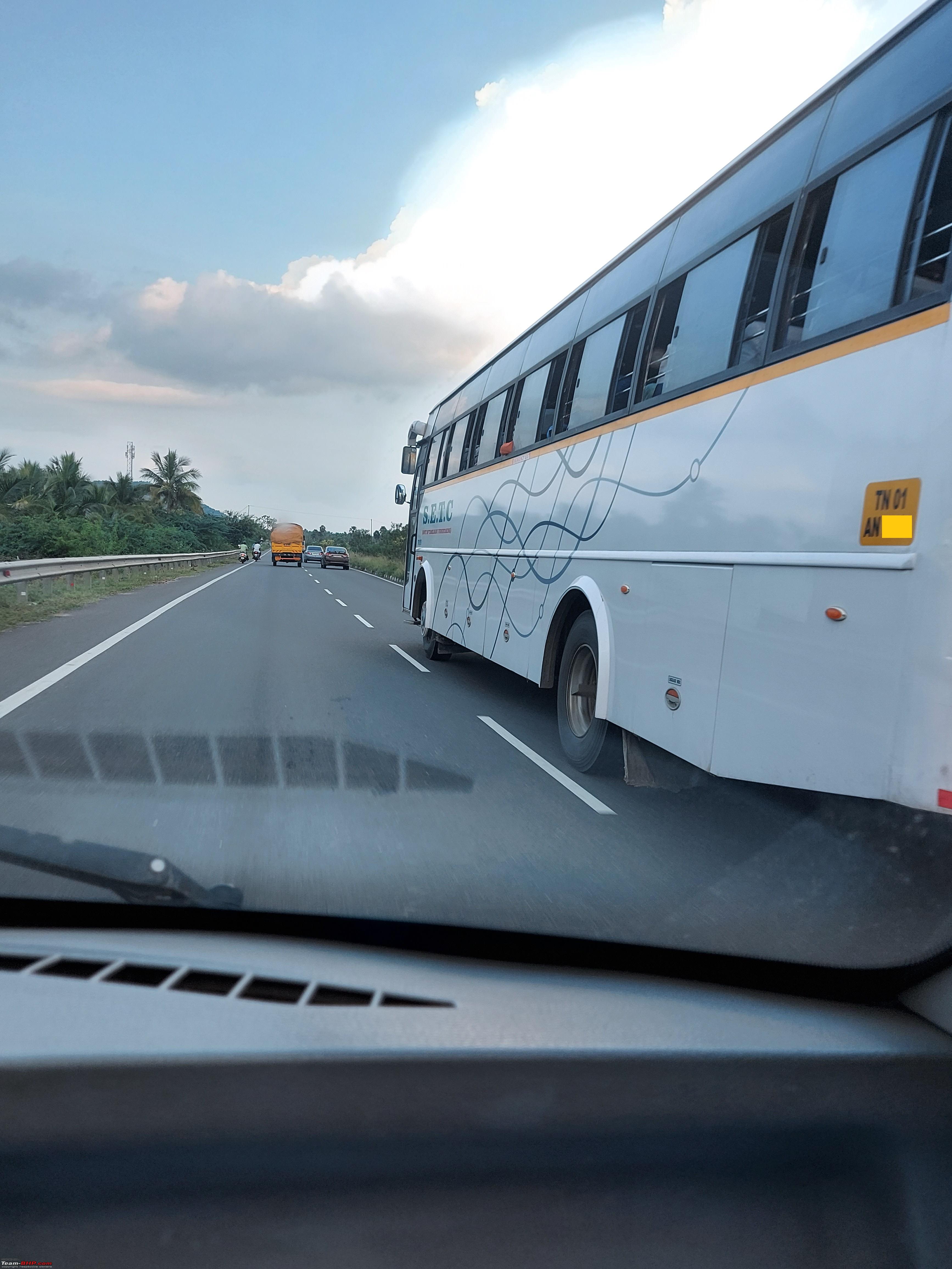

Overtaking an SETC Ultra Deluxe - all STC drivers have been instructed to save fuel by driving at 75kmph max.
Experiences with a 2011 Tata Nano CX – The James Bond Car-nano_overtakingsetc.jpg
Experiences with a 2011 Tata Nano CX – The James Bond Car-nano_overtakingsetc2.jpg

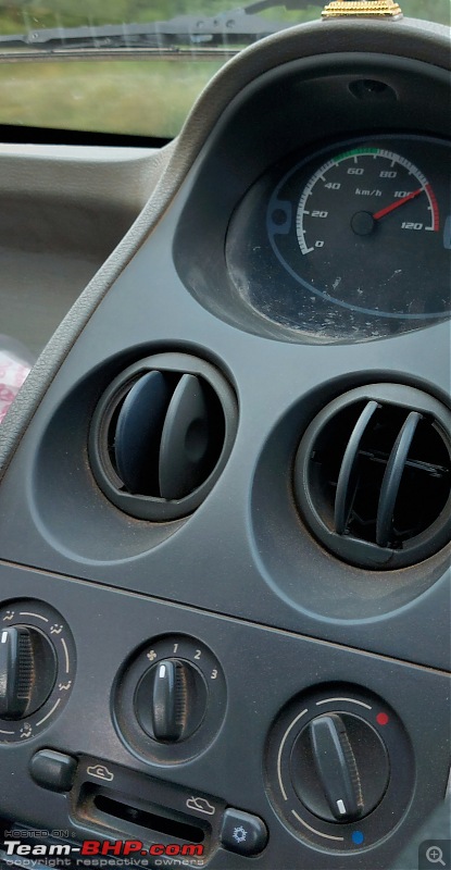

Cruising at 85kmph towards Madurai
Experiences with a 2011 Tata Nano CX – The James Bond Car-nano_cruising85kmph.jpg
