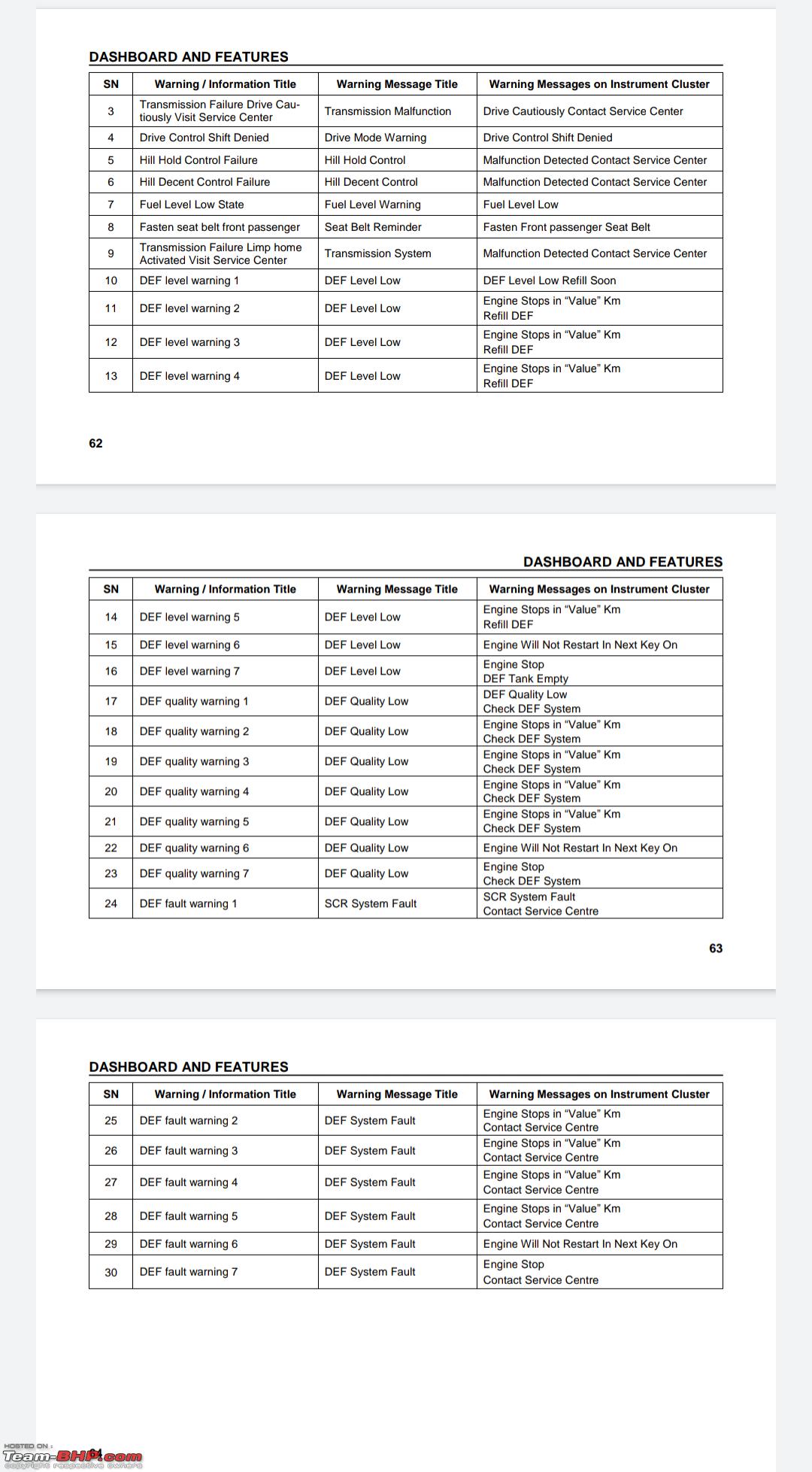

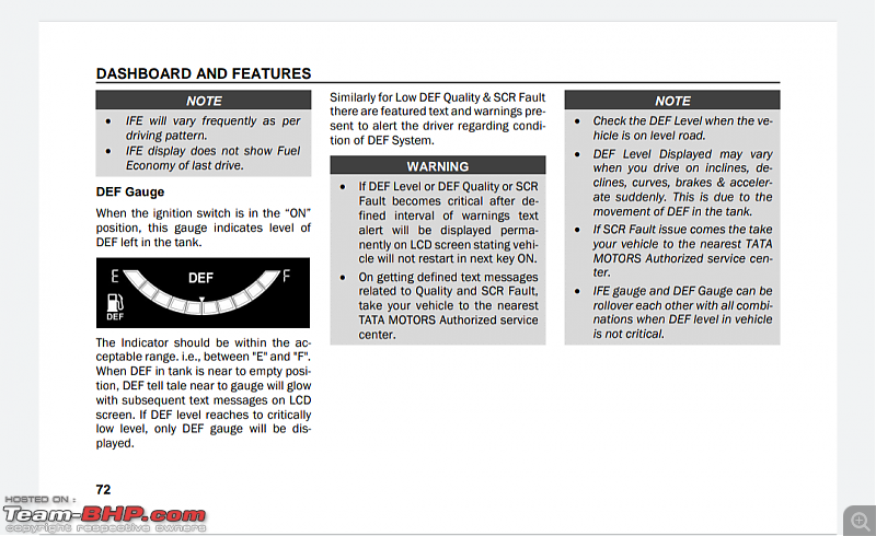

Originally Posted by sinharishi View Post
First car started loosing power, then the F light came up on the MID. He drove the car back home after restarting it and spoke to TATA SC.
Car has clocked 2,000 KMs since then, no issues whatsoever.
Was the "F" light related to DEF fluid? There are a number of warnings mentioned in the owners manual regarding that, even for a low quality DEF fluid!
