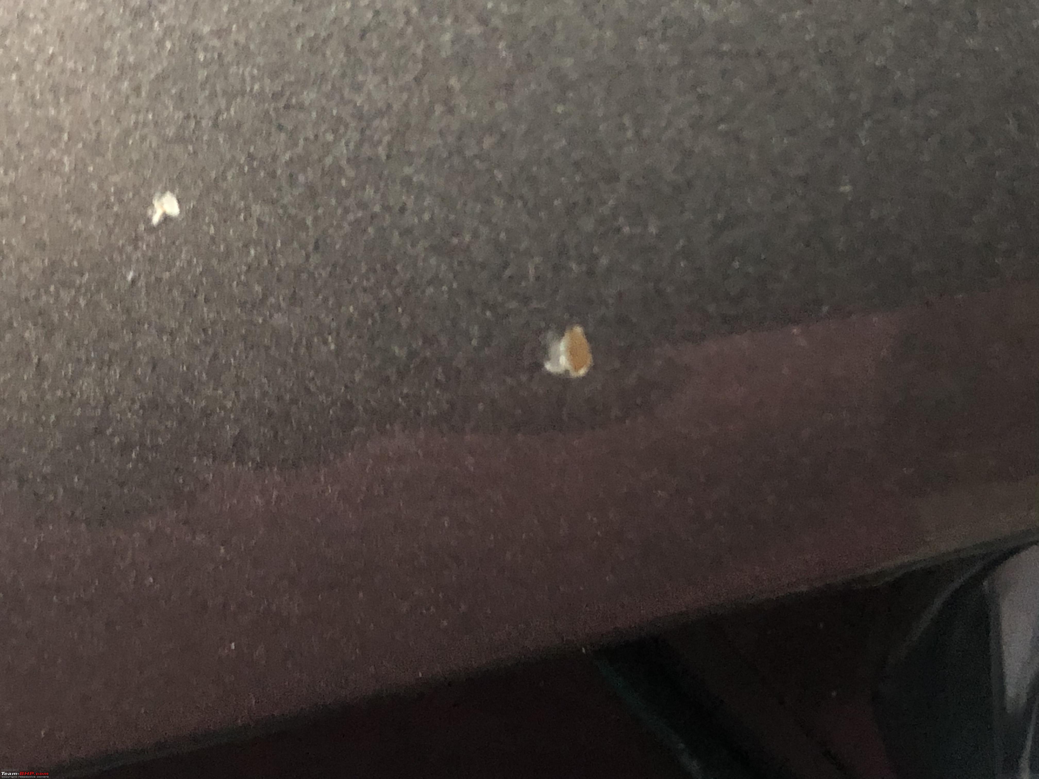

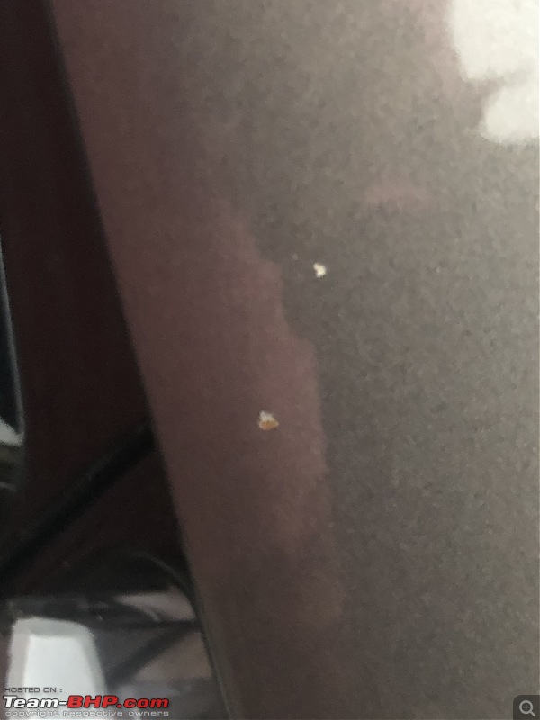

This is paint chipped from my bonnet . Is it due to stone or due to paint issues . Kindly let me know how to solve this ?

The way it has chipped, it looks like it was caused by stones; especially since it’s at the leading edge of the bonnet.
You can get the touch up paint pen or spray paint from Com-paint for specific cars and colours. I don’t usually recommend them for larger areas but I think they’d do fine on these spots.

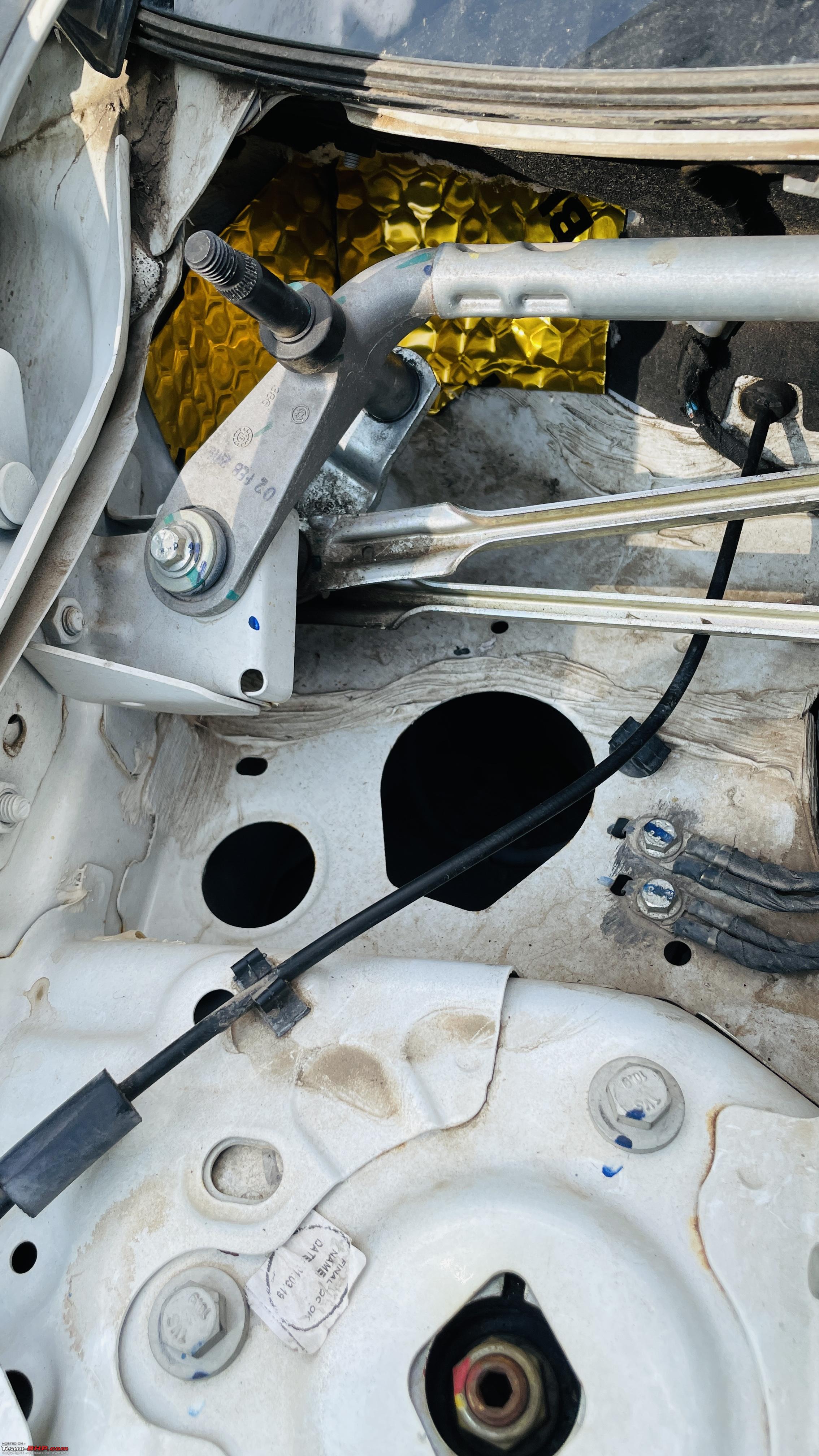

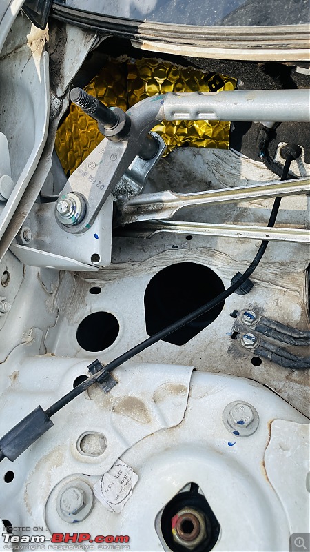

The vehicle was pretty much niggle free since the previous service but I noticed that the NVH had increased over the period due to the insulation being nibbled away by the rats.
I enquired with the nearest Tata service if they could install a rat mesh or have the insulation replaced/repaired but they did not have any such offerings.
I decided to add sound damping sheets to seal all the damaged areas and block all rat entry points.
To my surprise, there is a rather large entrance from the wheel well into the ECU/Harness bay and this is where these rodents have been entering my vehicle from. I still can't fathom why these aren't sealed away by the manufacturer.
During the previous repairs they had not added any sleeves nor insulation to the wiring and I noticed a few cut wires (No warnings or obvious malfunction component yet).
If you have rodents where you park your car, please ensure you get these entrances sealed to avoid any major repairs ( I have already replaced the wiring and high pressure clutch cable once).
