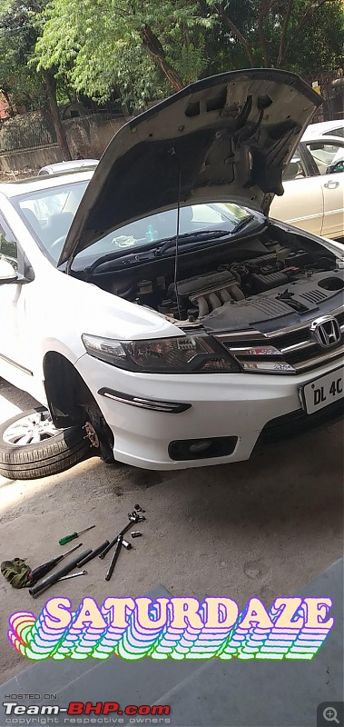

I bought a pre-owned Honda City 2013 V-MT Sunroof for my personal use.
The car has covered 8,000km with me since I purchased it in April 2019. She sees a low mileage as is mostly driven within the city with the occasional (once a year) trip to Faizabad, Uttar Pradesh.
The car’s suspension makes a weird sound at low speeds that no mechanic can quite diagnose and it triggered my OCD ever since the purchase and the first thing I did was to take her to our Mechanic who has worked on our previous cars and dad’s current but I’m not too fond of his work.
Work done;
April 2019
Basic Service done
In July of 2019, I was tired of the slight khat khat sound from the right side of the suspension when driven be it on smooth roads or potholed. The sound becomes fainter as the speed increases but remains until about 100km/h.
I tried to drown the noise by increasing the volume of the songs but I could still hear it.
Both the front shockers were replaced along with the mounting. (Gabriel Make)
Tie rod I think was replaced
Ball joint (some steering thing that has a rubber center and balls at the end) was tightened or something because the mechanic said it has developed play and is looser than should be.
Discs were skimmed
Brake pads were replaced (Bosch)
Problem
The noise from the right side persisted so this smart guy took the car for another spin and tried to see the issue from the right side but couldn’t so I took the car back and waved him and never went back.
Took the car to Honda, Okhla and the mechanic said the Shockers and mounting are to be replaced.
Told him they were already replaced and he said it’s the link rod.
Left Honda and came to a workshop (the guy is knowledgeable about cars and is good at his work) and he has carried out a lot of work ranging from fog lamp change to mirror repair and replacement and painting.
The mechanic Imran, is now my trusted go to for anything car related and he suggested link rod and ‘chimta’ but I haven’t gotten around to getting that done.
The problem is that there’s another sound from the suspension when it’s cold outside and makes an annoying sound when going over speed breakers or in potholes. Video attached.
My current mechanic said the shockers have become hard but I fail to understand how that can happen with new shocks (the sound used to come during last winters as well).
A few other queries
1. There are lights installed in the front footwell (LED strip) but are wired someway that when the car is unlocked, they come on and then when the ignition is switched on, go off. They also stay on when the car is switched off until the car is locked again. If I wish to get this changed with other strips that come with a remote, how do I see where the wiring is gone?
2. Front LHS and Rear RHS Speakers are not functioning so what are my options because I feel like it might just be a connection issue but the whole door will have to be stripped apart.
3. The mirror adjustment is weird; The mirrors are not able to adjust fully and the right hand side mirror moves up simultaneously when I try to move right and down when moved left and same with left. The issue is said to be the switch for the right one and cable issue for the left one. Is the diagnosis correct?
Any help would be greatly appreciated.
