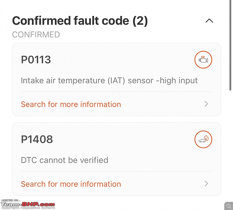

Originally Posted by Sonali Singh View Post
Anyone faced this (OBD lamp alert with no loss of power + disappearing on its own) before? Could it simply be quality of diesel (gauge is nearing empty now and I had gone to a new fuel station the last time).
Same thing happened to me a couple of times when the fuel was in the last 30%. I have attached the codes, I request you to get the error codes checked and please share.
The OBD lamp turns itself off after three starts (if the error is not recurring in the next three runs, the lamp stops glowing).
FYI my ECM was also changed recently when my vehicle moved into limp mode in December.
Coincidently my vehicle is also June 2021 Manual Diesel

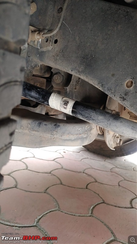

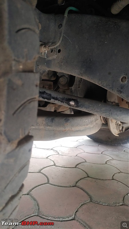

Hi,
I recently noticed that the left tire of my thar is rubbing on the sway bar. My vehicle is Feb 2021 model. Did anyone experienced the same with their Thars ?
. Its only happening with the left tire and also when I make a U-turn from standstill, it feels like the front 2 tires are dragging on the road surface.
Suggestions are much appreciated.
2nd-gen Mahindra Thar | Niggles, Problems & Solutions-whatsapp-image-20230505-1.15.19-am-1.jpeg
2nd-gen Mahindra Thar | Niggles, Problems & Solutions-whatsapp-image-20230505-1.15.19-am.jpeg

Originally Posted by Udayajit View Post
Hi,
Ask any tyre aligner to do your steering bump stops. 2 min fix.
Tried getting the wheel alignment done from mahindra authorised service center and from outside. The alignment figures are in range also i couldnt find any steering bump stops on my Thar .
