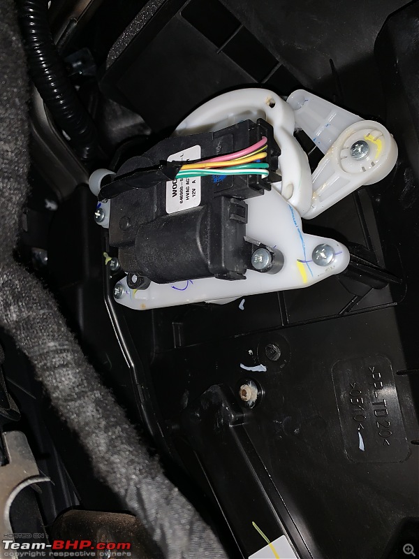

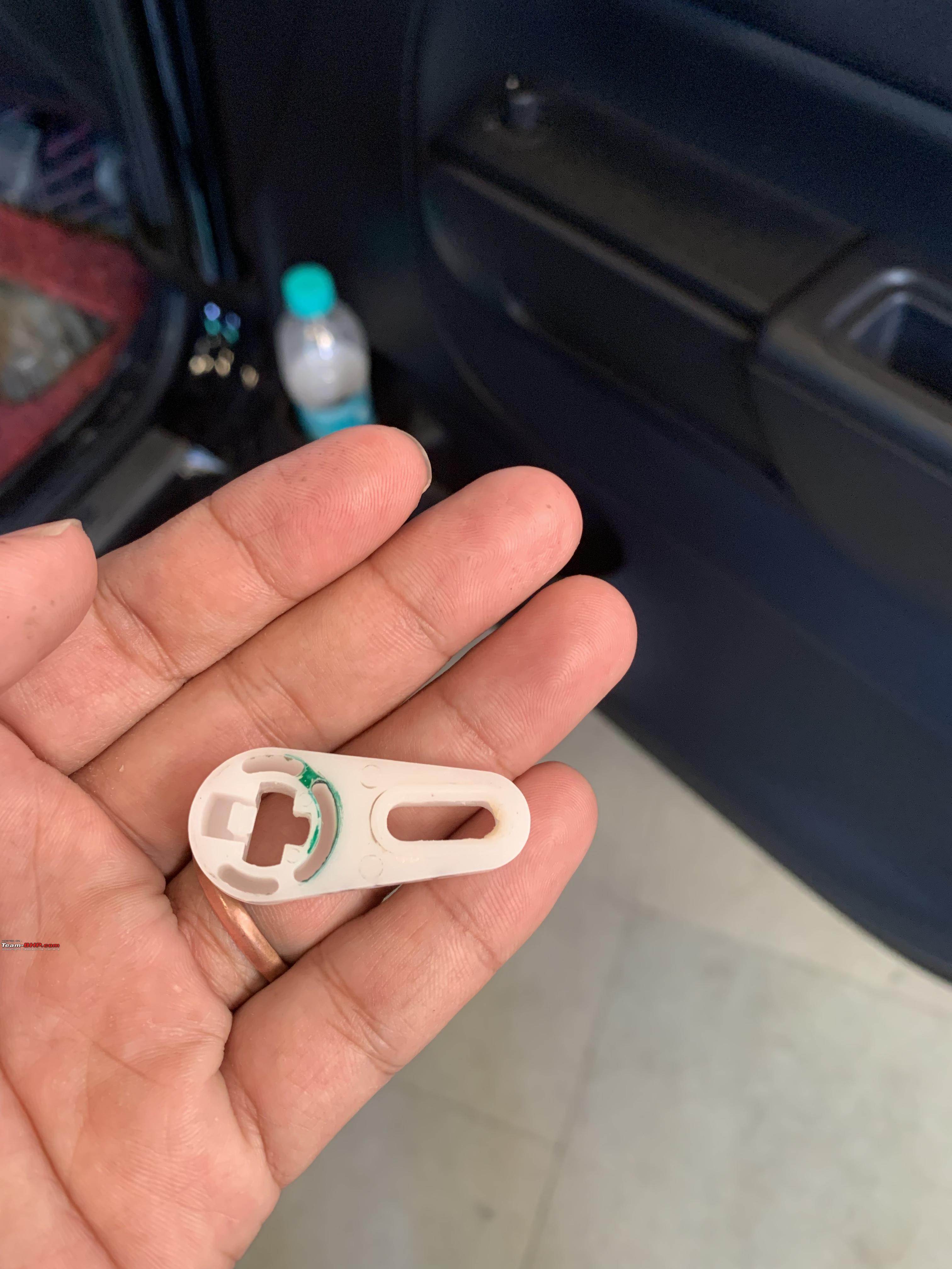

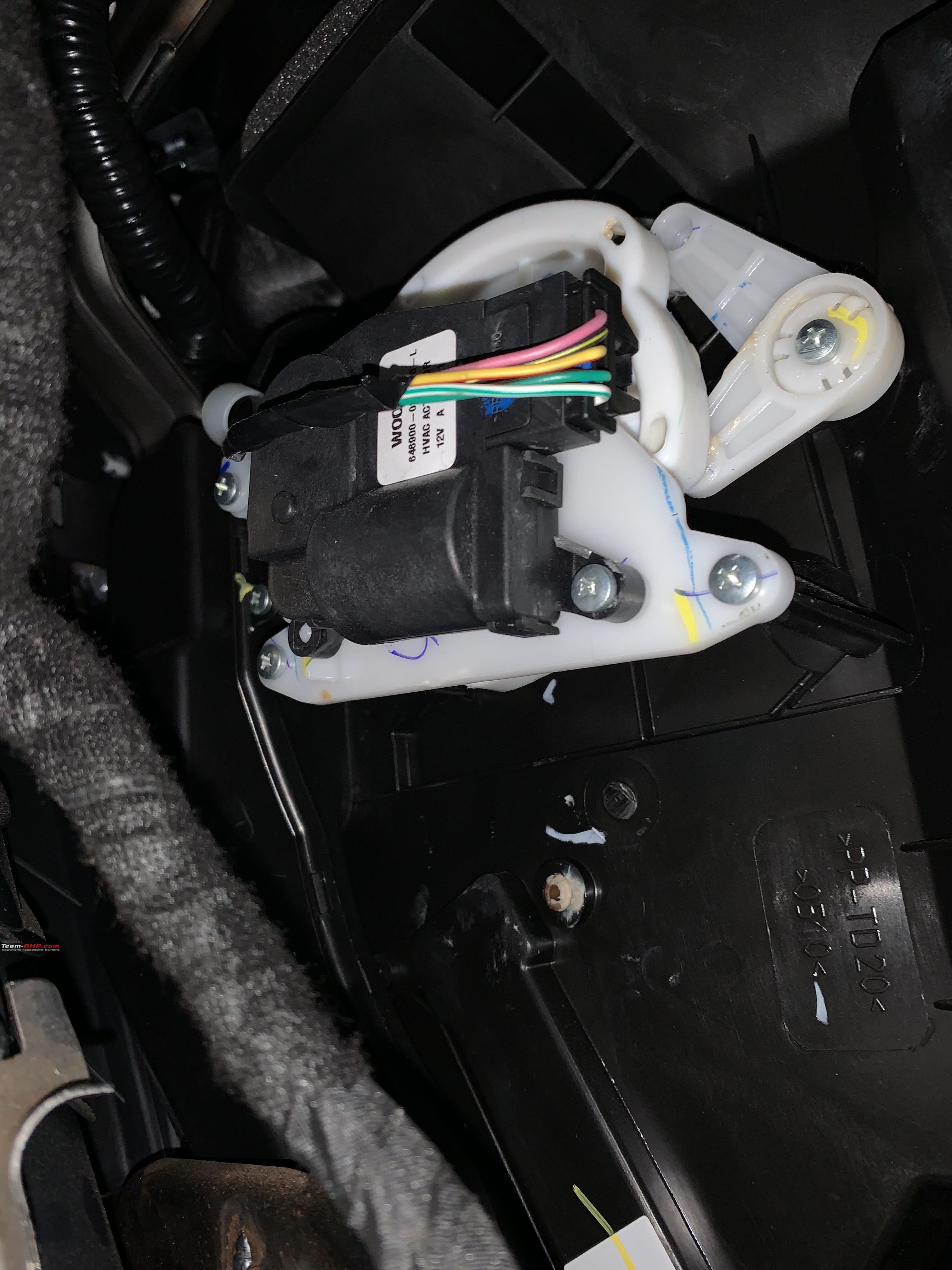

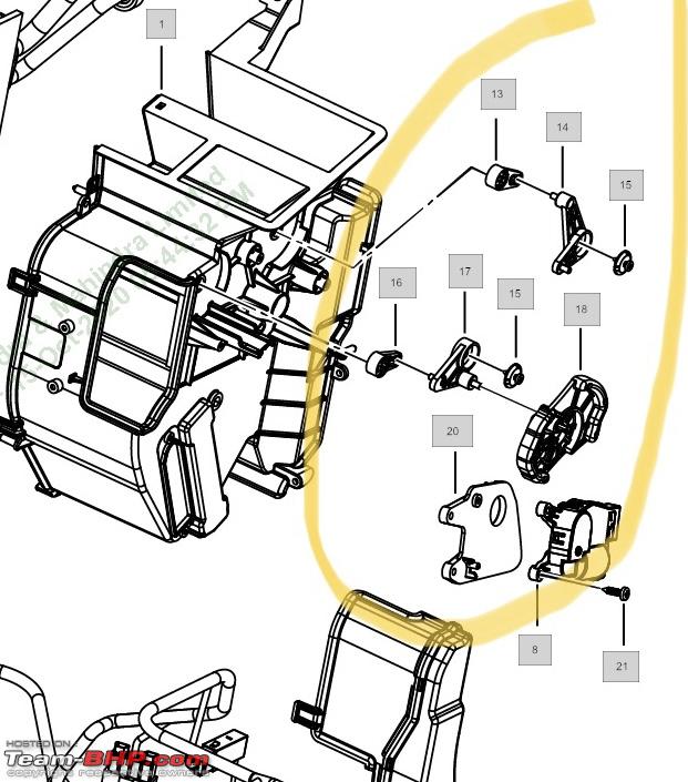

Hi I too have similar problem, and checked with ASC twice, during my first visit that was after my first service, the ASC shrugged it off as “AC is very powerful and small leakages from defrosting vent is common that is why the problem, common for all thars”. I was sold to their justification.. later on after reading about the issue here (team-bhp)I was convinced that it is a manufacturing defect not only limited to my Thar but maybe the whole lot. I then called up the Customercare, wrote mails about the issue and lodged a complaint. After that I received phone calls from ASC asking me to bring my Thar to them. Before I visited I made some videos of the issue and shared it with the service manager so that he can cross check with other Thars in the dealership yard and look for solutions beforehand ( which they never did). So I took my vehicle today 20/09/2021 to the ASC, the service manger patched me up with their Technical Manager and he inspected the vehicle in my presence, I showed him that when blower is set only to foot position, the leakage from defrosting vent increases. Thereafter we cross checked with a new Thar ( Diesel AT) without head unit in the yard and it too had same issues. The Technical Manager was smart and he escalated the problem to the plant by sending the VIN no. of both vehicles. He was instructed to focus on customer’s vehicle. Later on the plant raised the issue with equipment supplier in Kolkata.
Finally Diagnosis & Solution
The supplier informed that the problem is with the hinge which controls the movement of the flaps and to rectify the issue, the hinge needs to be replaced.
Within 30 mins the Technical Manager received the SOP ( how to & what to replace with pictures) in pdf format in his WhatsApp.
Sad part is I have to wait for some days as the hinges are not in stock and are being couriered.
Hi, first of all my apologies for the delay in posting an update about the issue.
The hinges arrived within 5 days in the ASC Mahindra Tezpur, Assam but I visited the ASC on the 28th of September 2021. On reaching the ASC, the Technical and Service managers greeted me warmly and took in my vehicles immediately. The Tech. Manager handed over the hinge to a technician and asked him to replace it. With only the fuse cover and lower part of steering column cover to be removed, it was done in 15 mins.2nd-gen Mahindra Thar | Niggles, Problems & Solutions-0b68bde35487441e909a7b9dd58618a6.jpeg2nd-gen Mahindra Thar | Niggles, Problems & Solutions-44df57cc506b4c0d8055f3d8f0759ab3.jpeg
We checked for the issue with the part replaced.
Observations
1.) with blower setting set to front only or front and foot, the leakage is negligible.
2nd-gen Mahindra Thar | Niggles, Problems & Solutions-5be3bf9289c745d7831ad4f815e71ea1.jpeg
2nd-gen Mahindra Thar | Niggles, Problems & Solutions-4e9845b1a74747f5a80ff60fd20a8cff.jpeg
2.) with blower setting set to foot only, there is still considerable leakage of air from the defogging vents located on top of dashboard.
2nd-gen Mahindra Thar | Niggles, Problems & Solutions-b552616024e24540bdf0ba42eac10829.jpeg
ASC response to observations
The Technical manager called the concerned people in Mahindra and reported that the problem is not resolved with the part changed. He was then told that the pressure of air leaking has been reduced from 4.3psi to about 2 psi with the hinge changed and everything else is as per plan and design ( observation 2 too).
Conclusion
As per my experience after the hinge change, I have not yet observed any fogging with my blower setting set to front and temp. set even to the coldest . However I am in doubt if observation 2 is by design. I also observed that the tech. manager had a manual for how the AC should be operated in Thar to avoid fogging. I had asked for the pdf of both files(sop for replacing hinge and the manual) from him but was refused stating that he is not allowed to share with customers and it is only meant for ASC people.
I do believe that the stalwarts of Team-bhp are in a better position to confirm if observation 2 is by design or a flaw which Mahindra is not willing to accept and cover up

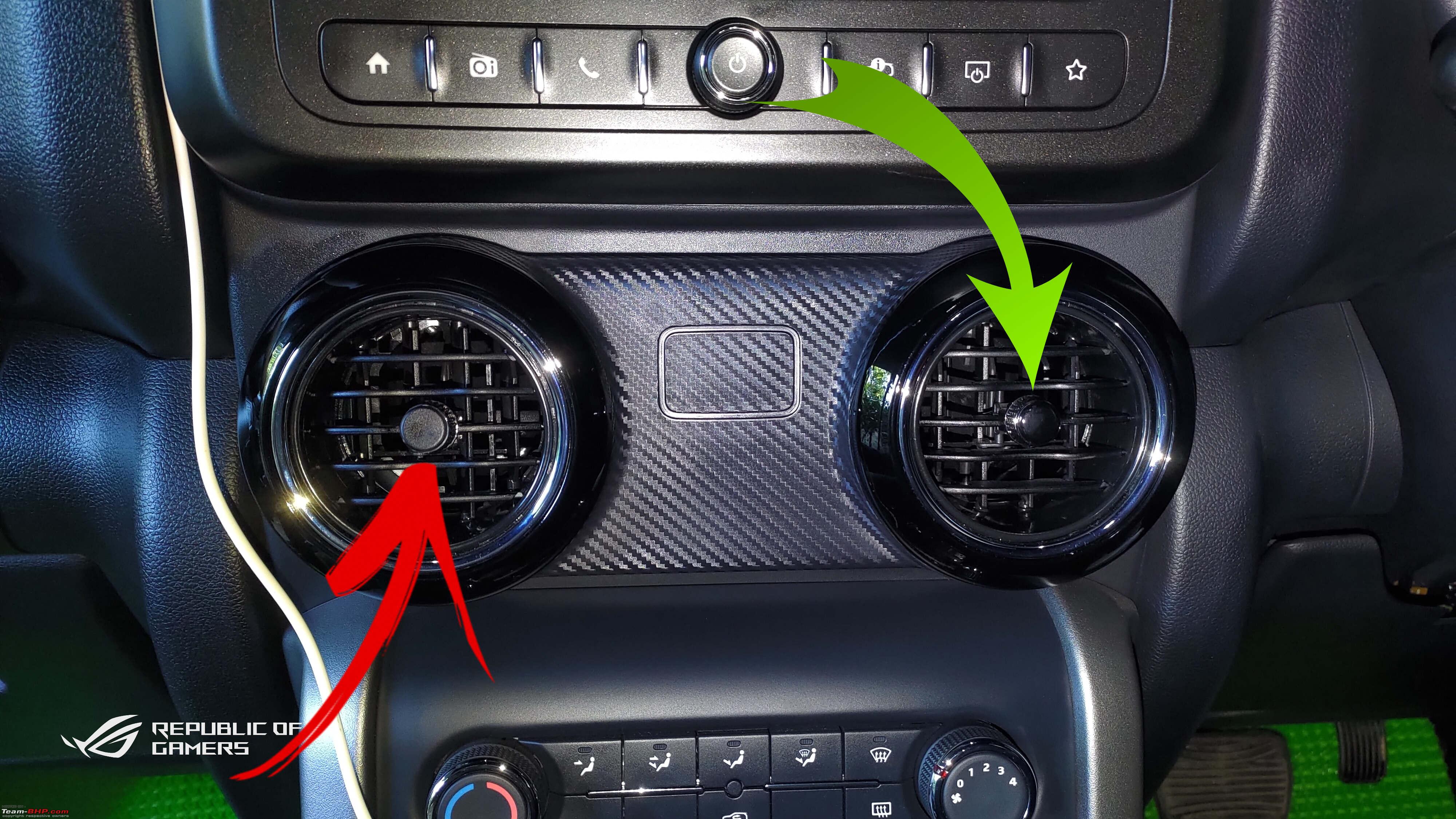

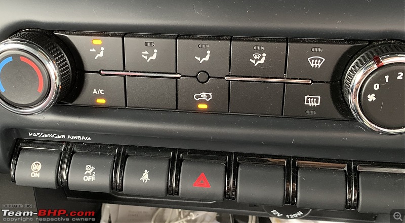

Took delivery of my Thar Diesel LX AT HT recently.
I did not drive the Thar from showroom to my home, instead I followed it with my Ecosport AT.
Next morning I noticed the glossy black cap on the knob present at the center of the AC air vent (Central air vent) is missing from the passenger side central airvent. Might have fallen off.
The image with the red arrow is my DIY jugaad of the black tip/cap (Note the matte finish), whereas the one pointed with the green arrow is the normal glossy tip/cap of the AC knob.
Btw the black tip was salvaged from a airdam clip of Maruti Suzuki Celerio. Just cut off the stem and glued the cap on the AC central knob. Not perfect by any means, but atleast not an eyesore for now.
Extremely sorry for the image quality and the lack of before and after images. I forgot to click picture of the knob before covering it up
Yes, the AC vent could be replaced at the service center, but I don't want any invasive procedure done on my brand new car. I saw the infotainment system installation where the Mahindra accessories guy used a flat head screw driver instead of a plastic pry tool. Anyways, the AC vent is not in stock, neither it is available in m2all or boodmo.
I will rather DIY replace my AC vents with Mercedes AMG styled AC vents from the aftermarket. The stock AC vents knob is very flimsy.
Another thing I noticed is free play on my brake pedal. 3-4mm of free play is present. And free play is pretty loose. 2-3 mm of free play is also present on my Ecosport AT, but the pedal still feels a bit stiff compared to my Thar.
Don't know if its normal or not. Will have to take the Thar out for a longer drive session to check it out

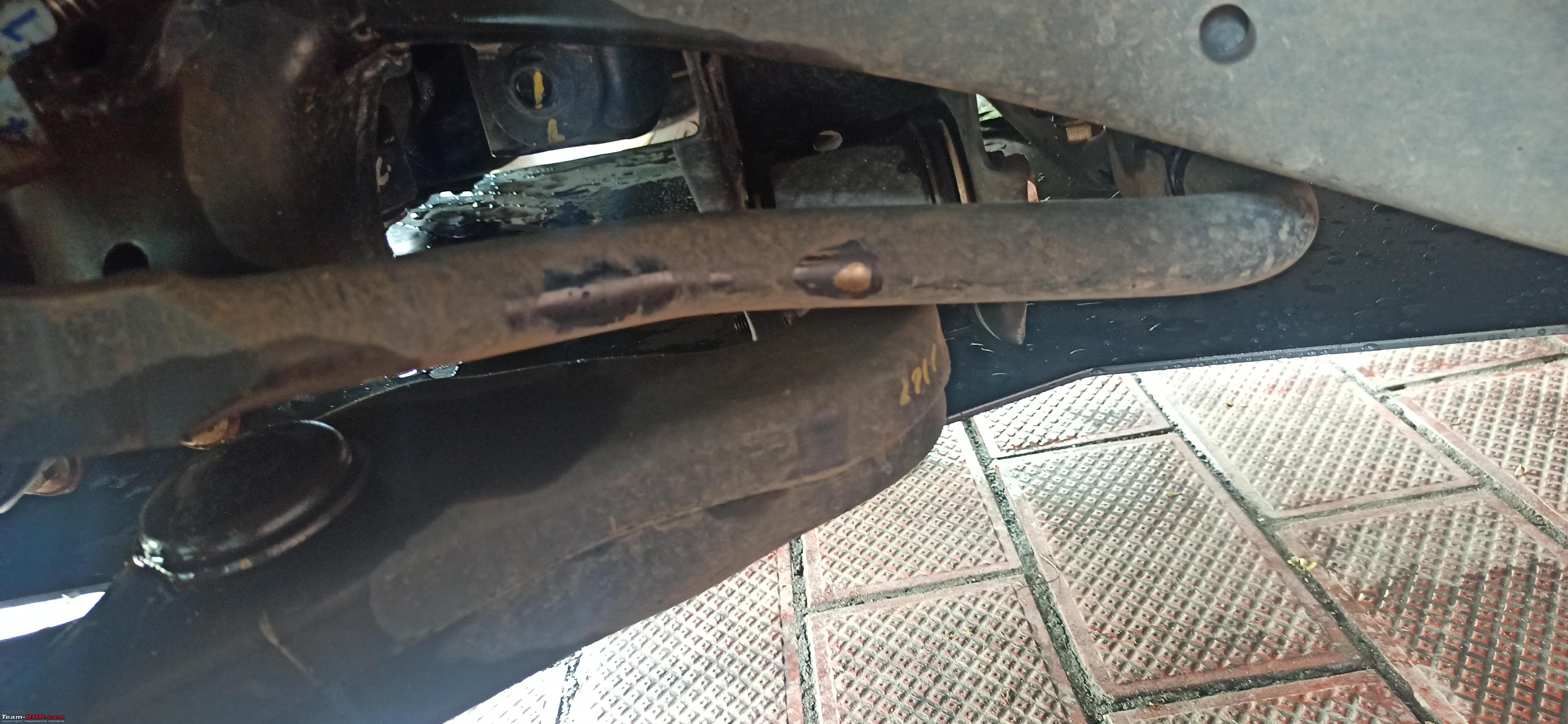

2. Tyre Rubbing against suspension stabilizer bar
Recently noticed this issue and taken to service center. They told its resolved. But I am yet to check out this extensively. Seems this too is a design issue with the Thar as many other owners are also facing this issue but many might not have noticed. This is also another serious issue which will lead to excessive wear out of tyre.
